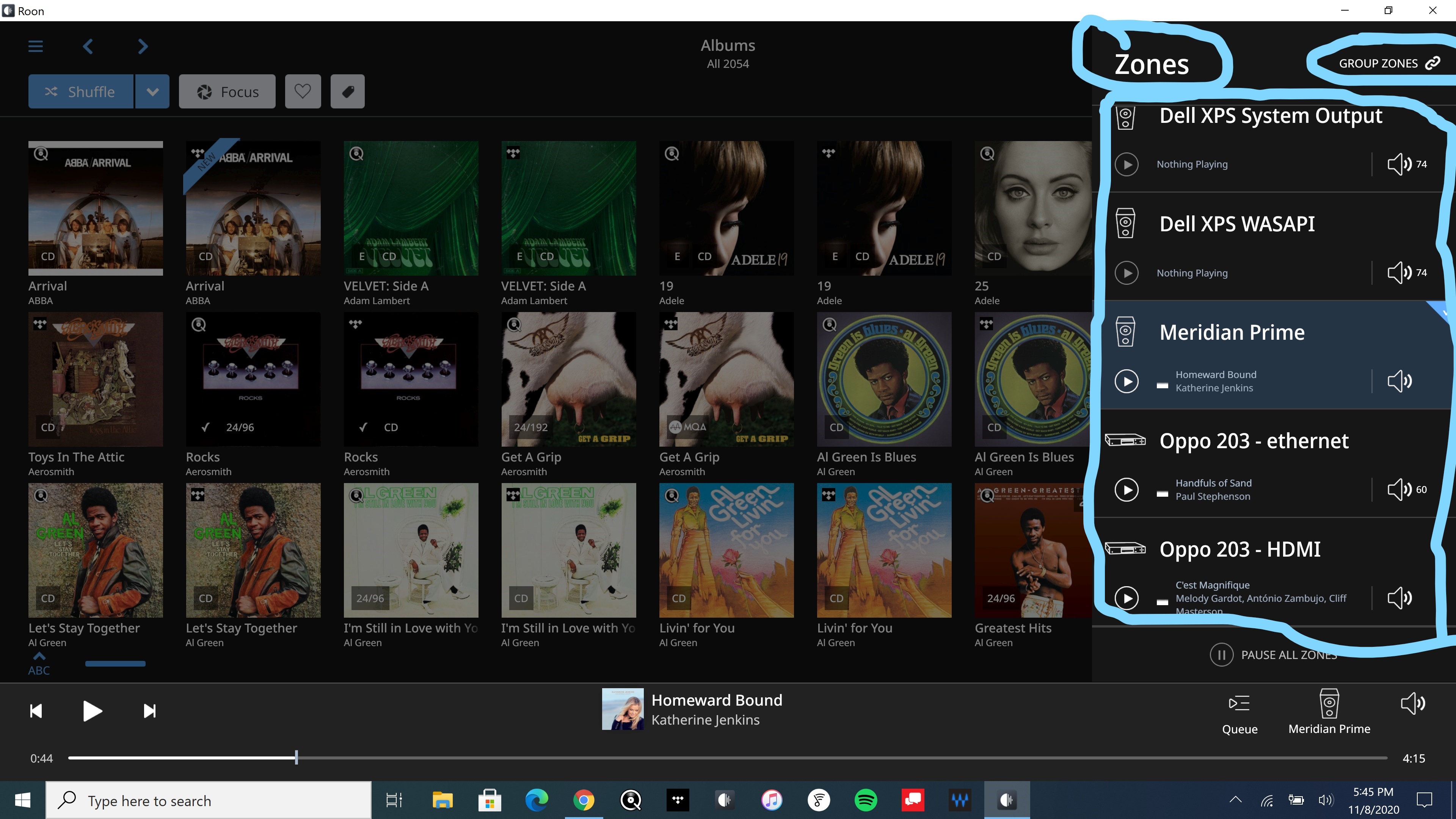

Choose output device (zone) by clicking in lower right corner…There, you will see all that you have enabled in Roon - Settings - Audio
Thanks, Jim - I can see that…
Like this - Yes:
How do I actually switch from one device to another, though?
Are Devices synonymous with Zones?!
And - without SoundSource - what is the relationship with/role of macOS’ Sound > Output System Preferences and Roon’s Devices(/Zones), please?
Still not clear whether to use ‘Built in-’ or ‘System-’ output…
While something is playing, you can shift output from one device (zone) to another:
If you’re not playing anything, just choose the output (zone) you want to use. Click it.

I don’t know the answers to some of your questions. You need to go to Roon - Settings - Audio and enable any of your devices (zones) that you want to use. Basically, they are all the possible output devices that Roon is seeing, but each one needs to be enabled to be used as an output device.
Then, you can choose which device you want to play music to by clicking on the device in the lower right corner of the screen. You can play to multiple zones at the same time if you want to, but to play the same music to multiple zones, you would need to group them. That’s something I have never done.

Each device is a zone. Normally, that would be an endpoint such as a receiver or some other device with speakers attached. For me, it an Oppo feeding a Bose system or a Raspberry Pi 4 feeding a Meridian Prime headphone amp, or another RPi4 feeding a Dragonfly Cobalt, etc. My Dell laptop also shows up as several different zones that I don’t totally understand the difference, but I never use any of them.

As far as I can see, I currently have no actual zones defined as such.
Anything to be gained by at least defining one - and putting everything in it?
These are all zones. They are individual devices that I can choose to play music. If you have gone into Roon - Settings - Audio and enabled any devices, these are your zones.
I think you are confusing yourself and maybe thinking about grouping of zones. You can group like zones to play the same music to multiple zones simultaneously. You would only do that if you have end-points in other rooms of your house. I don’t.

I guess I’m a little confused that switching a device (= switching a zone) as you showed me, can result in ‘Nothing playing’ in the list of devices.
Normally, you would only play one album or track to one zone or device. You would want to see “Nothing playing” to all zones except the one you are listening to. As a matter of fact, you want to make sure nothng is playing to any other zones or you are unnecessarily using resources. When I finish listening, I make a point to ensure nothing is playing to any zones when I shut down my Roon control app. I don’t want my Nucleus streaming from Tidal or Qobuz to some zone I can’t hear all day or night.
