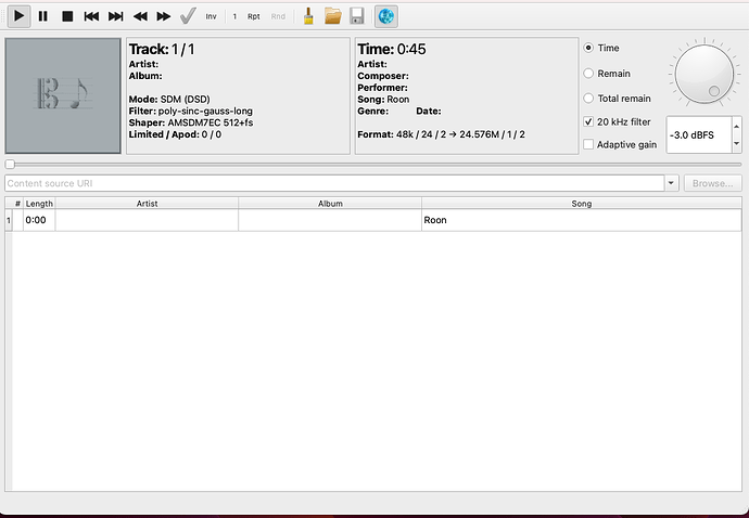

Interesting - what spec of M1 Mini? Thanks for sharing your settings - the only thing I was doing different was that I didn’t have the 20kHz filter on. Would that make any difference. Anyway, that combo is now working fine!

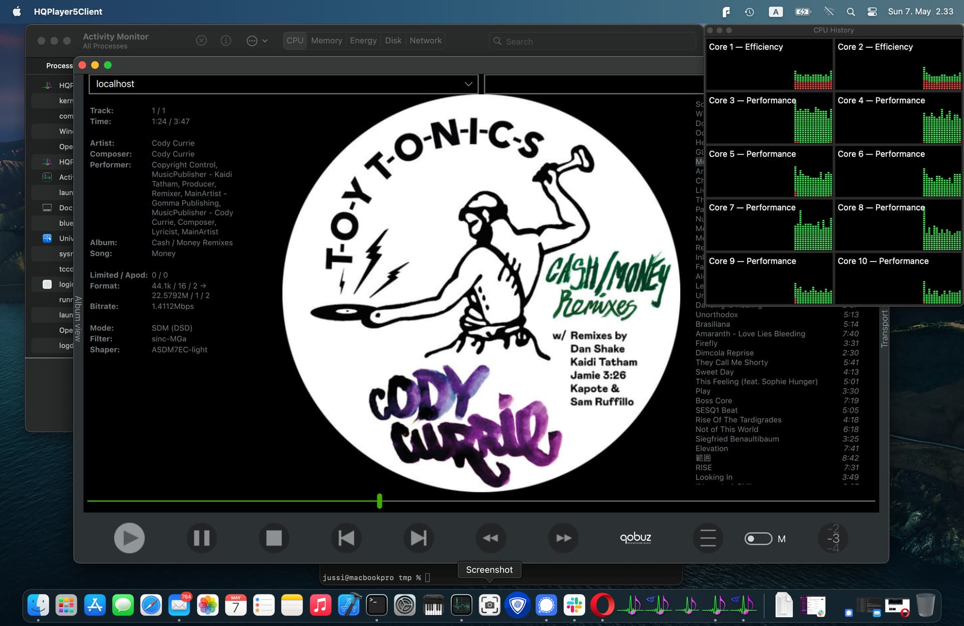

poly-sinc-gauss-long/poly-sinc-gauss-hires-lp through ASDM7EC-light 512f+fs at DSD512 works fine on my MacBook Pro (M1Max with 8 performance cores and 2 efficiency cores)
Also this works:

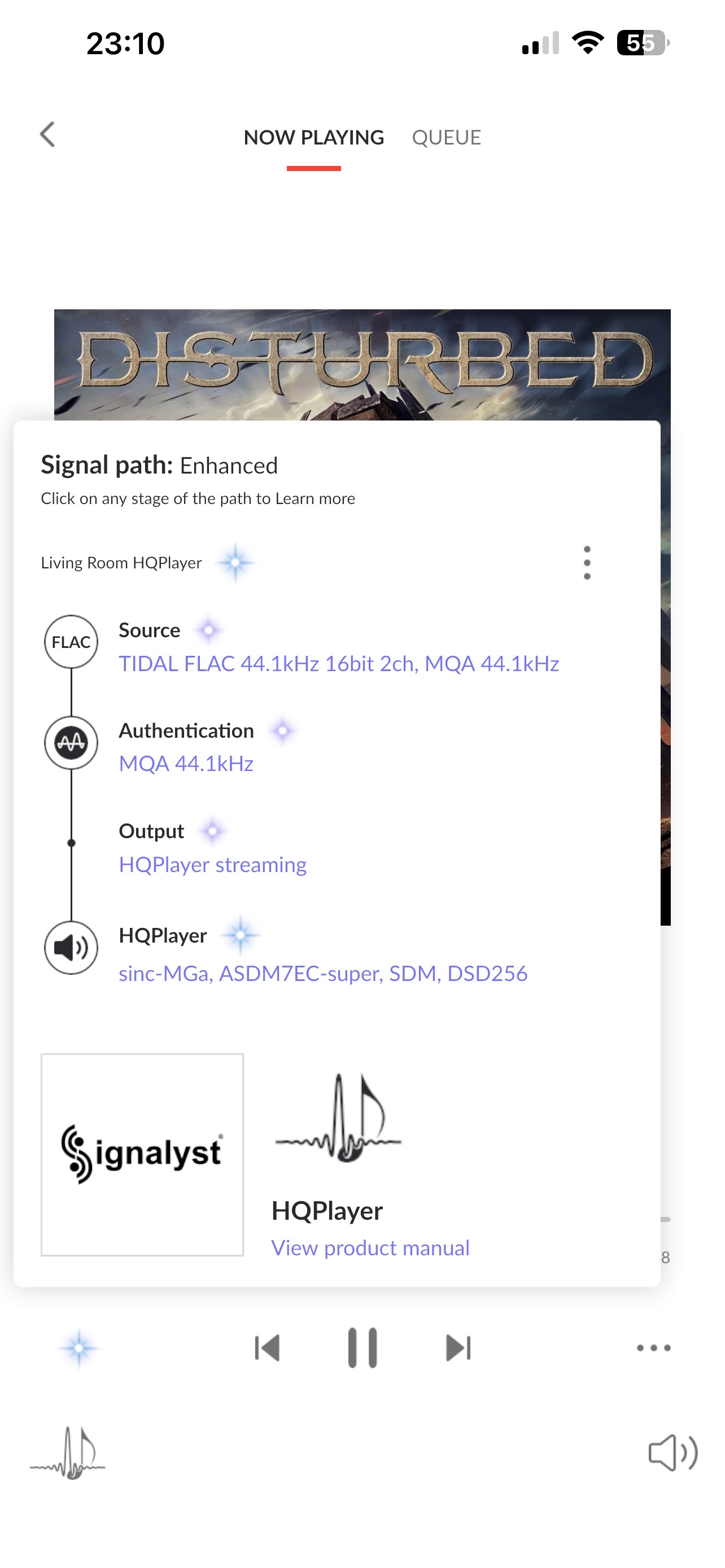

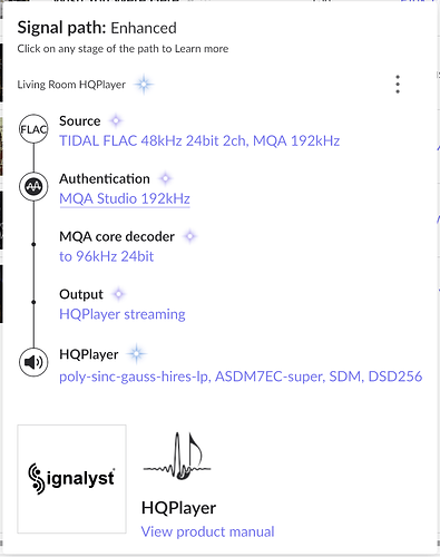

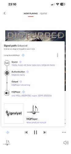

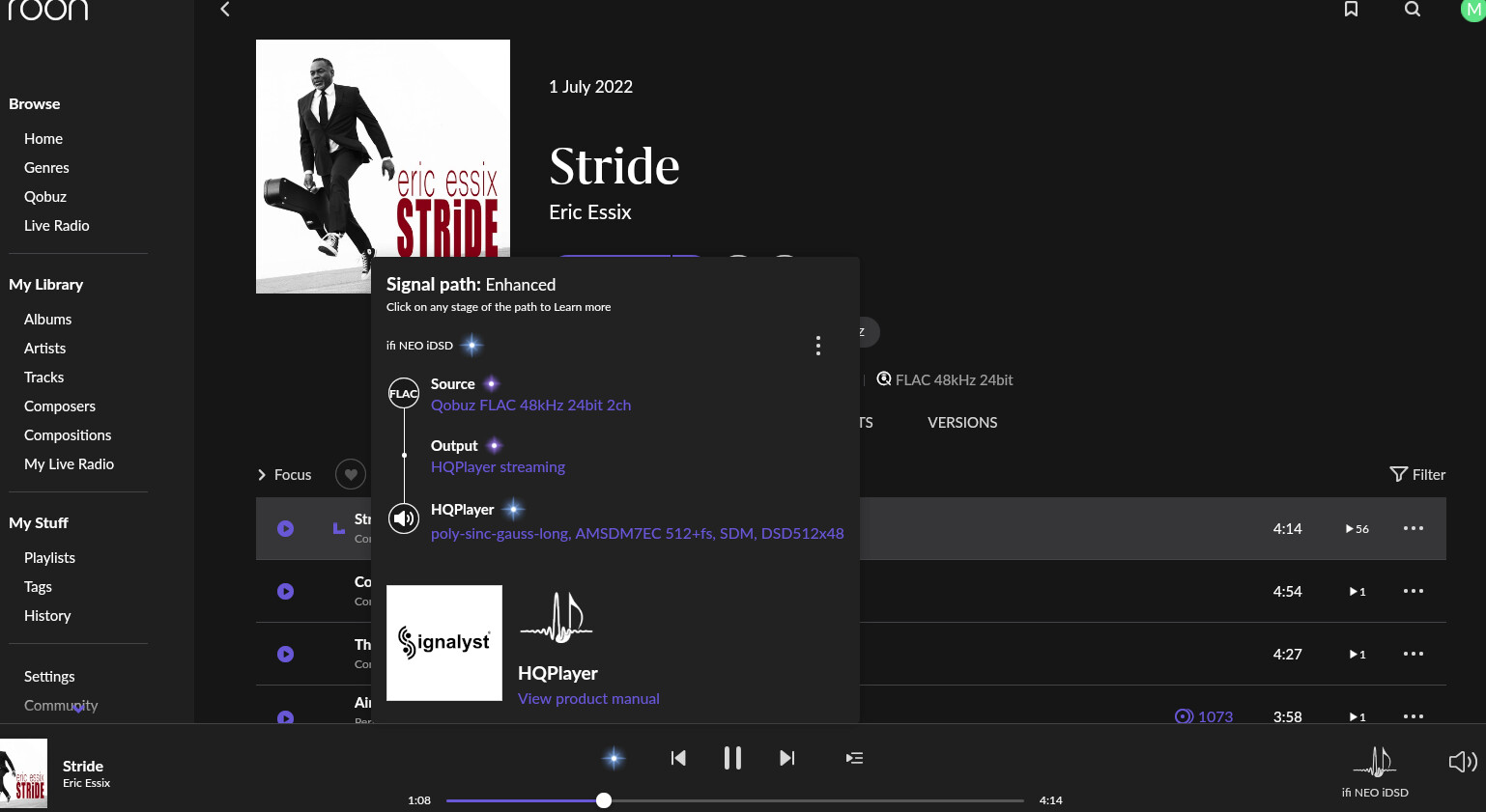

And, one more thing… …I’m trying out sinc-MGa+ASDM7EC-super at DSD256. This works fine with 44.1/16-bit Flac/44.1 MQA. It however doesn’t work with 48/24-bit Flac/48 MQA. Looking at the playout chain, MQA doesn’t show authentication for the latter. Any idea what’s happening here?
What’s your DAC ?
And post screenshots of your HQP settings.
Usually these 2 things give a good clue why things aren’t working
Roon signal path shows little info for troubleshooting

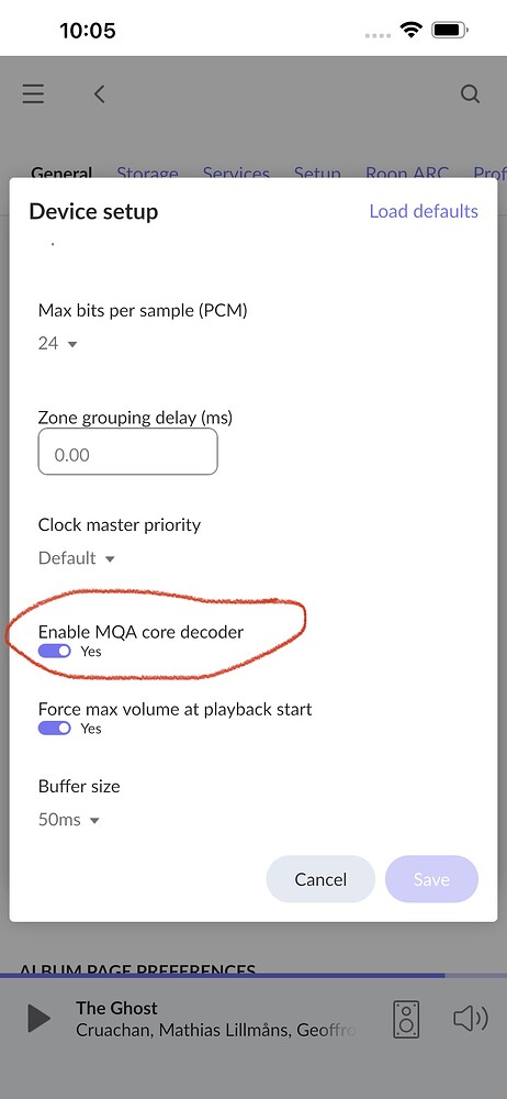

Have you enable MQA on “advanced settings” only on HQplayer
I should have explained further: MQA decoding works fine for most MQA settings (as per the first screen shot) - it’s just that with this combination of source encoding and HQP settings, it doesn’t appear to authenticate the MQA stream, and nothing plays out. If I take HQP out of the loop and drive the DAC (Gustard A26) directly from Roon, it works fine.
[Update]. I suspect that this may just be my Mac Mini M1 (basic spec) running out of steam. If I switch off MQA decoding and rendering in Roon (just leaving the core decoder on in advanced settings), then it plays out any MQA, downsampled to 96KHz, before HQP’s upsamplers kick in.
Your DAC is likely not capable of DSD playback at multiples of 48k? So this filter cannot used for 48k family sources when output is restricted to multiples of 44.1k. You would need to choose a filter that can convert to 44.1k family regardless of source (please refer to the table in manual).
That is MQA stuff and totally unrelated to any HQPlayer things. You can safely ignore such things. If possible, try to choose non-MQA (lossless) source, such as Qobuz.

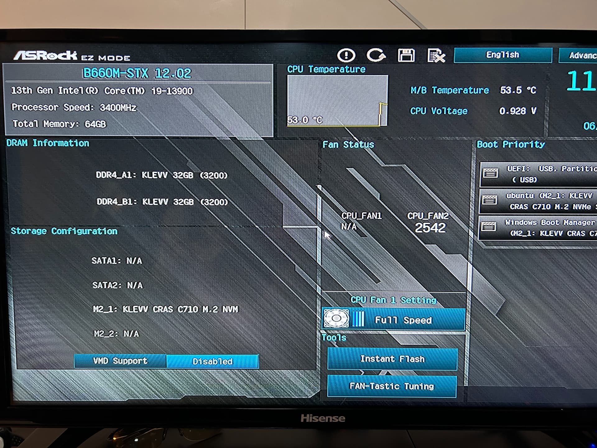

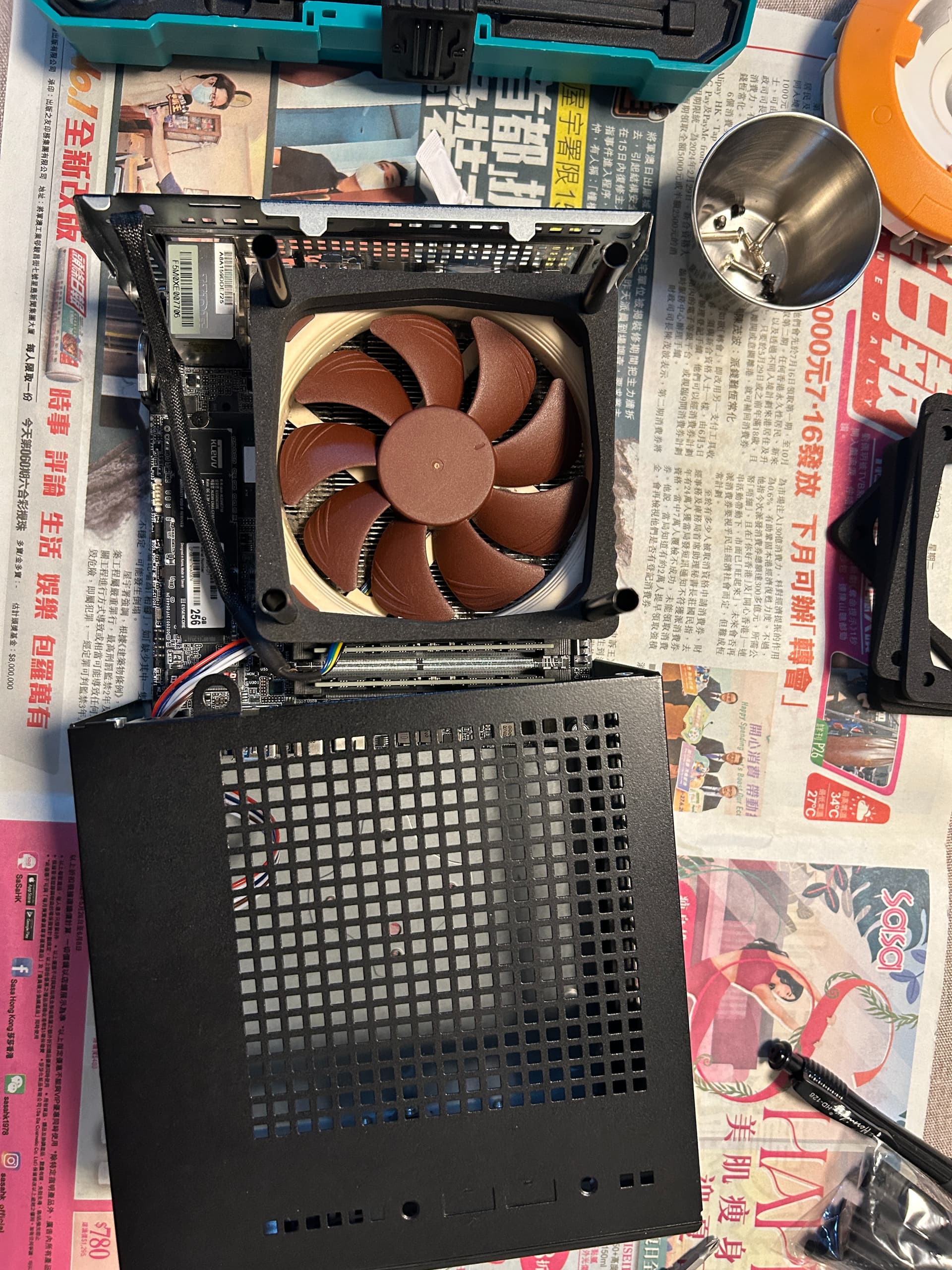

DeskMini B660 with i9-1300 64GB RAM

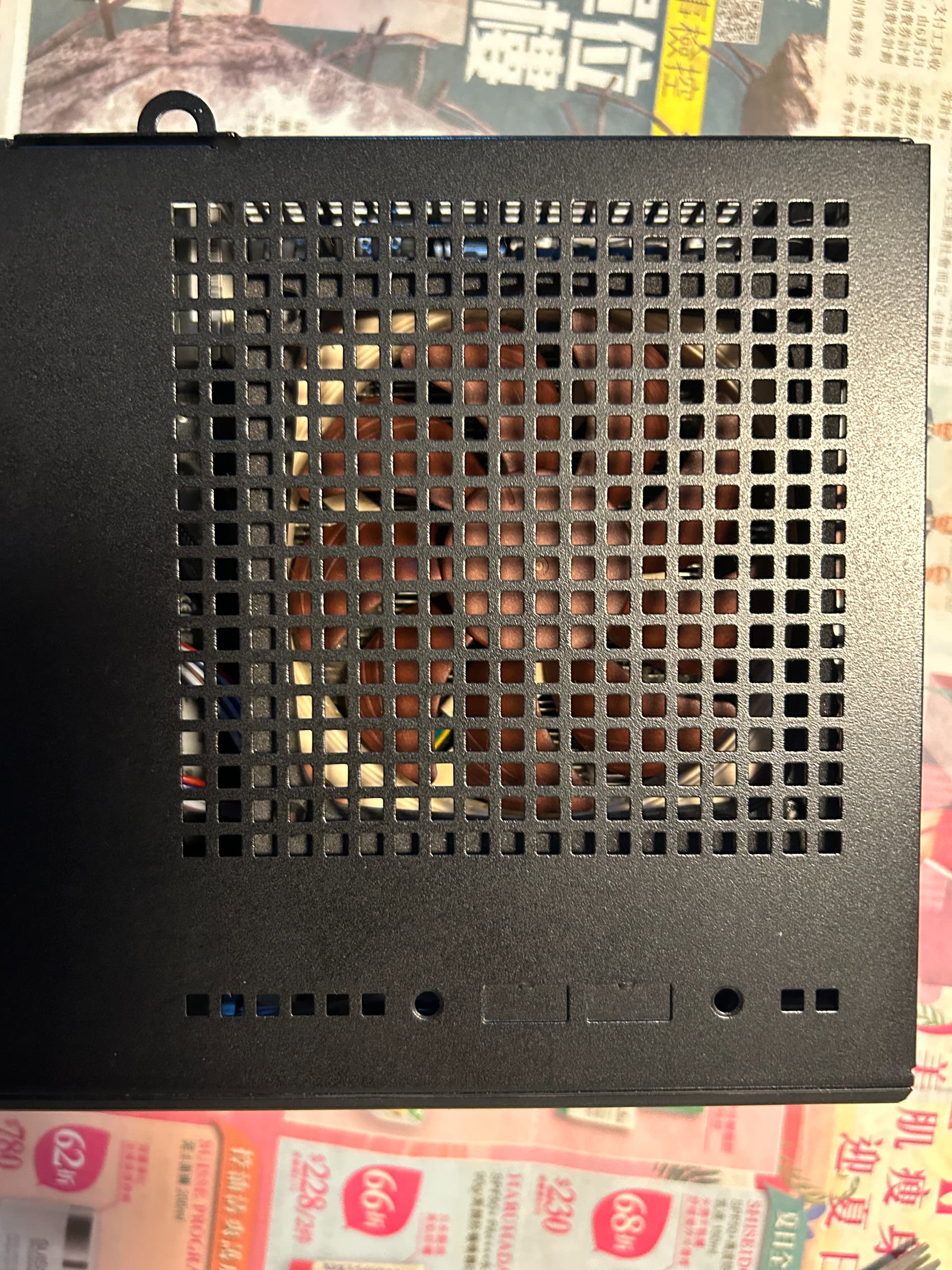

Running Embbedded 5.0
Noctuna Fan NH-L9i-17xx Upgraded/foam covers : NA-FD1
Lowered temperature to 53C using demanding filters
Edit: Very low noise fan/ able to have the cpu in listening room won’t notice it
Tested on a FLAC 192kHz file:
Modulators: ASDM7ECV3 x DSD512x48
Filters: ok Nx
Poly-sinc-ext3
Sinc-M
Sinc-Mx
Sinc-MGa
Sinc-Ls
Noctua makes really nice cooling solutions. I have used their NH-D15 / NH-D15S on many of my builds.
From earlier posts, on Mar 17, it looks like you previously had an i7-12700 and it was already able to do ASDM7ECv2 @ DSD512? And so you upgraded the deskmini to a i9-13900 and of course can also do ASDM7ECv3 @ DSD512.
What additional HQP capabilities has the upgrade provided? Just trying to figure out what CPU to buy.
[Edit: the deskmini doesn’t have the power to run the 13900 at full speed so not sure what the point is - thinking about an i7-13700]
