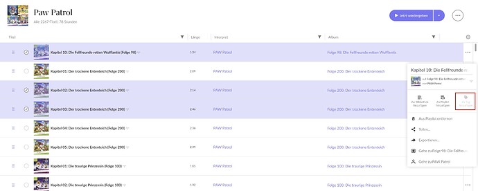

I’ve created a tag called “Paw Patrol”, went into my playlist, marked all Paw Patrol single tracks and tried to mark it with the “Paw Patrol” tag. Not working.
In the description it’s clearly stated that you can almost “tag” everything.
Any suggestion how I can handle this?

thanks for your answer…but it’s still not working.
I’ve resolved it by creating diff. playlists for each story…easier than the tags…still not getting how you can’t add each individual song to a tag.

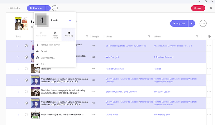

You can add Tags to a Playlist, but you can’t add Tags to items in a Playlist in the Playlist itself.
Actually, I’ve just found out that you can. For example:
Is this process not working for you?
No, I can’t
I suspect it’s because you haven’t actually added these tracks/albums to your library - the Playlist contents refer to the tracks/albums on the streaming service.
You need to have them added to your Roon Library first…
Here’s an example, a Roon Playlist. I happen to have Black Host in my library, so I can add a tag to it…
But the next track in the Playlist is NOT in my library, and I can’t add a tag to it…
Actually, after some further investigation, I suspect it’s not quite so simple as I thought. The example of Black Host that I gave in my last post turns out to be a local file, and Roon seems to have picked that up so I can add a tag to it in the Playlist.
For tracks/albums that are held on streaming services (in your case, Tidal), you can’t add tags to them in the Playlist browser, even if they have been added to your Roon library…
You actually have to go into the Album or Track browsers and add your tags there. Then select the tags you want to make up your Playlist and create the Playlist from the tag results.
