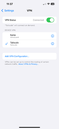

Here is what I don’t understand: when Tailscale is enabled (NAS as a subnet router and iPhone to access ARC or ROCK) I am able to access the roon server’s (ROCK on a NUC) “homepage” via browser and IP. Access, powering down, rebooting, everything works from outside my LAN.
But the Roon App won’t find the roon Rock server! I really don’t understand the difference, why it won’t show up on Roon app on the iPhone, when I can access roon ROCK via browser and IP. And even more mysterious: when I initially configured Tailscale, it worked, until it didn’t, which is a mystery because I never changed any settings.

I don’t think that would work either. Roon device discovery uses IP multicast, which does not traverse the Tailscale VPN (there’s extensive discussion of this on other Tailscale threads). Roon ARC connects to the Roon server via a specified IP address, and traffic then flows over Tailscale. But the standard Roon app, designed for the local network, relies on Roon’s multicast discovery, and so it can’t find the Roon server when it is away from the local network where the server resides.
Another interesting detail: When I am in my Wi-Fi and connect my roon App to the server And then switch off Wi-Fi on my phone and connect Tailscale, the Roon app stays connected to the server for a few minutes before it loses its connection again.
