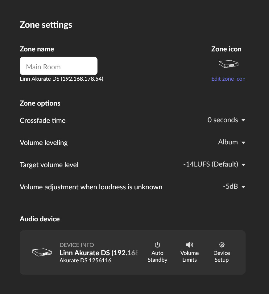

These settings should than solve the problem? “Album” instead of “Auto”
You seemed to say different albums were at different levels. Selecting album will level within an album not between albums.

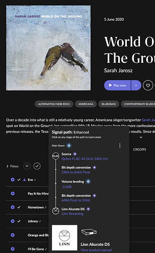

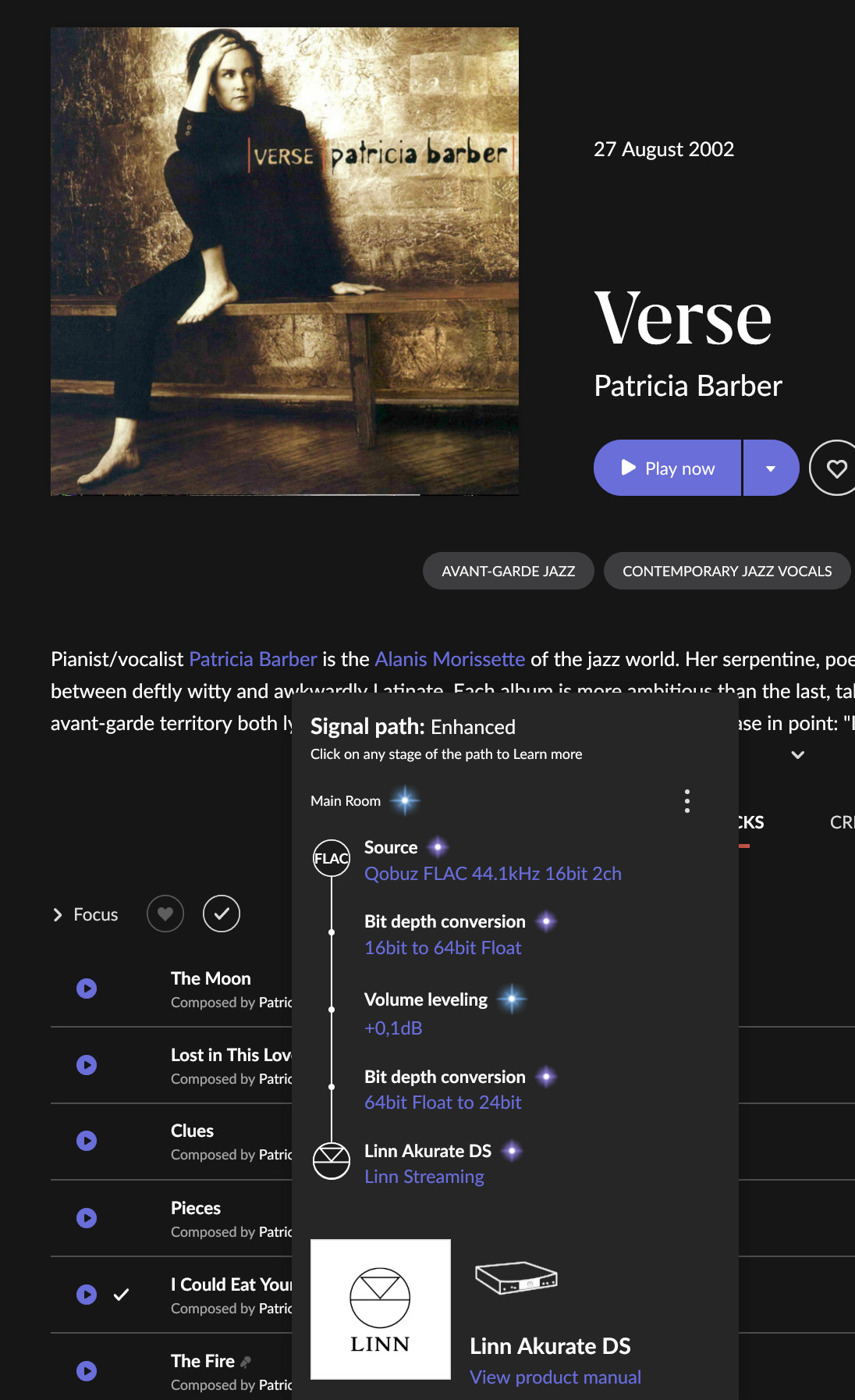

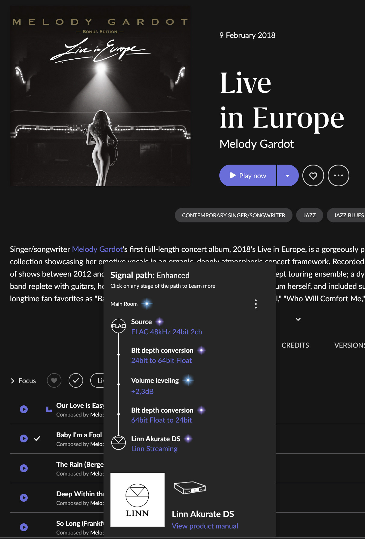

Did a test :slight_smile: 3 different albums - + 0,1 DB, + 2,3 DB and - 2,4 DB

This is wrong. Selecting “Album” will not level within an album but from album to album. The idea being that the album was created with certain track to track volume differences for creative purposes so those differences stay the same. In other words, the entire album will play back at the same adjustment regardless of differences in individual tracks.

Roon supports four Volume Leveling modes:
  1. Off - disable volume leveling for this zone.
  2. Track - Performs adjustments on a track-by-track basis. This produces the most consistent volume level during a playback session, but may result in unpleasant jumps in volume during playback of a gapless album.
  3. Album - Performs adjustments on an album-by-album basis. This means that the entirety of an album plays back with the same adjustment, and there are no perceived volume jumps at track boundaries.
  4. Auto - Uses track adjustments when playing adjacent tracks from different albums, and album level adjustments when playing adjacent tracks from the same album.
