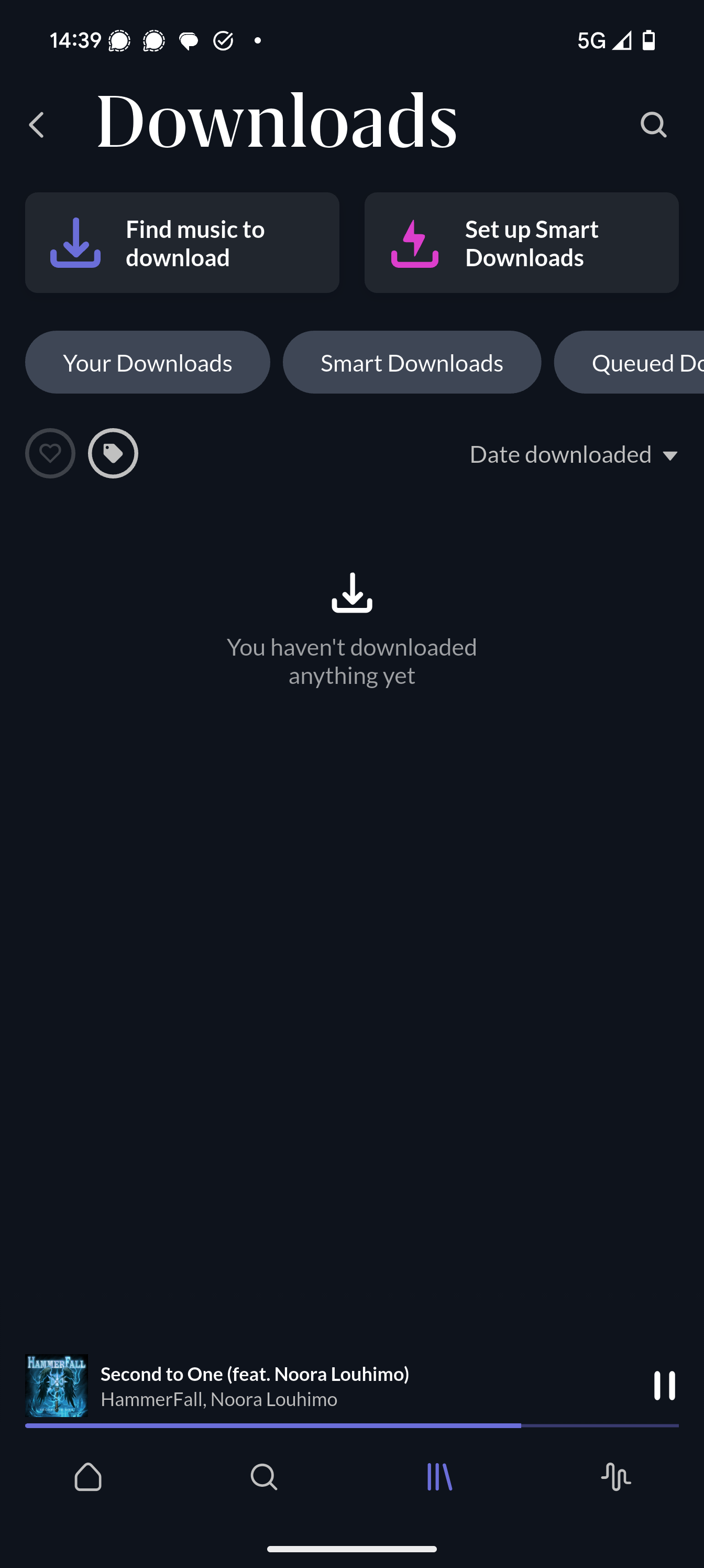

  • Library → Downloads shows “you haven’t downloaded anything yet”

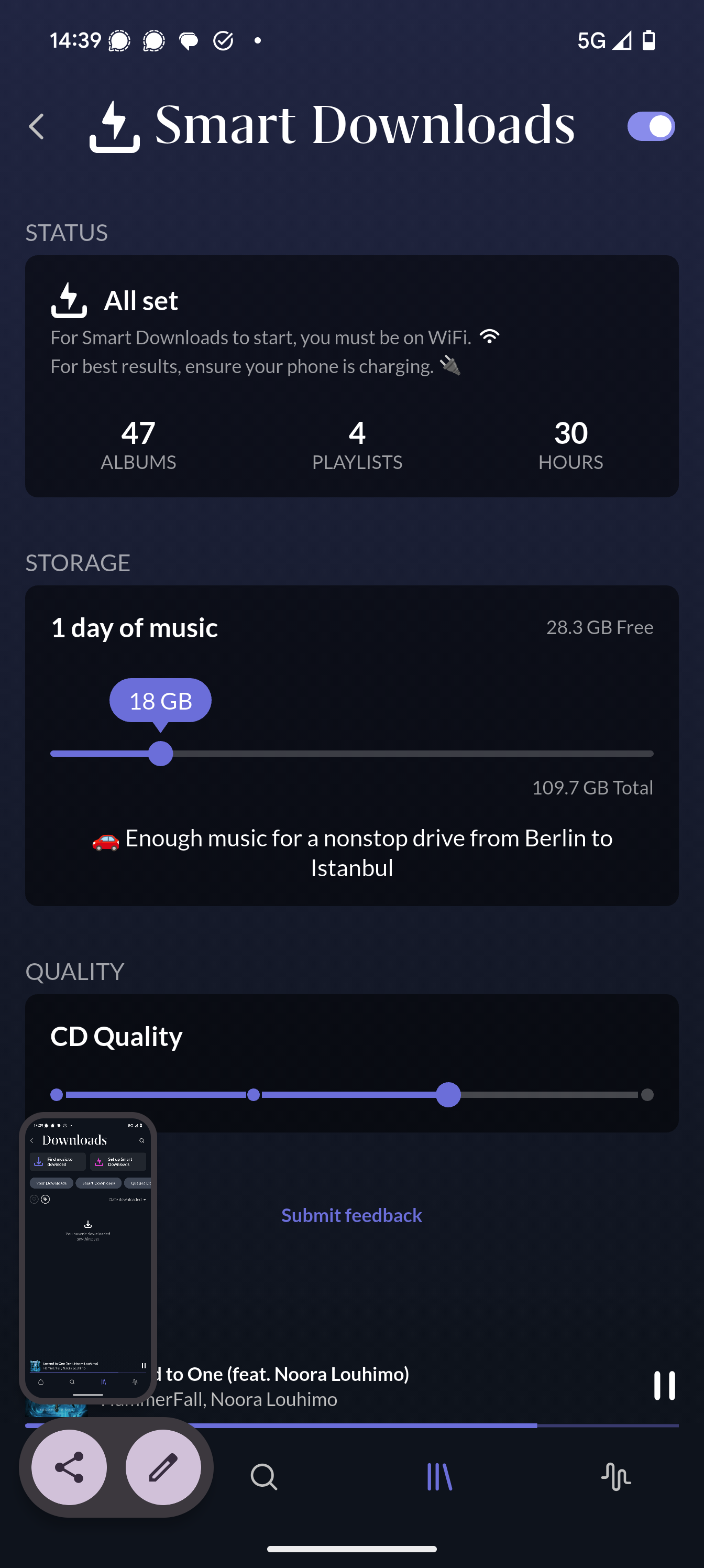

  • the “smart downloads” tile says “set up smart downloads”
    • clicking on this shows a configured smart downloads screen and “all set” at the top

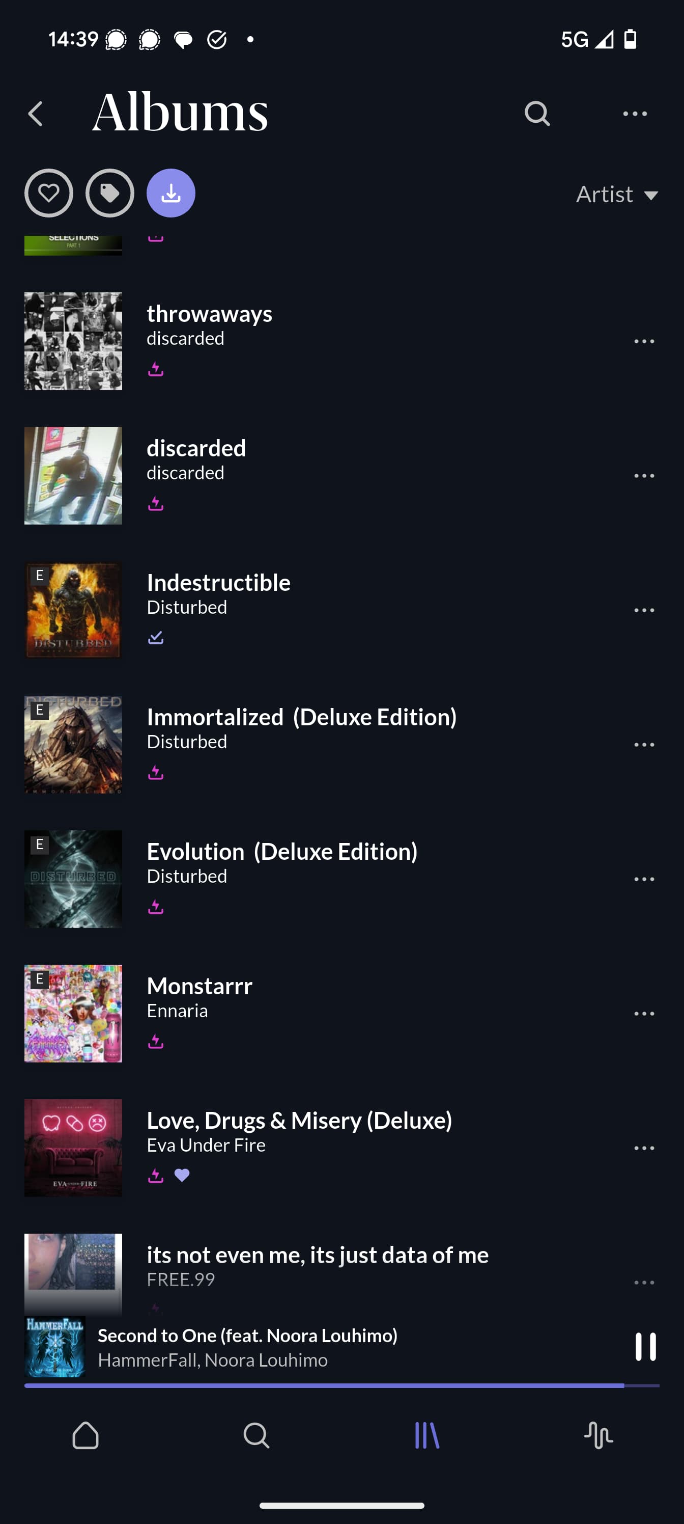

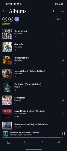

  • going to Library → Albums and filtering by downloads shows a whole bunch of downloaded albums. I’ve confirmed these are playable offline.

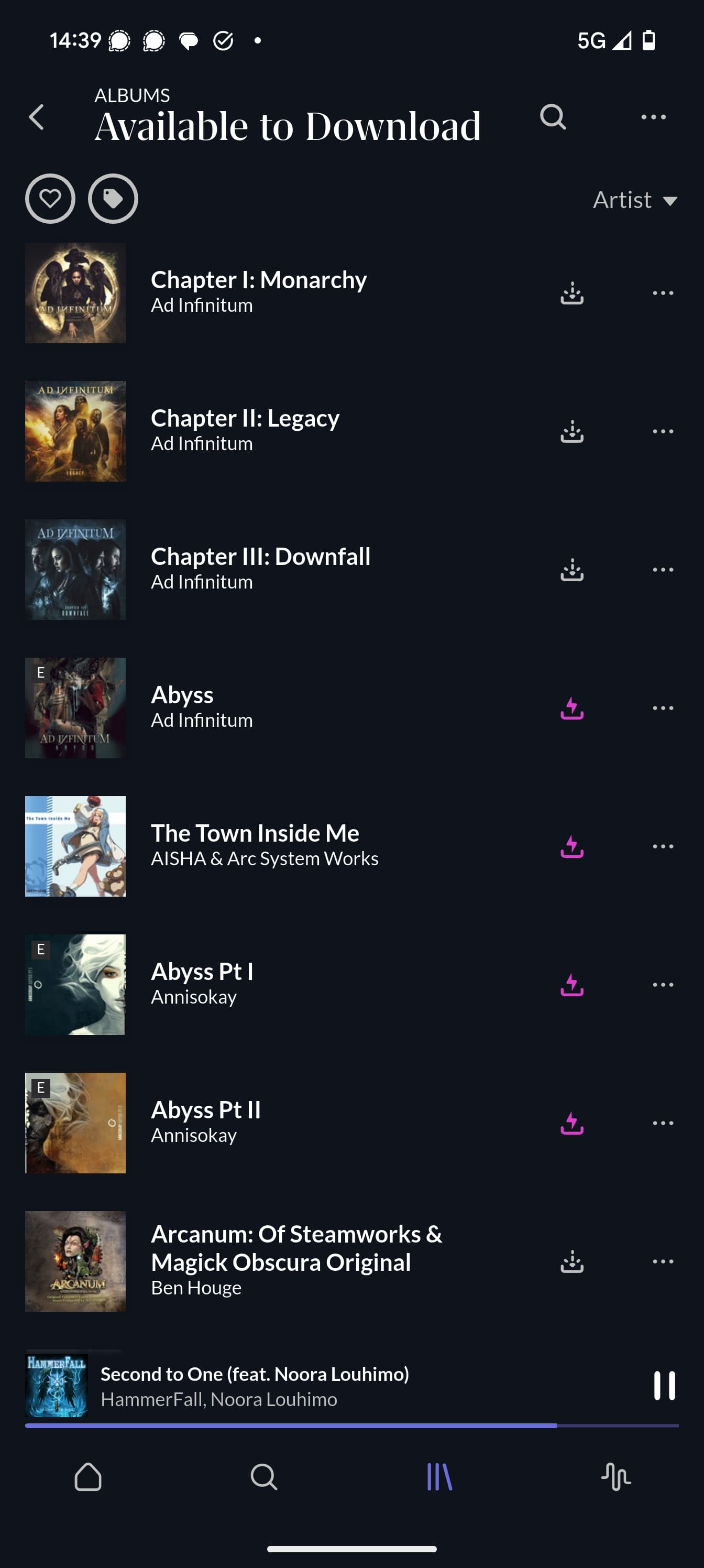

in the meantime, screenshots:
(I’ll try doing a new manual download when i get back to wifi too)
(missed the important one lol)
confirmed: downloading a new track or album works-as-in-is-available-locally, but still does not show on the downloads screen
