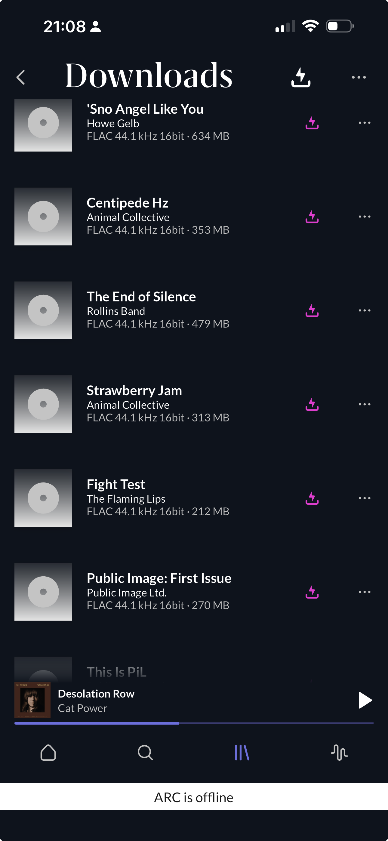

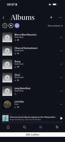

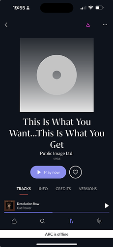

Really? Boarded a flight, turned on airplane mode on the iPhone and offline mode on ARC, and it looks like this:
Just tried - same here…

The albums in the above screenshot are very likely manual downloads from pre-SDL (they don’t show format info, as discussed in the B223 feedback thread after SDL became available), but I just tried again.
I arrived at my destination hours ago and have wifi and 5G - and covers are fine as soon as I am on wifi or 5G.

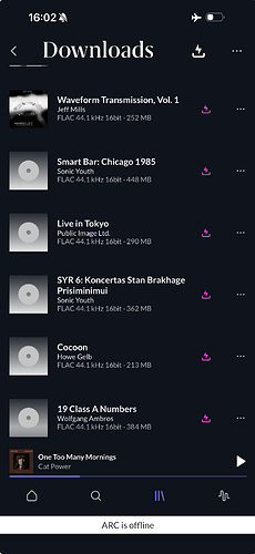

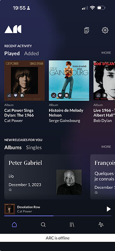

For testing I once again enabled airplane mode and ARC offline mode. The albums from the above screenshot now had covers, but most didn’t and this includes recent SDL downloads:

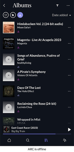

I still can and all it takes is enabling ARCā€˜s offline switch. I just tried again, just like my second post further up, affecting new SDL downloads just like old ones. Yesterday on the plane I noticed that my profile icon also switched to a generic one, but this corrected itself when I went back online and just now it didn’t happen.
And some covers are displayed, but the vast majority isn’t

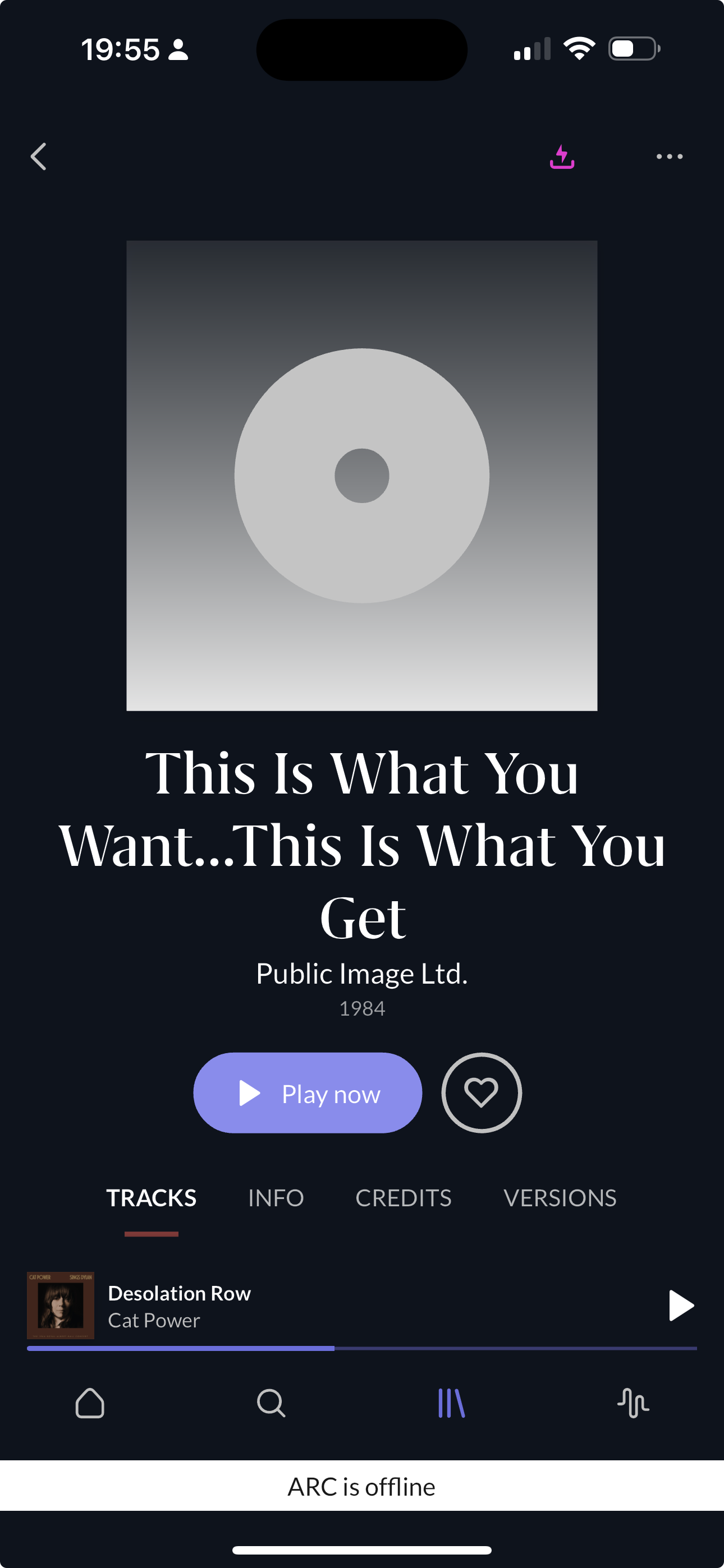

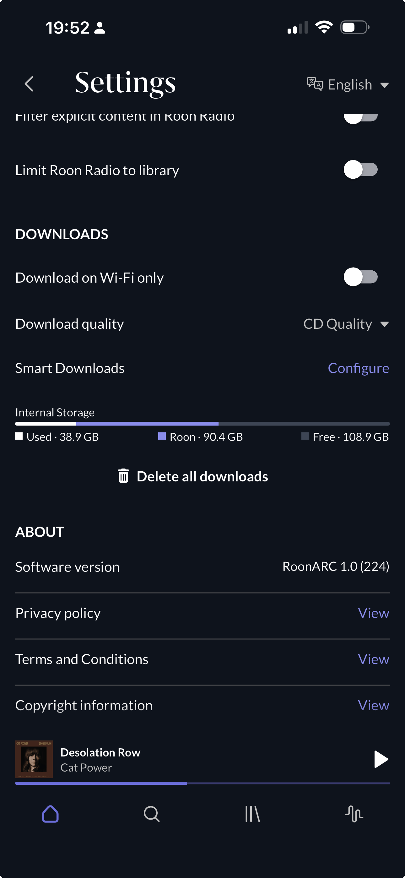

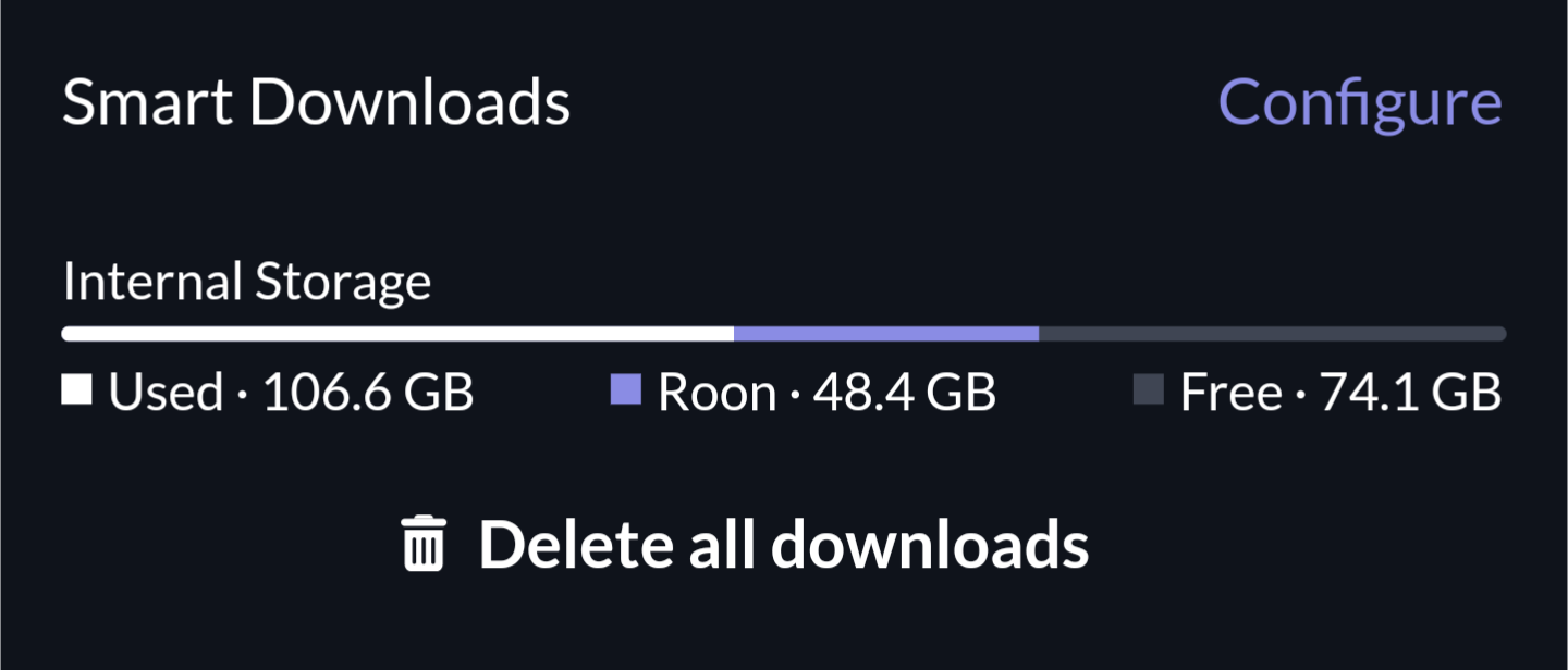

30 GB assigned to SDL. I had quite a lot older downloads pre-SDL, several 10 GB as well, I think, which I had just downloaded manually a few days before SDL was released. After SDL release I deleted some of those, and I switched some SDL downloads to permanent. Overall:

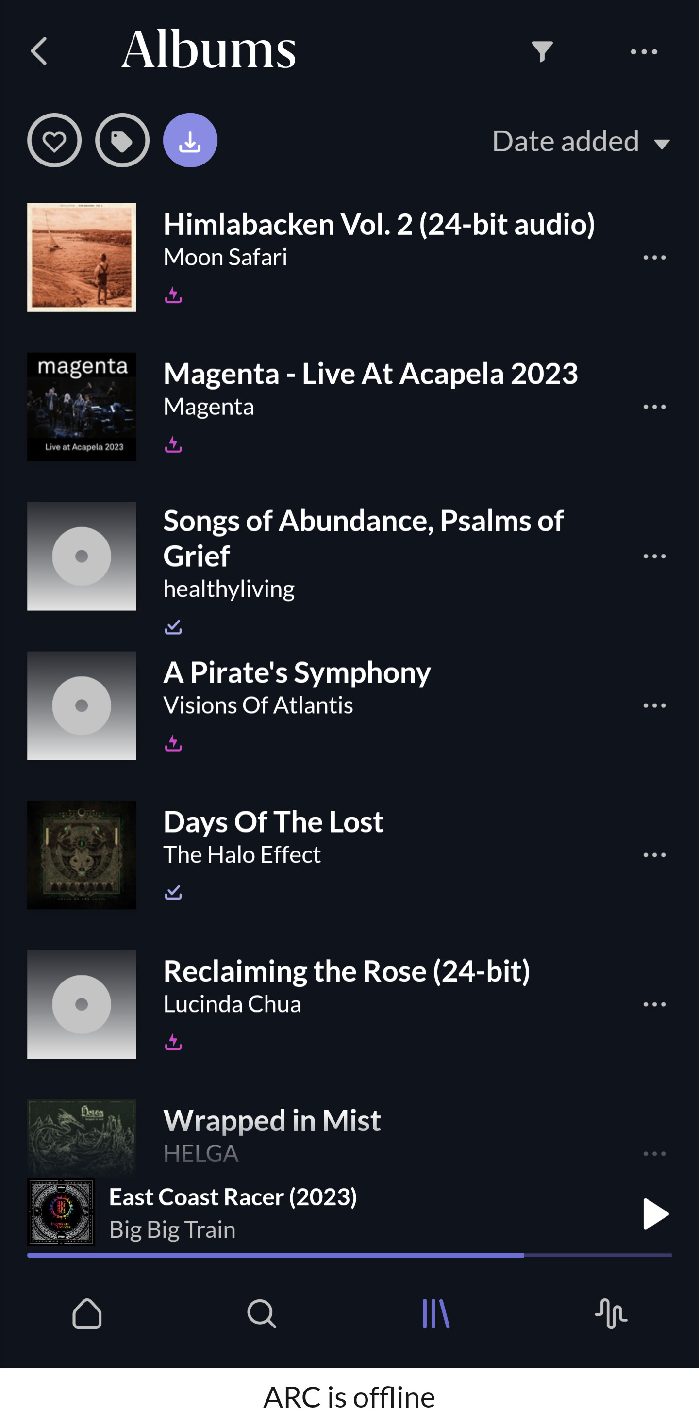

Nope, not for affected albums:

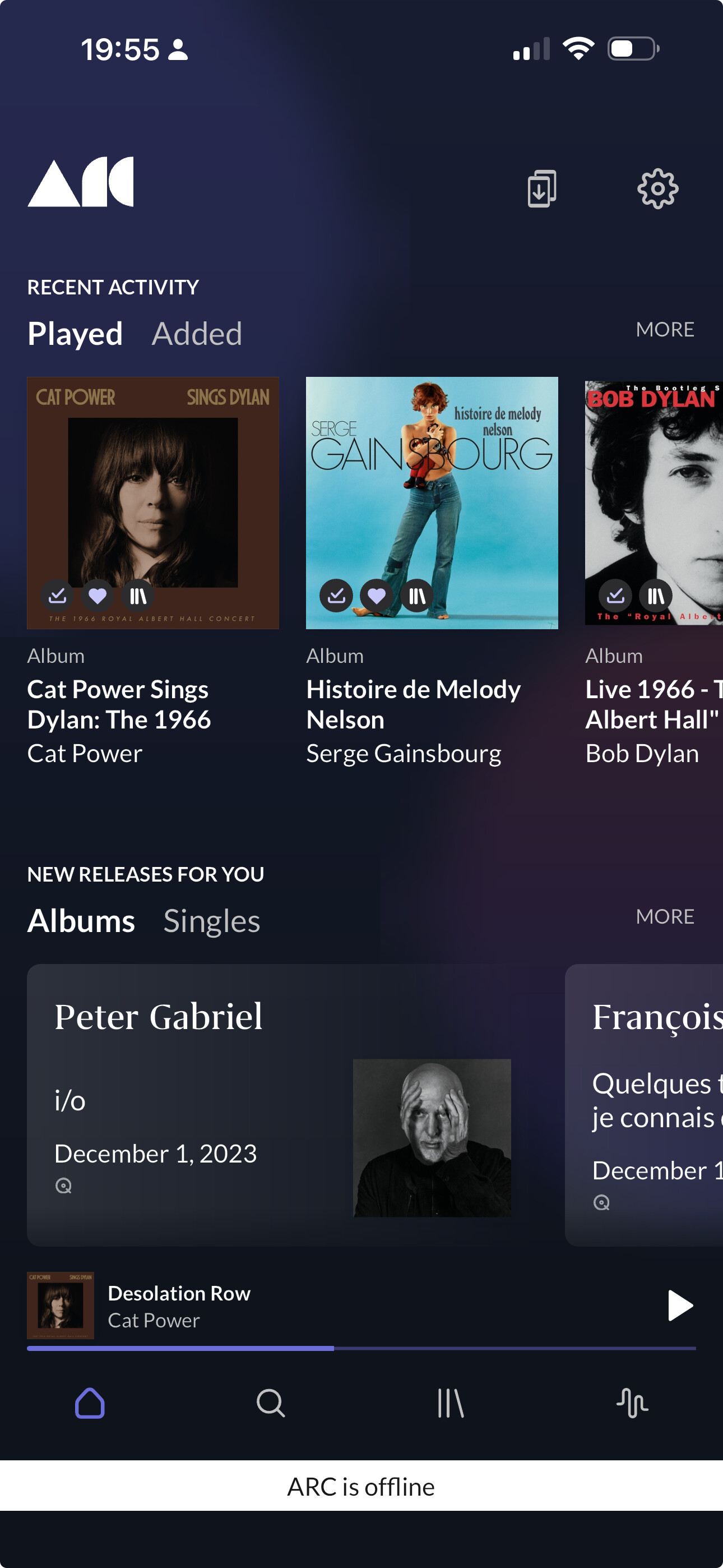

My ARC home page is fine now, though, and the covers that appear there are also present in the downloads list:

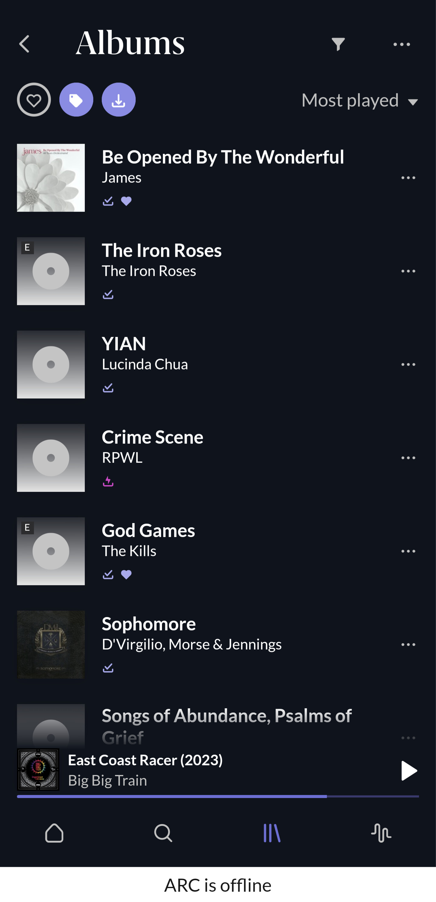

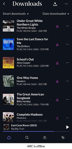

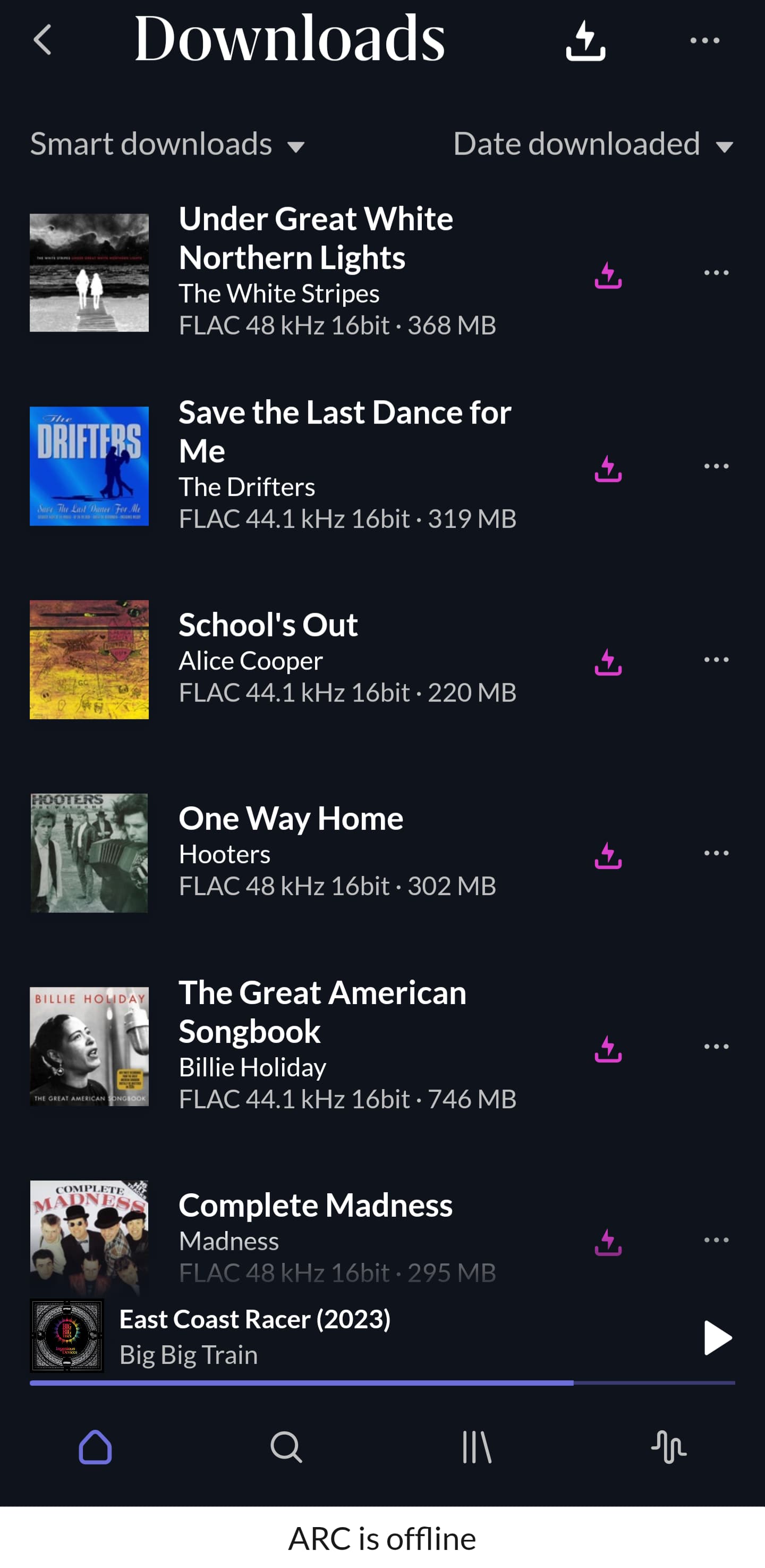

To add to this I am seeing the same thing when I tested going in to offline mode just now
The second screenshot is all smart Downloads of newly purchased albums. One or two of which I have converted to downloads.

Of course, it’s not small as I was testing out smart downloads :grin:
All working fine in online mode and I have migrated a fair number of smart Downloads to full downloads as well

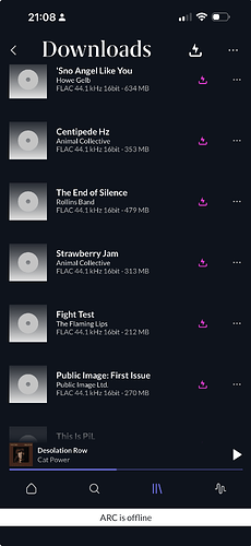

@oleh partially gone again, this is after updating to B225, then going offline:
There are slightly more albums with images than last time, but the vast majority is still grey.
After making the screenshot, I went online again, immediately went to the downloads browser, and started scrolling quickly through the list. Maybe interestingly, the covers seemed to be immediately available, without them getting visibly updated while scrolling.

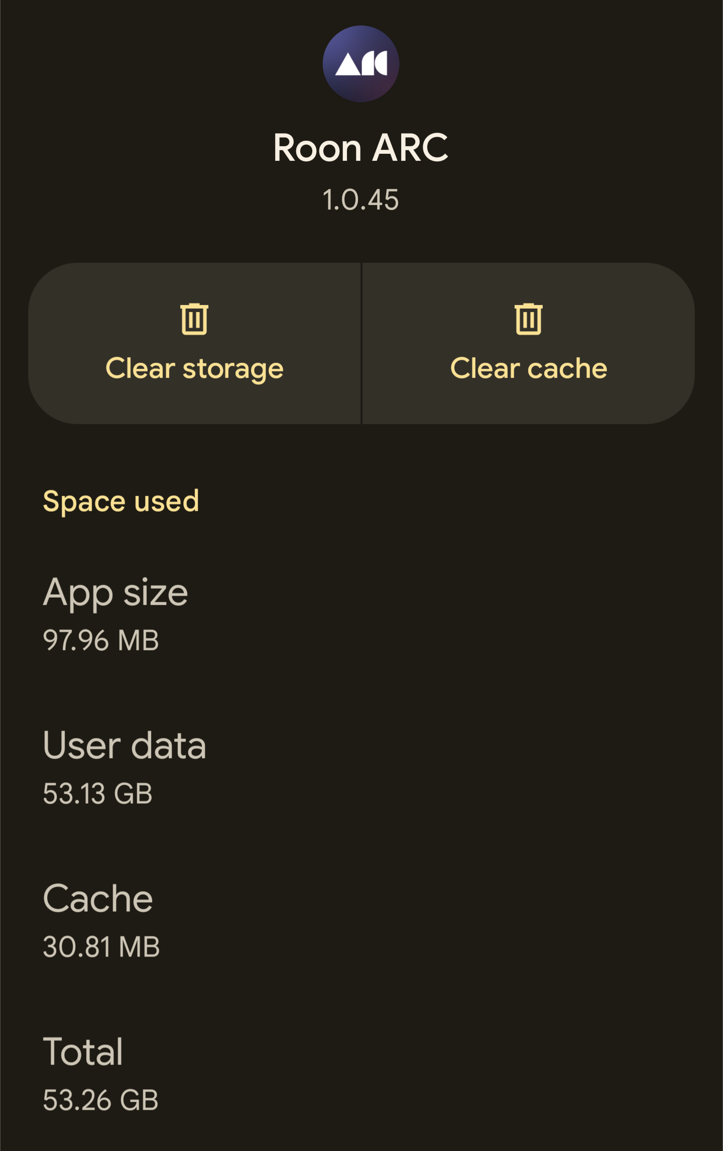

Hi Oleh Answers inline below
it was an Android device?
Yes a Google Pixel 7 Pro fully updated
were the albums downloaded in the background? If so, how often your phone was used (ARC called to the foreground) during the downloading? Were there some obvious interruptions?
Some were downloaded in background, but all battery optimisations for ARC are turned off.
after enabling smart downloads or queueing some items, how frequently did you foreground-backgrounding the app?
Not that often, I go in to see what it is doing and sometimes moving smart downloads to permanent Downloads.
did you download it on wifi or a mobile connection? Have you transitioned from wifi to mobile during the download? Was ā€œallow mobile downloadsā€ enabled in the settings?
All downloads are on WiFi at home

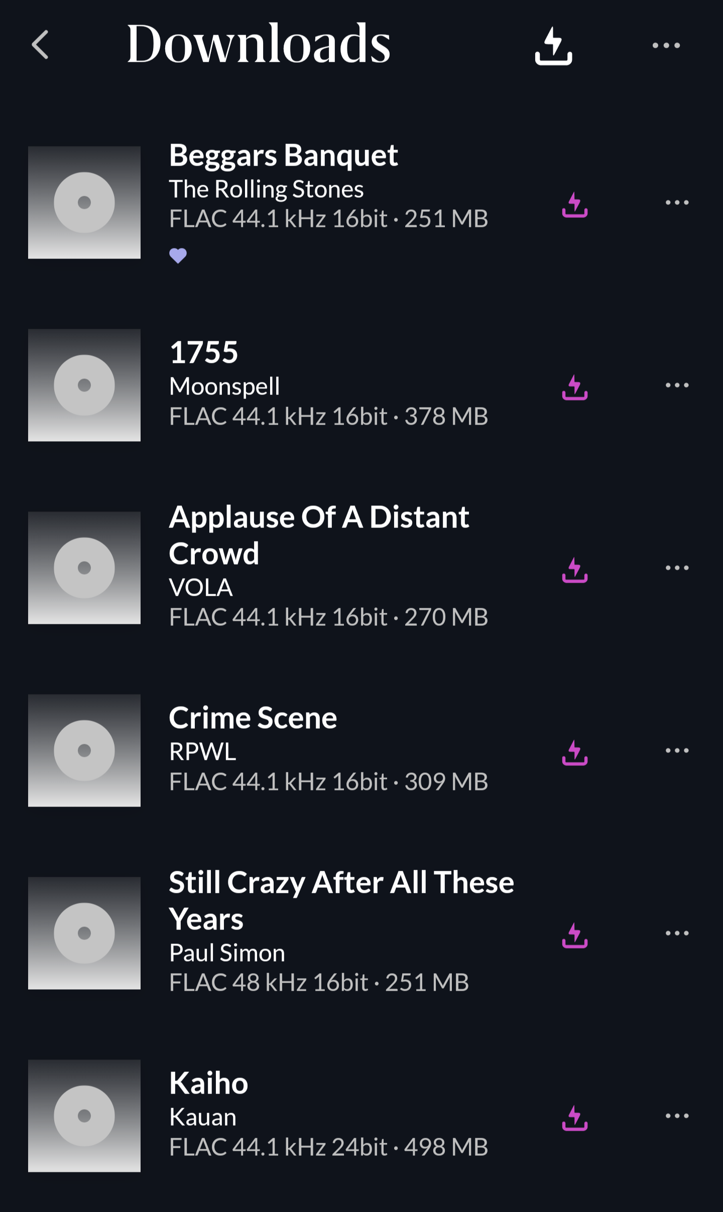

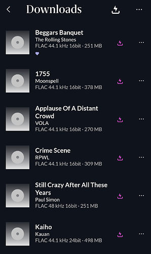

Doing some testing now and it looks like a batch failed to go get downloads at some point
This is the latest

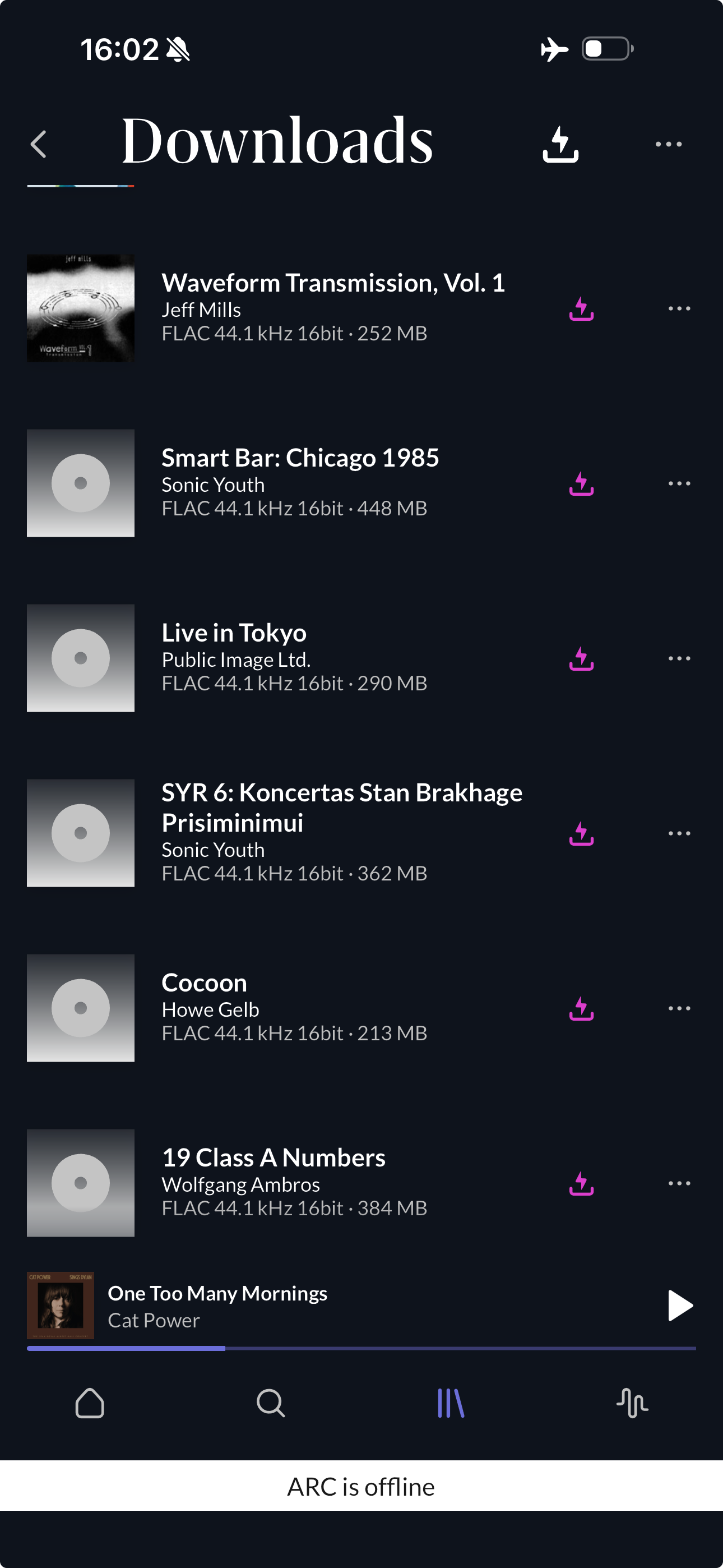

In date order there are dozens of smart downloads without covers when in offline mode
Hopefully this helps a little, but happy to do more testing.
