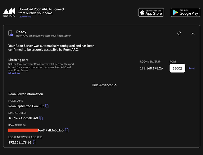

I did a “reconnect” on the router now, to renew the internet connection without restarting the router, but didn’t change anything for ARC connectivity. I get this now (but did already before I reconnected the router):
And the settings are still OK, of course:

I also saw a global IPv6 address then, just like you do now. Since ARC started working again for me, the ARC test has been showing the (shorter) local-link IPv6 address of the server.
