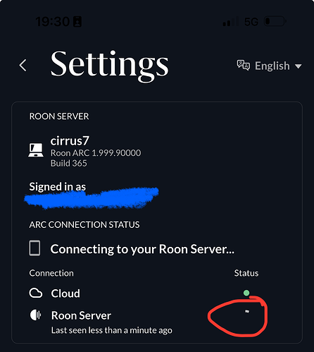

Yet ARC gets no server connection when on the cell network or on another foreign network:
(ARC works fine when the phone is on the home wifi, that’s why the connection check says „last seen less than a minute ago“ in the screenshot).

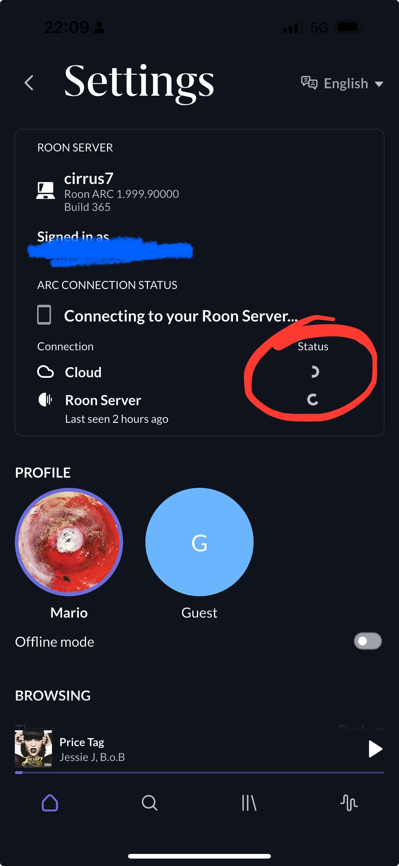

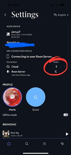

Now I disabled IPv6 on the router and it doesn’t help. In fact it got slightly worse or at least different:
First, the connection check failed for „Cloud“ as well. Though I suppose this had nothing to do with me and my router:

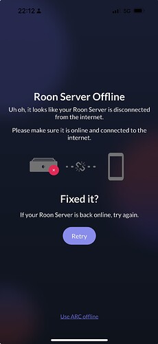

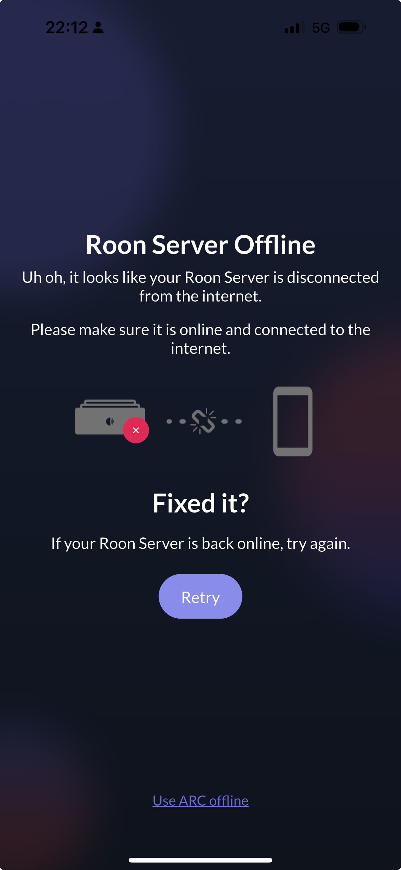

Then ARC switched to this:
I suppose this means that the connection to the router failed hard, instead of hanging endlessly with the spinner rotating.

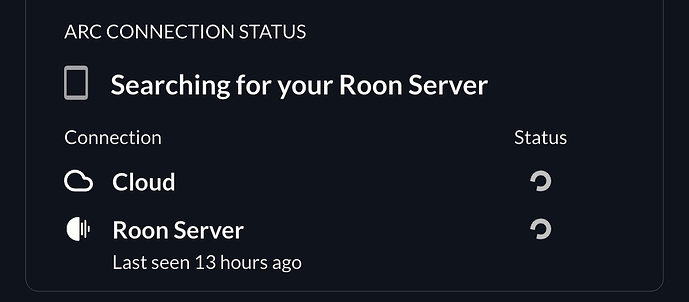

Well it’s broken again, and this time a phone reboot doesn’t help.
