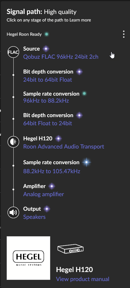

@Anders_Ertzeid I 100% understand that the Hegel H120 wants 44.1 or 88.2. I want to try and understand why the Roon core decoder does not first unfold to 96kHz and then convert to the 88.2kHz stream that the Hegel H120 accepts. I tried the same song with Qobuz and with Tidal. The expected conversion from 96 to 88.2 is indicated with Qobuz.
Read through this entire thread. It looks like the Hegel first downsamples from 96 to 88.2 or 48 to 44.1. Then it takes the resulting resolution and upsamples to 105.47. So, you are receiving a file of 96 from Qobuz and 48 from Tidal.

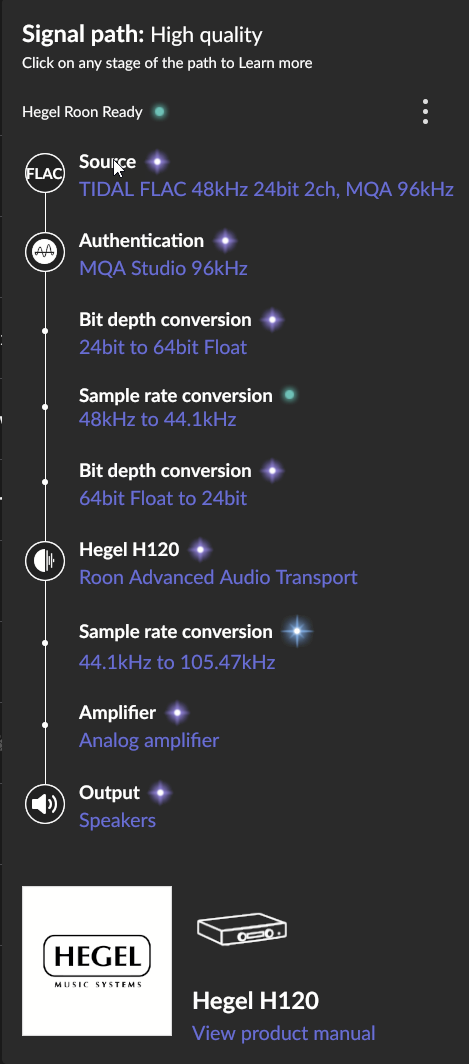

Not true Jim Roon is downsamplng as its before RAAT to the Hegel.In this example you have a 48khz MQA it cannot be decoded to anything other than 96/24 the Hegel can’t accept 96/24 so Roon is down sampling it 44.1 and breaking MQA decoding. There is likely some logic as to why it’s not doing the core decode before doing this or why it can’t just let the Hegel do it itself.

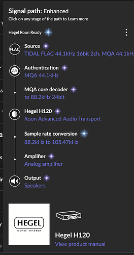

This example is working:
This example is not working:
First example works as the decoded file res is supported, 2nd isn’t so it must be Roons or Hegels logic that it gives no benefits to go to 96 then downsample to 88.1 then let Hegel again upsample to its playback rate. it’s one less processing step and filtering I guess.

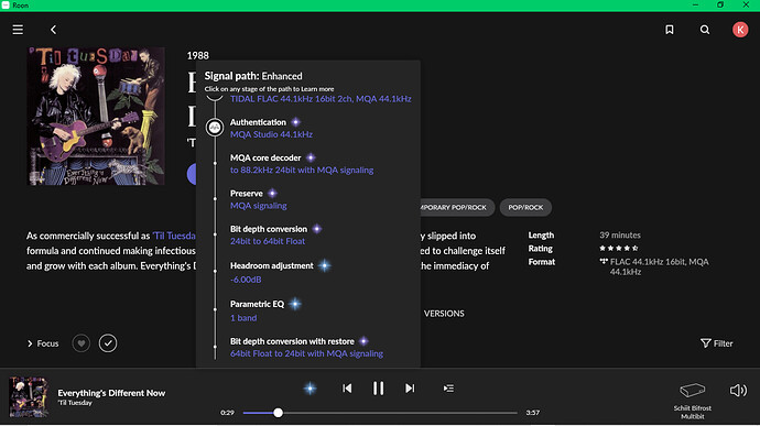

When I enable Roon’s MQA decoder, the signal path shows mw that the MQA signal is being preserved and sent to my non-MQA DAC. I’m not sure you are getting the MQA first decode. I certainly could be mistaken!
