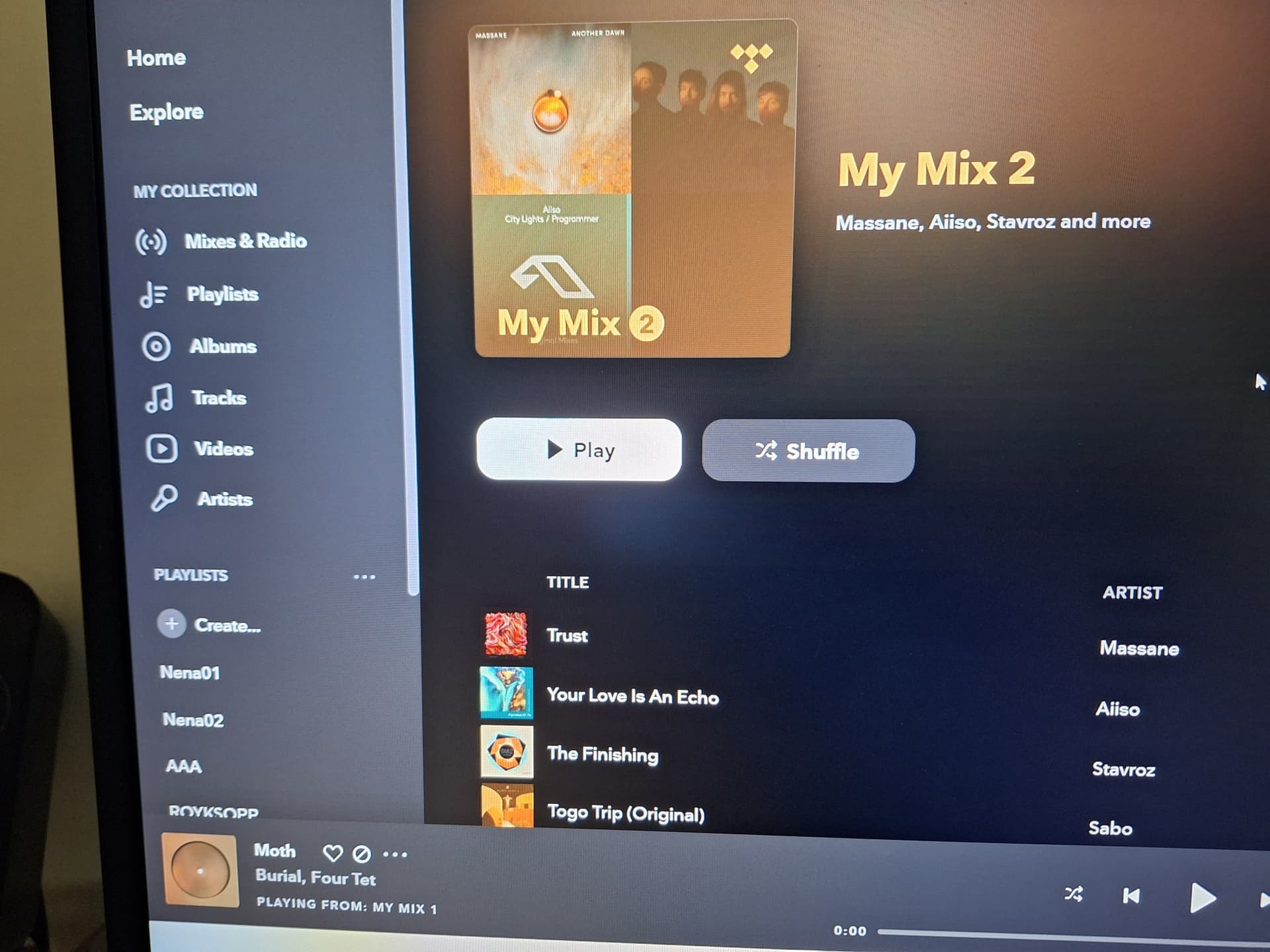

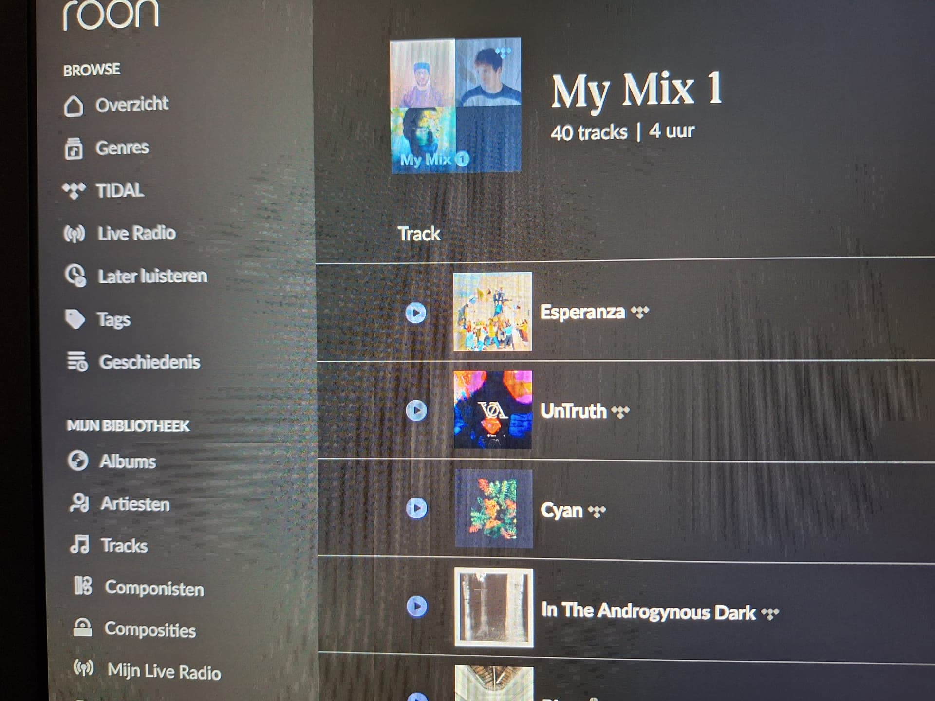

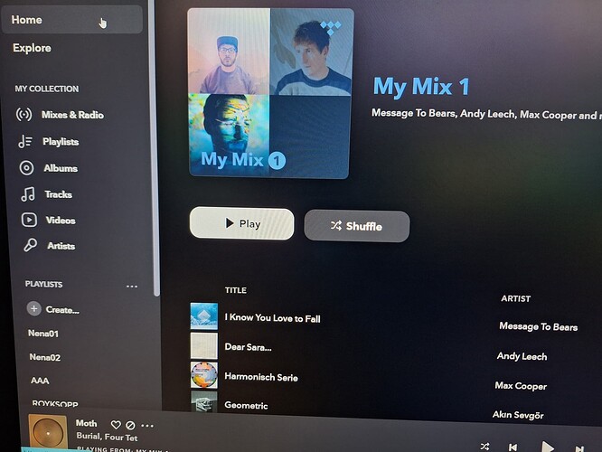

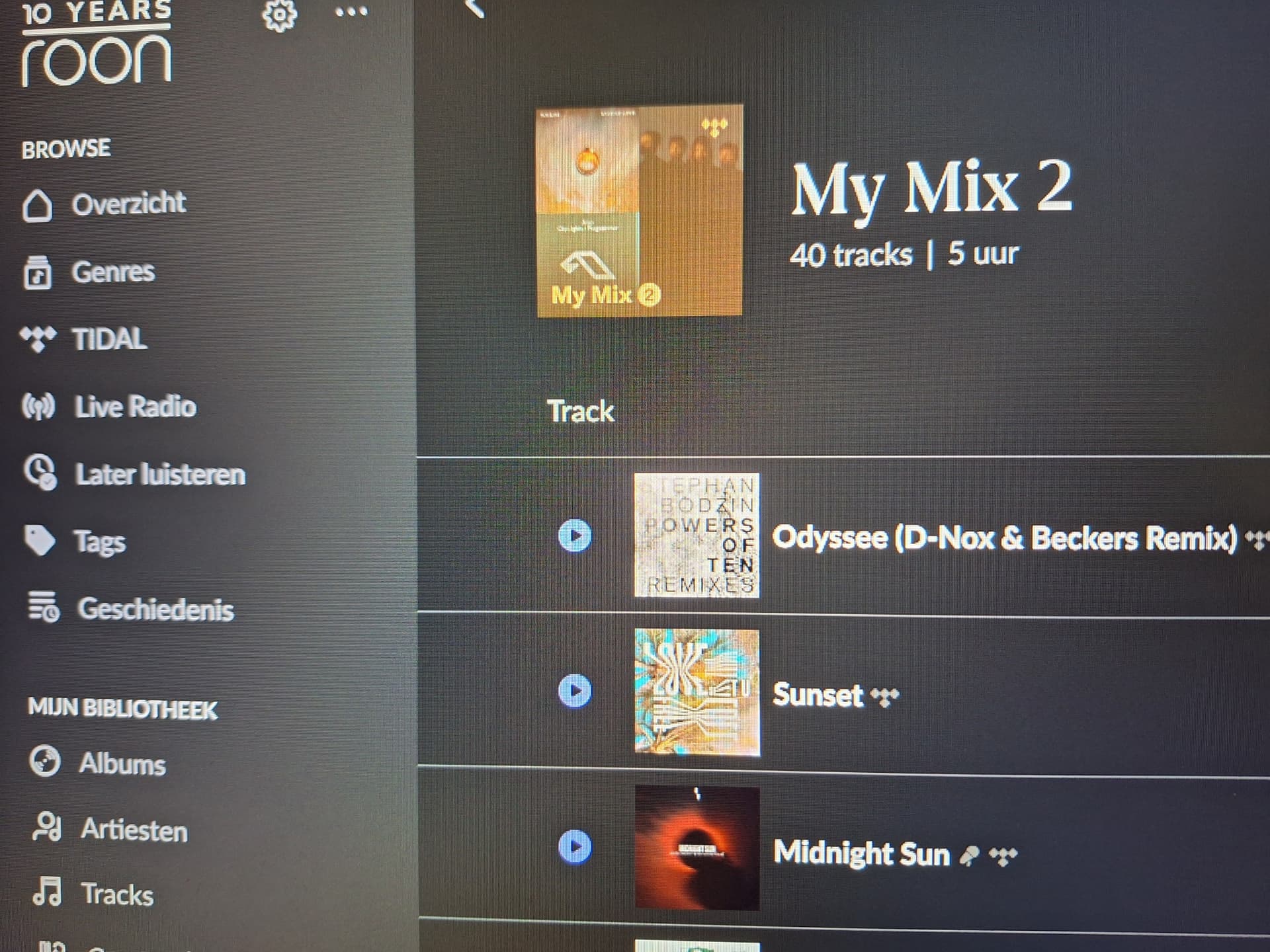

3 months later and it’s getting worse…again 4 photos, first 2 My Mix in Roon, 3rd and 4th photos are from My Mix in Tidal, compare these with previously posted photos, content of the My Mix in Roon has been the same for months!!
