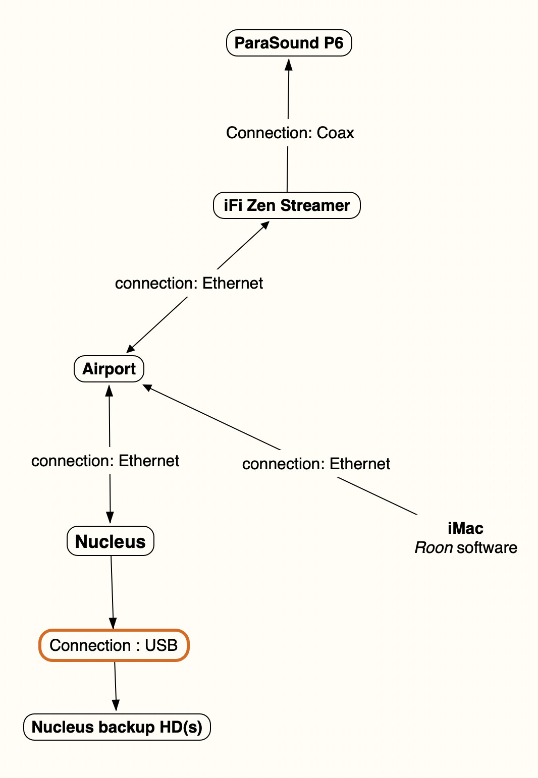

You would connect Nucleus to your router with an Ethernet cable. Another Ethernet cable from the router would go to Zen streamer. A DAC would connect to the streamer with whatever cable they have in common (USB is the best connection).
I don’t remember… do you already have the Zen and/or standalone DAC you want to keep? If you do, might as well use them, If not, I would personally rather buy an all-in -one endpoint with streamer and DAC, to keep things easier.

At the moment I have my Late 2017 iMac and a ParaSound Halo P6 preamplifier (then the same company’s A3 amp.), which has an excellent built-in DAC.
If I could just connect the Nucleus from the iMac via Ethernet and then to the P6, I would.
But I can’t, can I.
I’m not an expert here; but loving learning - and s extremely grateful to everyone here who’s so helpful.
So I believe I need the Streamer, the iFi Zen.
I’m preparing to connect the new Nucleus to the Airport.
which means it would, in fact be better, to site both Nucleus and Zen local to my computer bench with as short as 1ft Cat 6 BJC Ethernet for each:
- Airport Ethernet to Nucleus
- Airport Ethernet to Zen
And then run a high quality coax (25 feet) from the streamer across the roon to the P6?
Like this:
Sorry if that is a little difficult to visualize. But very grateful for your patience in guiding me in the right direction, Boris! Thanks
