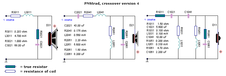

Here’s the crossover for the speakers I’m currently building:
If we look at the bass section on the left, medium and high frequency current is attenuated by the inductor L3011, then shunted via C3021. Current associated with MF and HF is still passing throught the cable, but bypassing the bass driver.
In the midrange section, high and low frequencies are being bypassed from the driver, yet still flowing through the cable.
In the tweeter section, bass and middrange frequencies are being shunted via the cable.
The currents associated with the undesired frequencies for each driver are still flowing through the cable that feeds each driver. The mathematics get fairly complicated but the long and short of it is that bi-wiring makes no audible difference.
If bi-wiring makes a “night and day” difference in sound, then something is amiss or broken…
There’s no voodoo here. Just basic physics and mathematics.
