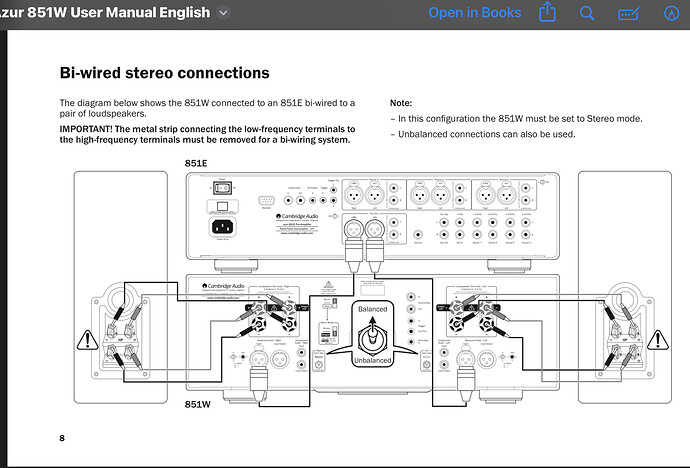

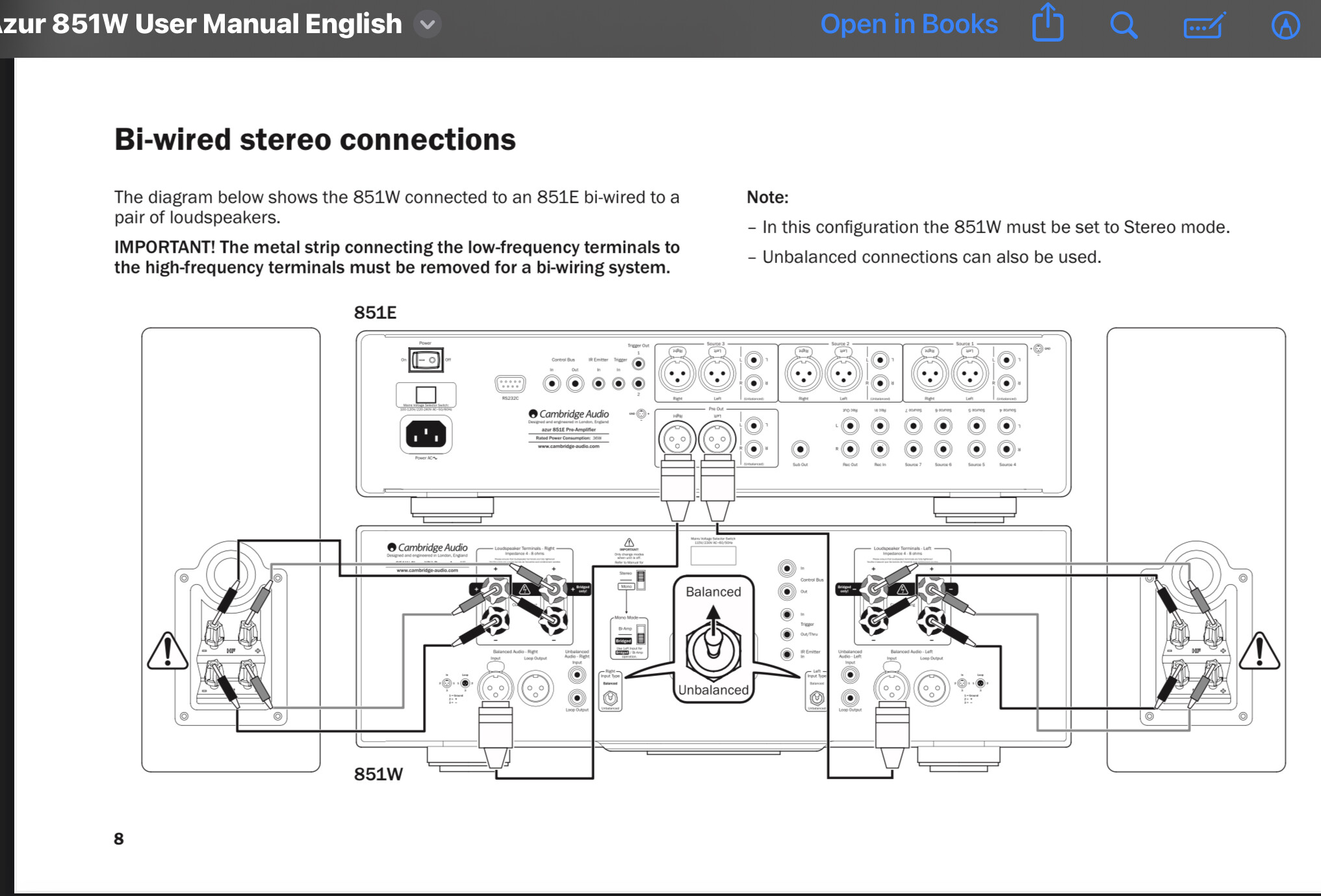

CA advertises the 851W as follows: “The 851W can be used in stereo, bi-amped or bridged mono configurations.” That suggests there may be some sort of internal crossover to at least separate the signal into “high” and “low”. Not sure how this would provide any improvement in SQ. If this is not the case, then their advertising is completely false and all they’re doing is bi-wiring which is not the same thing at all.
Think about it. A two channel amp cannot use a hypothetical internal crossover to separate HF and LF terminals for both L and R channels because that immediately would become four channels.

No it doesn’t. If there was an internal crossover, the amp would need to have adjustment options because every speaker needs different crossover points and fall-off slopes. And as @WiWavelength wrote, it would need 4 channels.

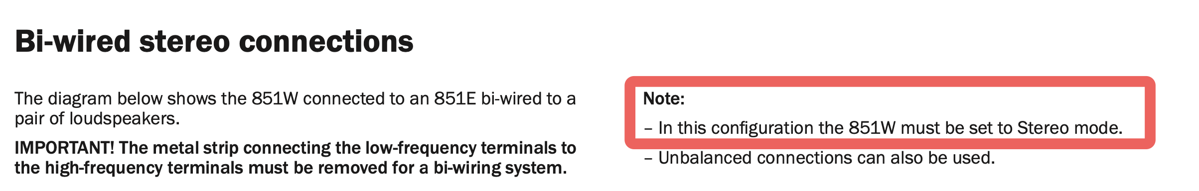

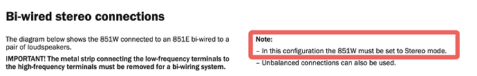

The pictures just show how to connect the amp in the various configs so that people don’t make mistakes setting them up if they follow the description. When bi-wiring, one amp output has to go to HF wires and one to LF wires either way, but the separation is done in the speaker’s crossover. It would not make much sense to have two different pictures for connecting them one way or the other in the bi-wiring case.

If there were an internal crossover, there would also have to be separate power amplifiers for HF and LF, so it wouold be a 4 channel amplifier, not a stereo one. And of course you’d also expect to have some information abut the crossover in the manual – no matter how it is set up, it’d make things significantly worse for most speakers out there. And at the bare minimum you’d expect output terminals to be marked HF and LF.
Not sure I understand this. Couldn’t there be two internal crossovers, one for each channel, each driven by its own internal power amp channel?
Yes.
Also, yes.
