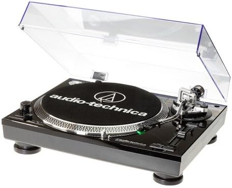

You can use a turntable with USB output e.g. the Audio Technica AT-LP120USB HC.
Correct. It’s only an mp3 stream. I couldn’t make a flacstream out of it.

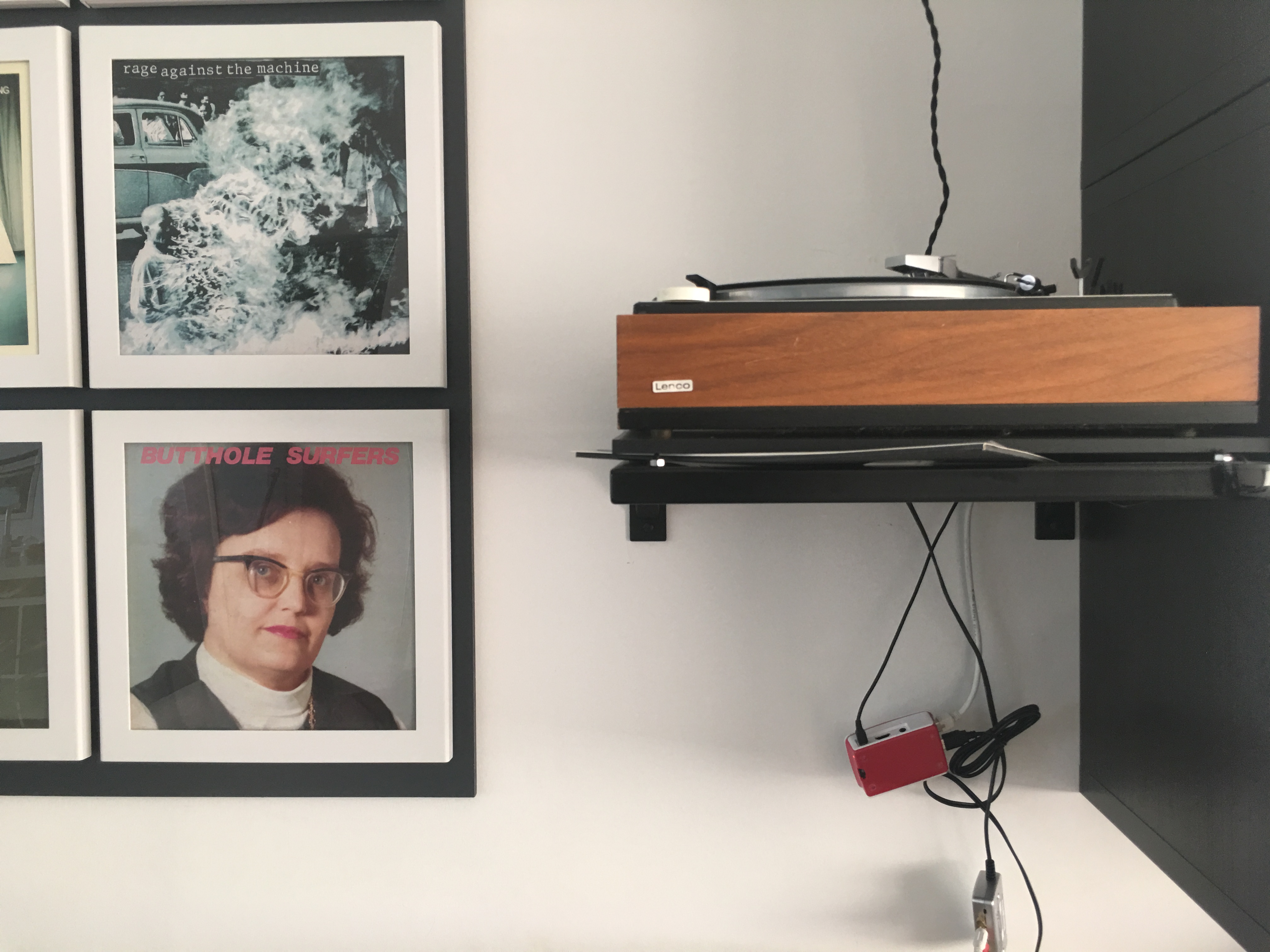

An update here: I am now using a ESI USB soundcard to capture the incoming turntable signal, and a old Mac Mini (2009) running Ubuntu Server is serving the signal to Roon with ffmpeg and icecast2. Some latency, but works great!
Just curious, are you doing RIAA equalization on the Mac Mini? If not, your audio quality is seriously compromised.
Well, no. I feed the soundcard line level input from the phono amp. Then I capture the sound in realtime with ALSA and FFMPEG and send it to Icecast2, which streams FLAC to Roon.
is probably applying the RIAA equalization.
Of course
Mofi StudioPhono. Not the most high-end in the world, but works for me.
