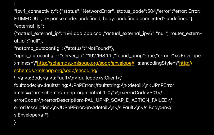

I have changed my ISP to Gigaclear who have provided a Linksys MX5500 router/mesh system. Roon operates fine, but I cannot access ARC. I have followed the online help and suggestions and tried the following. I have ensured upnp is active and I have tried disabling it, reactivating it, and restarting the router. This does not solve the connection issue. I have created a port forwarding rule for Roon ROCK, restarted the system and tested again, but Roon still states ARC is not ready and was unable to securely access the Roon server. I have also temporarily disabled the ipv4 and ipv6 firewalls, but again this does not allow access to the Roon server. The below is the information given in the diagnostics data box:
"ipv4_connectivity": {"status":"NetworkError","status_code":504,"error":"error: Error: ETIMEDOUT, response code: undefined, body: undefined connected? undefined"},
"external_ip": {"actual_external_ip":"194.aaa.bbb.ccc","actual_external_ipv6":"null","router_external_ip":"null"},
"natpmp_autoconfig": {"status":"NotFound"},
"upnp_autoconfig": {"server_ip":"192.168.1.1","found_upnp":true,"error":"
s:Client
UPnPError
501
PAL_UPNP_SOAP_E_ACTION_FAILED
Any assistance you could provide would be much appreciated.
It looks like, for some reason the uPnP request to setup the Port Forwarding in the Linksys router is failing for some reason.
It may be that the port being requested is already in use. You could try changing the port used by ARC to something like 55500 (more or less anything in the range 1025 to 65535). See Roon->Settings->ARC.
If this does not help, you could try setting up a manual port forwarding rule in the Linksys router to forward all connection on the ARC port to the Roon Server ip address.
If you do this, and it works, then:
  • If you are not using uPnP for anythingyou should consider disabling it.
  • You should probably consider setting up an ip address reservation for your Roon Server in the DHCP settings of your Linksys Router so that the ip address allocated to the Roon Server does not change.
Note: I prefer using DHCP reservations over a true static ip address (which would achieve the result as far as the port forwarding rule was concerned) because it makes changing the LAN subnet configuration ( as may happen, for example, when swapping a router for one supplied by a new ISP) simpler.

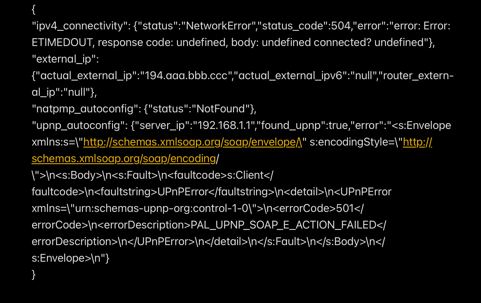

Anyway, this is the ARC connectivity diagnostic as it stands:
Thanks again for your assistance
As I said in my post above, the diagnostic text does not seem to indicate an issue with Multiple Nat. You router is obviously using NAT - this is as it should be. But there is no direct evidence that your ISP is using CG-NAT. That was just one thing that you could investigate. You will sometimes not be able to tell if your ISP is using CG-NAT. The only indication that usually (but not always) occurs is if your routers WAN ip address is in the range 100.64.0.0 to 100.127.255.255 which yours does not appear to be.
The diagnostic text above seems to indicate that your router does not like the uPnP request from Roon Server. This is not unknown.
Your best best is to turn off uPnP (in your router settings) and then add a port forwarding rule manually.
