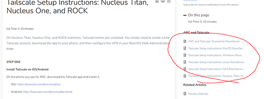

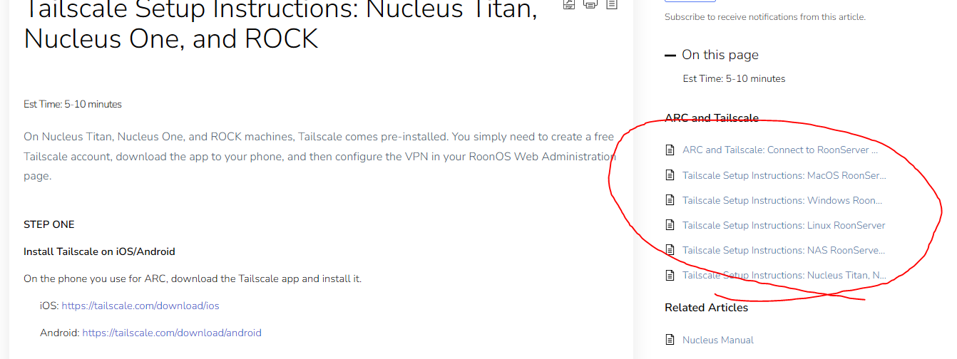

I would guess that this is the issue. I believe this is one of the reasons Roon worked on getting TailScale support implemented.
Here is the setup instructions for Nucleus:
There are several other setup instructions in the sidebar of the above link if you need them.
