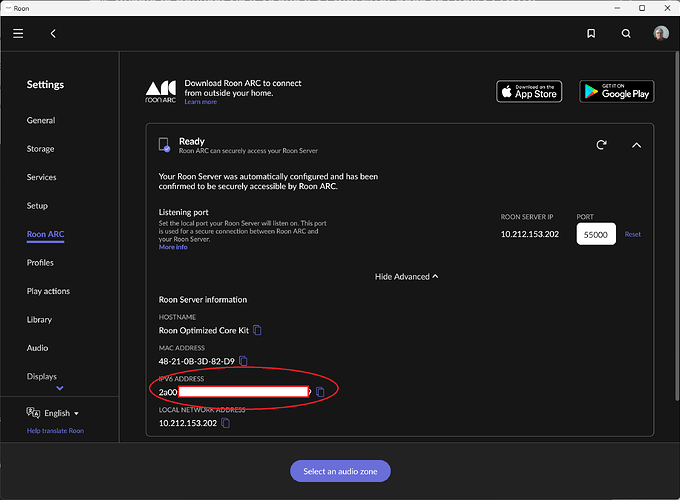

If enabling uPnP does not work, you will have to create an ipv4 port forwarding rule on your router to forward the Roon ARC port (as seen on the Roon → Settings → ARC page) to the roon server ip address (also seen on the ARC settings page) for TCP. You do not need to forward UDP traffic.
If you want to get it to work for ipv6 as well as ipv4, then you will have to manually configure an ipv6 firewall pinhole. In the ip v6 firewall settings you will need to configure an exception to allow TCP traffic to the ARC port destined for the Roon server ipv6 address to propagate.

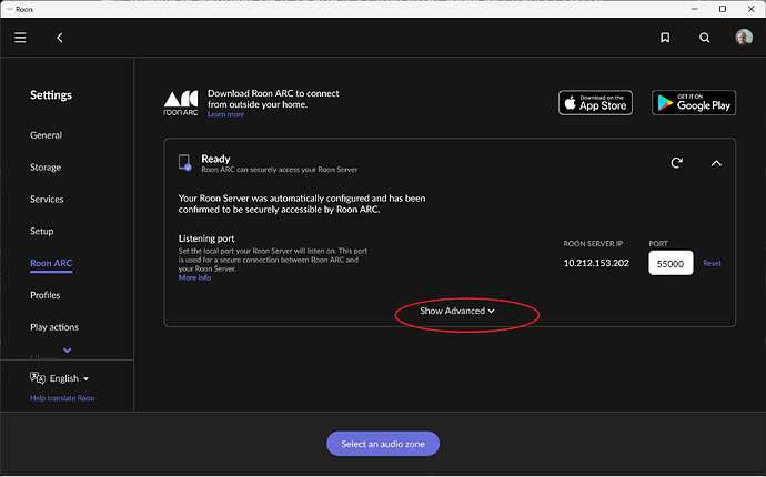

You can find out your ipv6 address from the advanced information available on the ARC settings page:
You will then see something like (my full ipv6 address is masked):

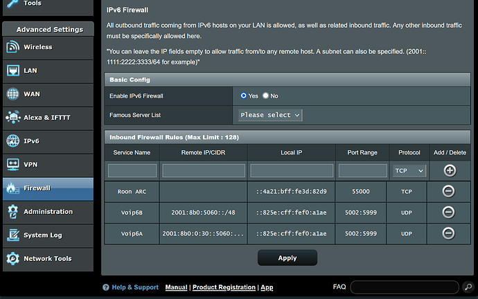

I use this technique on my Asus router and BT broadband in the UK who issue a dynamic ipv6 prefix - so my router ipv6 firewall configuration (for Roon ARC and my VOIP phone service) is:

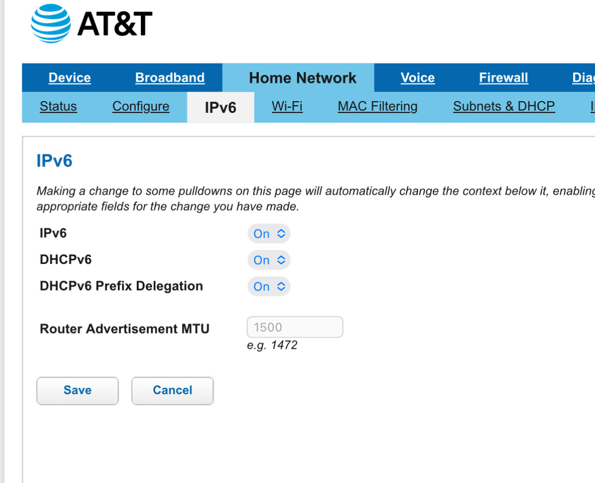

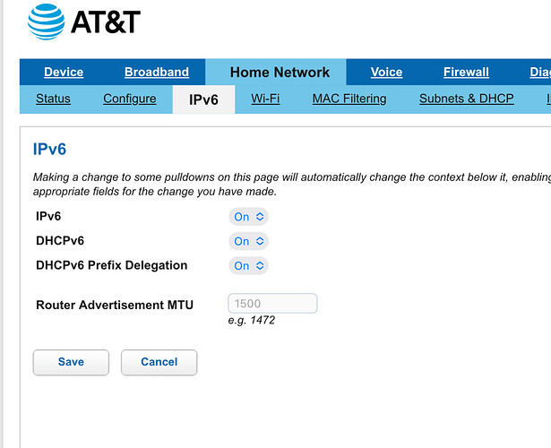

I have asked about that in a previous thread, but I had a different problem. Your suggestion was to use my Mesh (TP-Link Deco) as an access point only. That is what I did, and the message I sent yesterday was the one I relayed to you.

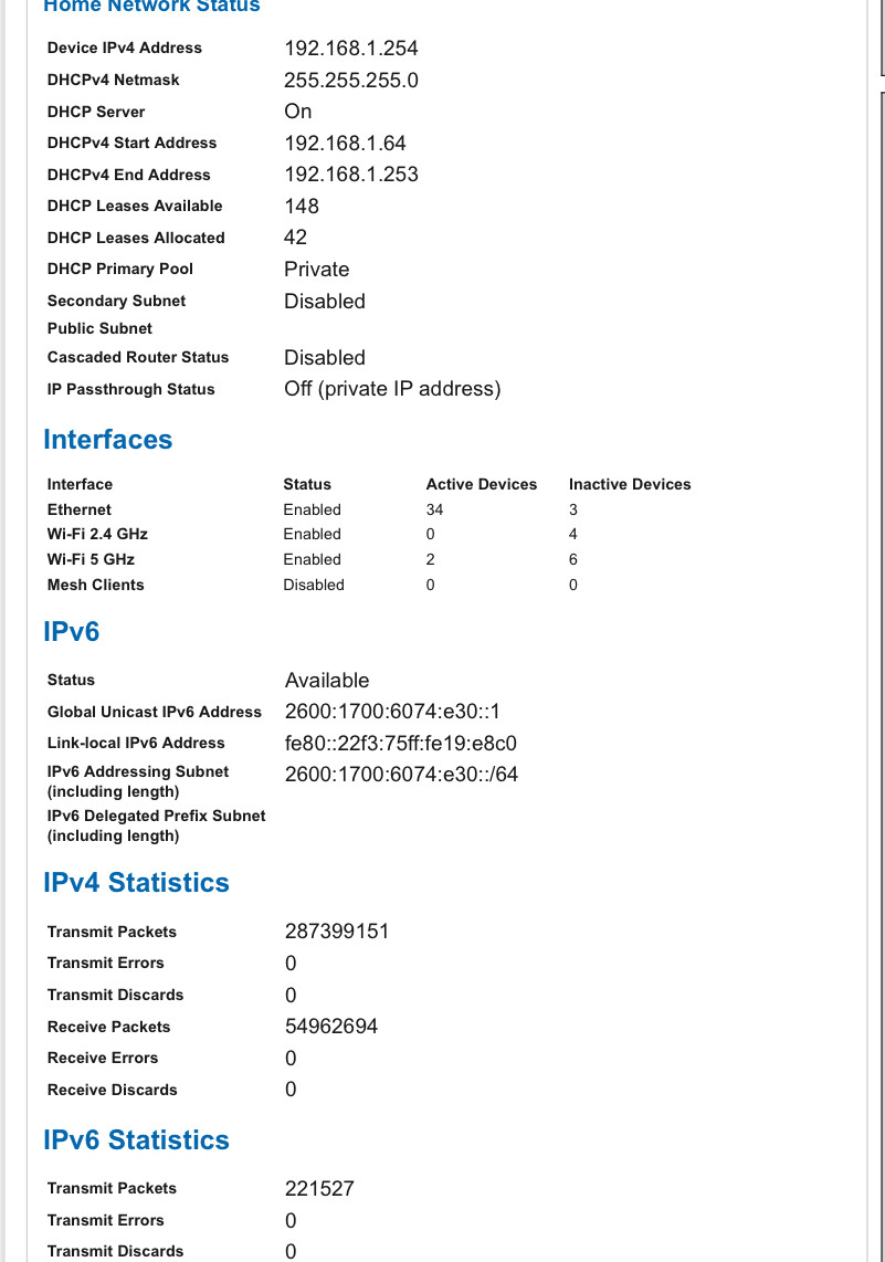

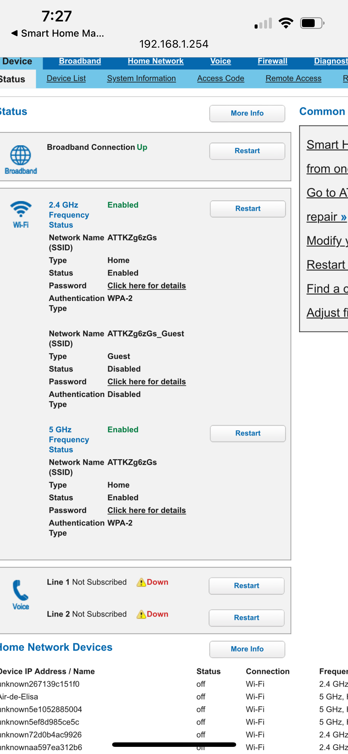

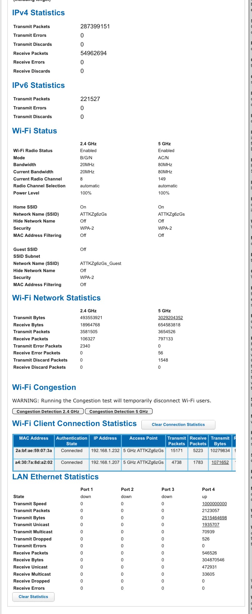

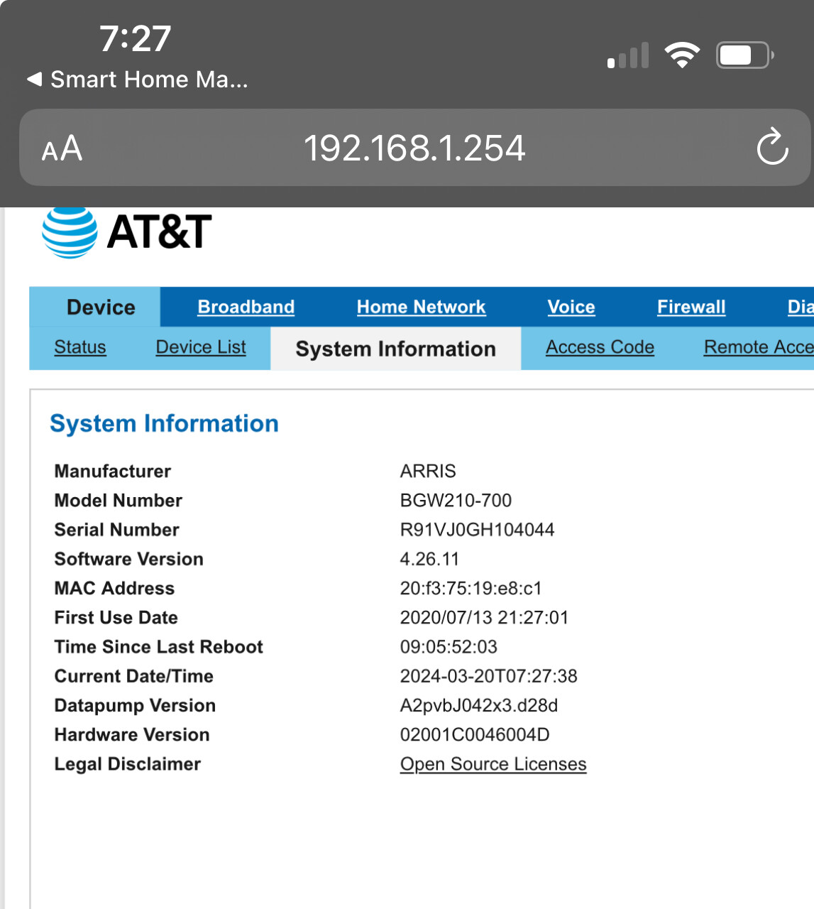

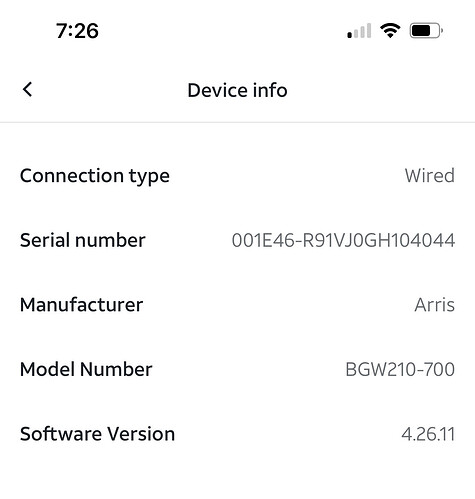

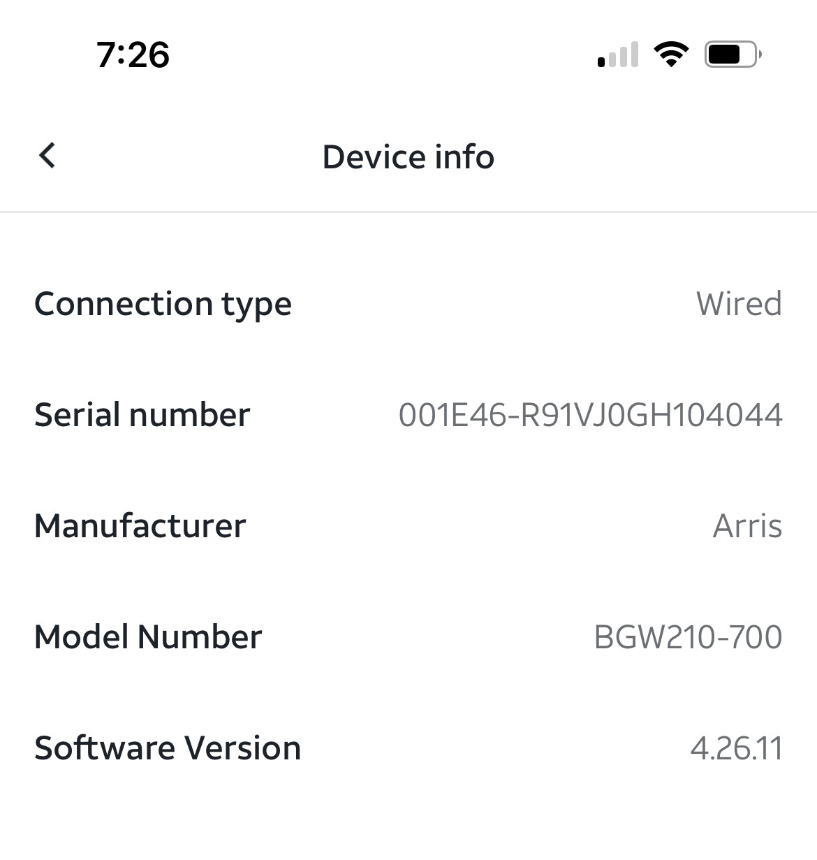

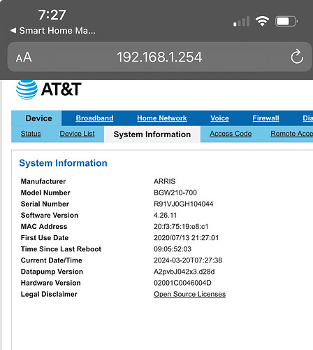

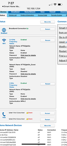

I went to my ISP modem
and tried to get a profile of the system. Here are screen shots of my ISP modem, maybe could help you

OK. So it looks as if you have solved the MultipleNat issue that you originally had in the thread at:
But now you need to set up the port forwarding on the AT&T router. You no longer need to worry about the Tp-Link DECO since that, now that it is in Access Point mode, is no longer involved in the allocation of ip addresses and does not do NAT.
The lan side ipv4 address of your AT&T router is 192.168.1.254 so the ip address of your Roon Server should be 192.168.1.x where 1 <= x < 254. In fact, if your Roon server gets its address from DHCP, then 64 <= x < 254 because the router is set to issue ip addresses from a pool of addresses starting at 192.168.1.64 and ending with 192.168.1.253.
I found a post at How do I turn on my uPnP that states that AT&T routers (gateways) do not support uPnP. If that is the case, your only option for a ipv4 solultion is to use a manual port forwarding rule. I found this article on AT&T’s support site which may help you. It is for a BGW210 modem/gateway which I believe is made by Arris.
That should help you get ipv4 port forwarding to work - which should be all that you need for ARC connectivity.
I would try to get ipv4 connectivity working before worrying about ipv6.
This is because, as soon as you get one working, and Roon Server successfully uses it to establish ARC connectivity, it ceases to generate the diagnostic information relating to the other connection method. Ipv4 connectivity is generally still more useful than ipv6 (I have ipv6 connectivity working - in the sense that I don’t get an error when I turn off the ipv4 port forwarding rule - but I can not use it because my phone network provider does not offer ipv6 connectivity).
Once you have ipv4 connectivity working, you can either stop there or you can go on to configure the ipv6 firewall to allow ARC port TCP traffic to the Roon Server ipv6 address through. You will almost certainly do this through the ‘Firewall’ page of your Router. Unfortunately, I can’t find instructions and/or screen shots showing how to do this.
