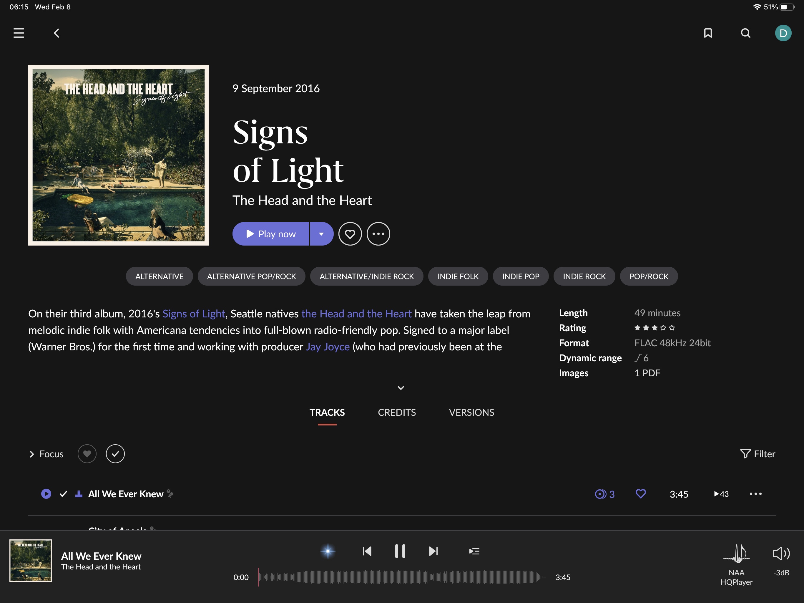

Greetings! After several weeks of success, I seem to of lost the ability again to play any music via HQ player and NAA b/t my Sonicorbitor i9 and my Ultrarendu into my Oppo 205. The Roon ready function on the ultrarendu works fine—listening to it right now in fact. But every time I’ve switched into HQ player and NAA it looks like it’s going to start playing as in the pictures previously posted above, but nothing happens. It just sits there And no sound is produced even though roon ‘lights up” and seems to try to start. I’m not sure if I have some thing wrong with my settings again or if this is some sort of network issue. I have tried setting my Eero router both on and off IPV6 but it doesn’t seem to matter which way I have it set I can’t get sound either way. I have tried both SDM and PCM without success. Any help would be much appreciated! Settings screenshot attached!

You seem to already have log file enabled. It is good to check the log file (/log URL in web interface). First attempt to play from Roon and then check the log file around that moment. Errors lines are prefixed with ‘!’ or "!’ marker character. Warnings or unexpected behaviour are marked with “?”.
Usually IPv6 works regardless of router settings. Router doesn’t need to know about it, when there’s no specific IPv6 infrastructure, the protocol stacks just fall back to automatic local network addressing. IPv6 can also occupy entire IPv4 network and operate through compatibility addressing.

The configuration file section for HQPlayer’s loudspeaker layout (aka channel balance) processing has become corrupted. Are you using the speaker setup feature? If so, please check the values there. Or if you are not using it, disable this feature.
If it doesn’t recover, you can edit the “<speakers>” element in /etc/hqplayer/hqplayerd.xml file. Please email a copy to me, I’m curious which way it has gone wrong.
