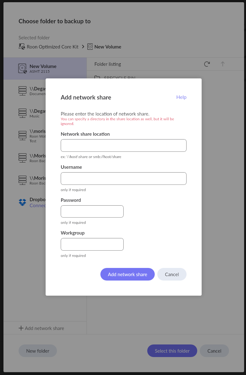

Are you using the correct steps to add your backup folder? You are NOT adding a Watched Folder (used for accessing music files), but adding a Backup folder, so you should be at a screen that says “Choose folder to backup to” and clicking the “Add network share” button should bring up the Add network share screen. It should look something like this:
yes, i’m exactly where your image suggests i should be: choose folder to backup to → add network share. then

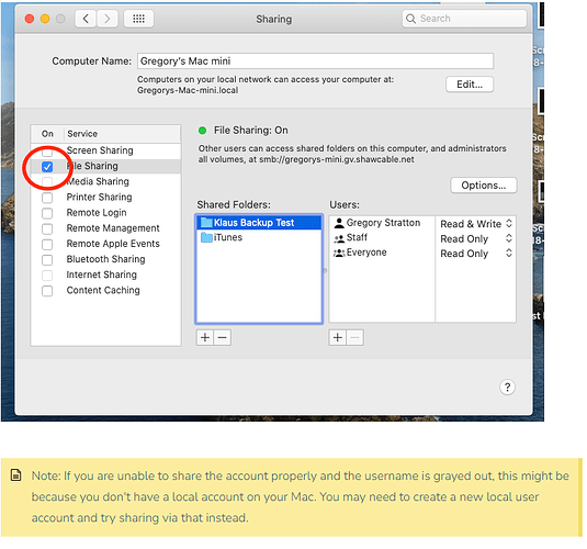

Perhaps you can show a screenshot of the Sharing screen of your Mac? It should look something like this, I think (I’m not a Mac user):
Aha! File sharing is turned on, and the RoonBackups folder in /Volumes/s4 is shared with read/write permissions for everyone.
However, the only shared folder I see in the filesharing screen is stevan apter’s Public Folder, which gives read&write permissions only for stevan apter (i.e. me).

If MacOS is similar to Windows, then you need to give read/write permission on the folder to a specific user - not to “everyone”.
What many of us do is create a local account called roon (or something similar) with a unique password and use that for shared folders (Watched and/or Backup folders).

I think your problem is that stevan apter may not be a local user account. Try creating a specific local user account (roon) for the folder…
Right, so why haven’t you added it to the list of users who can read/write to the RoonBackups folder?
And if you look at my screenshot earlier please read the warning about needing a local account - I see a ghosted stevan apter in your screenshot.
