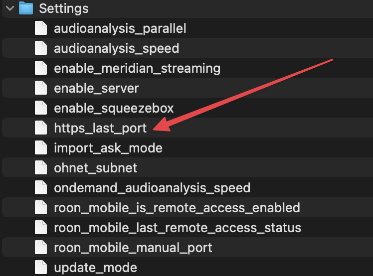

But since Proton always assigns a random port when a new connection is initiated I would like to update the port dynamically. I currently have a script that gives me back the open port and I can see that in RoonServer “Settings” folder there is a file for the port that is assigned named: “https_last_port”, updating this file with the current port I get from my script works but only after I restart my Roon Server, is there a way I could force a refresh after updating that file?

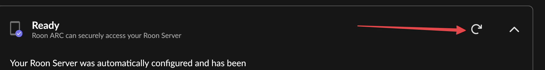

I am taking this approach because each time a connection is lost a new port is assigned and I need to manually check which one it is and add it on Roon ARC settings, ideally I would be able to just replace the port that is written on the file https_last_port with a “echo $port > https_last_port” and force a refresh on the server to re-read that port like it is done on the user interface via the refresh button.
restarting the server after https_last_port is updated works but I was wondering if there is a way to do it without having to restart the server. The server is currently running on my laptop and not on a machine that I could just setup and forget.
