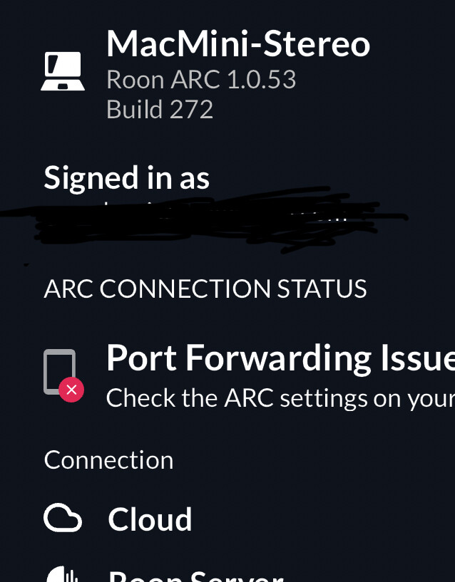

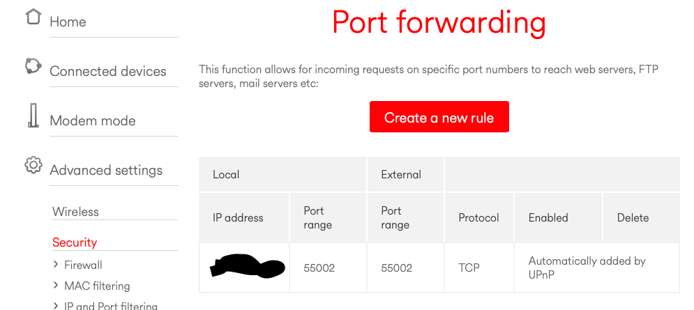

Roon config has enabled UPnP to created Auto port forwarding on my Virgin router - port 55002. Roon server says "Your Roon ser

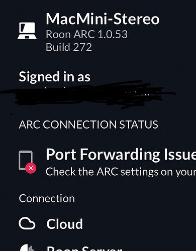

Port Forwarding was auto configured and has been confirmed to be securely accessed by Roon ARC. However on the iPhone, I can see Roon ARC working great - so long as I am on same WifI network on the same network as the Roon Server. Once I switched to data network, on iPhone I get the red dot on the Roon Server "port Forwarding Issue" So the error seems to be comms from iPhone to server, via data network. Virgin Media Hub 5, Silent Angel Network switch.

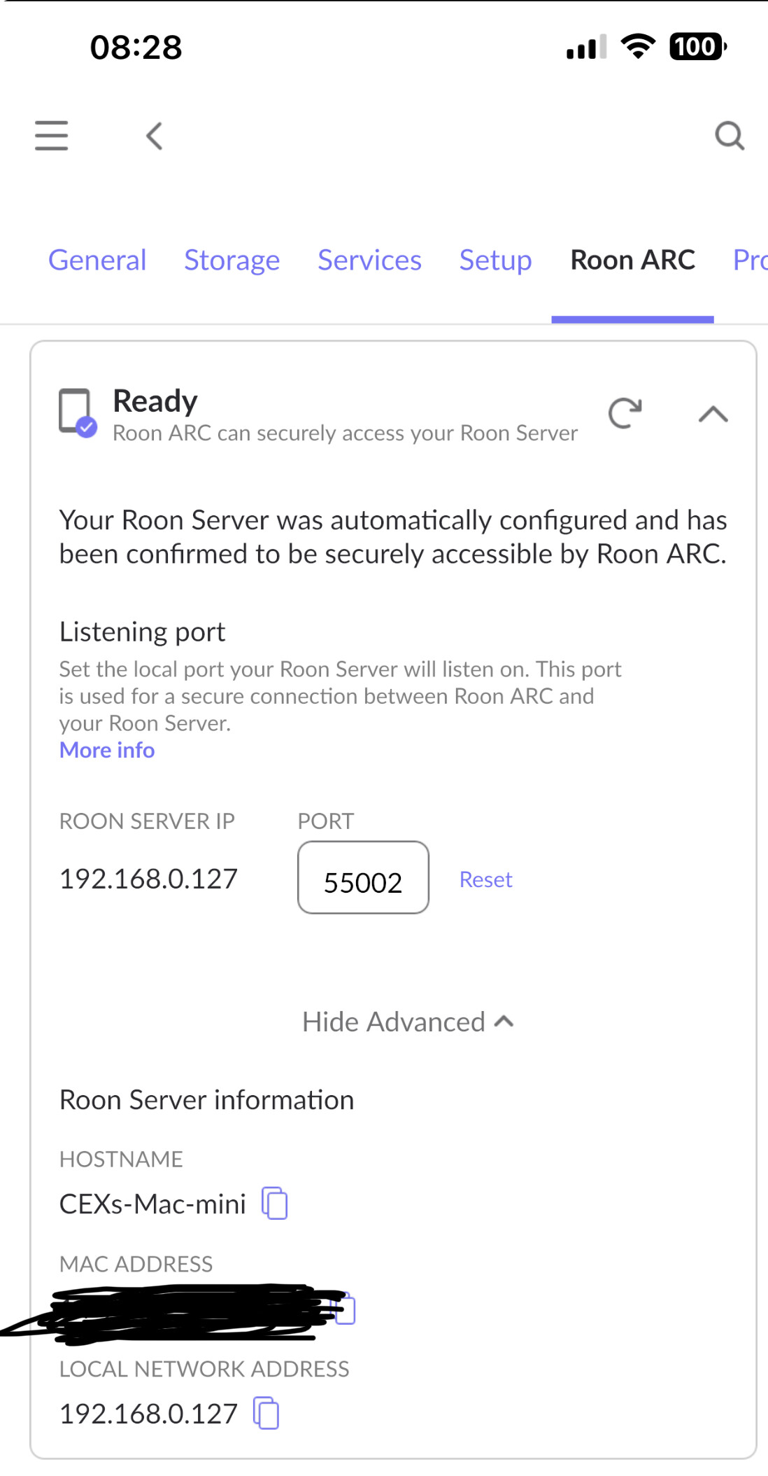

With regard to your port forwarding issue, can you post a screen shot of the Roon ARC settings page in an ordinary Roon client (desktop or phone/tablet)?
You say ARC is working on your local network (phone on hkme WiFi). This is expected and basically confirms that you local network configuration is good (or at least good enough).
Probably not relevant but I am assuming a wired connection between the VM hub and the switch and again between the switch and your Roon Server with the WiFi being supplied by the VM hub (no mesh WiFi systems in use).
Everything hard wired, with Cat8 cabling, no Mesh.
OK. Thankyou. It certainly looks like everything is OK from the Roon Server and Router end of the connection.

We’ve activated ARC diagnostics to identify the failure. Here’s what we’ve found:
  1. First, certain ARC services negotiated by RoonServer are failing because they can’t reach the upstream server in time. Do you have any security services or managed network software that might be filtering RoonServer’s connection? This isn’t the cause of the issue, but it’s likely exacerbating the problem.
  2. On the ARC side, there are session authorization failures due to cached associations with previous RoonServer instances or port assignments. Have you reinstalled the app since switching between RoonServer machines, by chance? It’s a heavy-handed step, but I’d start there.
  1. Not that I know of just a standard Mac build, nothing special on iPhone.
  2. Yes I tried deleting and reinstalling, both the Roonserver and the iOS ARC app. then resync on WiFi. On data network no access
