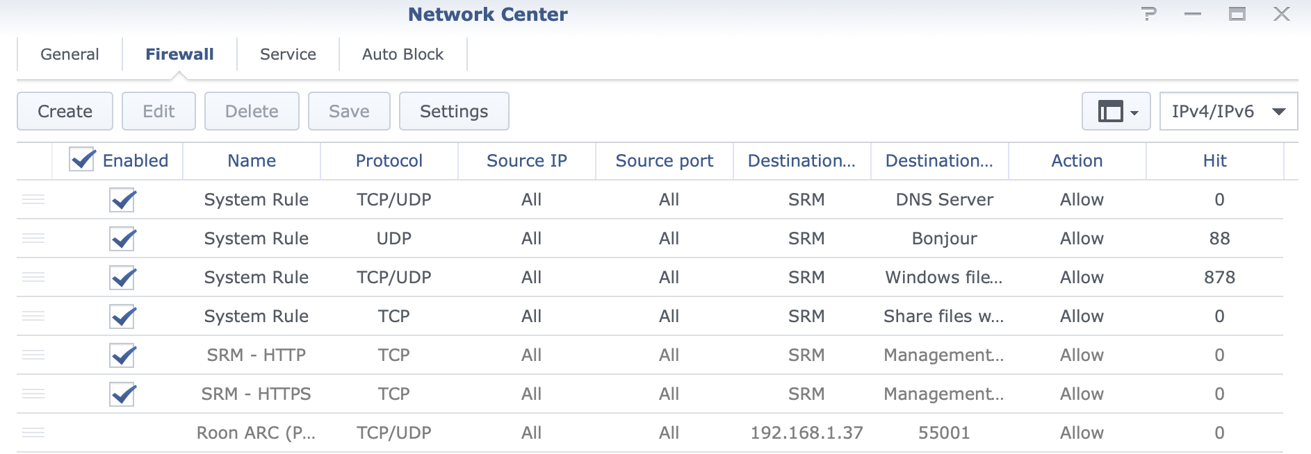

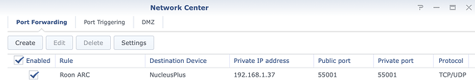

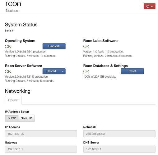

Welcome to the Roon community. Do i understand it correctly that you enabled UPnP on the router and created a manual port forwarding?
If that’s correct, could you post a screenshot of the UPnP setting and a screenshot of the port forwarding rule you created. At last also a screenshot from the Roon App under Settings → Roon Arc where the ip addres and port number are displayed.
Thanks.
Kind regards,
Maarten.
I think this is everything you asked for. Thanks for your help.
Hi @Herman_Gordon,
The rule you created looks fine in my opinion. I’am out of suggestions. I hope @support can help you further.
Maarten.

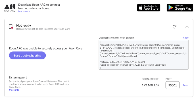

Edited: Saw the 4th screenshot now.
The IP and the port number in the Roon ARC settings are consistent with your rule on the router - so far so good.
However I am confused because the error message that is visible in the 4th screenshot is not the same one as you copied into the opening post. Which one is the one that you currently have?
This is the error message in the opening post:
“connectivity”: {“status”:“NetworkError”,“status_code”:504,“error”:“error: Error: ETIMEDOUT, response code: undefined, body: undefined connected? undefined”},
“external_ip”: {“actual_external_ip”:“64.aaa.bbb.ccc”,“actual_external_ipv6”:“null”,“router_external_ip”:“null”},
“upnp_autoconfig”: {“status”:“NotFound”}
This is from the screenshot:
I suppose the screenshot is the current one. In this case, your problem is this:
There is more than one network address translation (NAT) layer active, preventing port forwarding from working although your rule on the router is set up correctly.
Either your ISP is using technology to provide IP addresses that does not allow port forwarding, probably CG-NAT, or you have more than one router (or a router and a modem).
