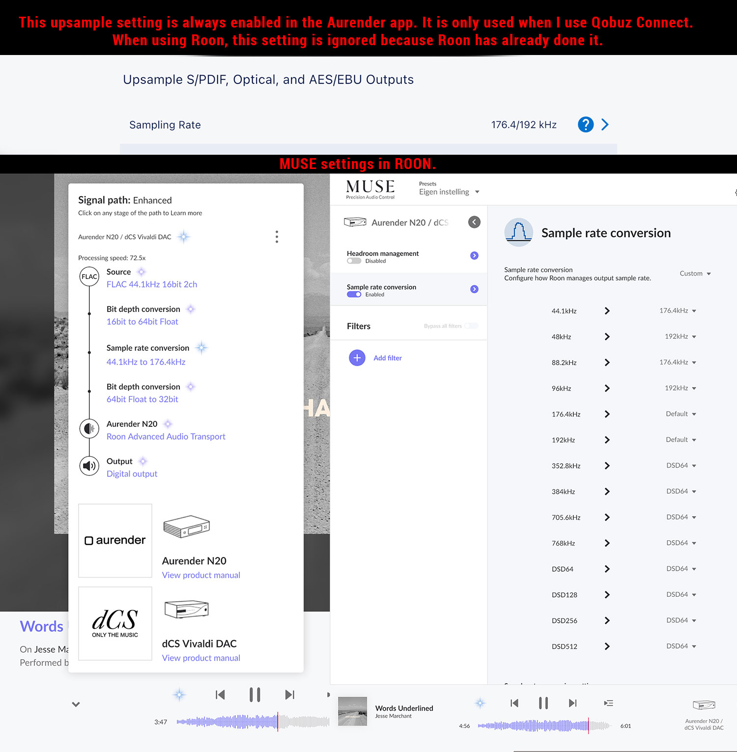

I may be totally off base, but I would check how I set up your endpoint in the audio section of Roon. Is the ‘Max Sample Rate’ correct?
It appears that the N20 is syncing to an external clock at 176.6KHz which is why it’s upsampling, from the source which was 44.1Khz. I assume that the 176 is the clock from dCS because you are using an optical cable and 176 is the optimal rate. The ROON green light shows that there has been a change in the signal path and tells what has changed.

Thank you very much for your contribution. This has become my final setting.
I would say there is no need to upsample within Roon if oversampling on the DAC is to such a higher level.
