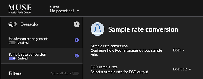

I have ROON/A6 (1st gen) flawlessly up-sampling to DSD512 via ethernet (albeit over powerline adapter which is really NOT recommended by ROON)
I am quite happy with this setup … so far so good!

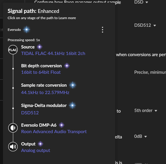

Can you specify how you connect your setup, from the Roon server, till the A6.
I have the Roon server conncted via mesh wifi netwok to the A6, from which I feed a TT2 dac via its A6 usb out
Please show your signal path as Eversolo capped its Roon support at 384/24 DSD256. This isn’t the first device to have less than stated specs when used via Roon due to stability issues. FiiO s15 is the same as are all their DAPs. Other streaming DACs also have this and only get max via using it as a DAC or via the internal player. To my knowledge this restriction is still in place for the gen 2 and no update was made to increase it.
Here you are:
In this case you are using the A6 as a DAC as well.
How and where in the chain are those powerline adaptors connected?
Thanks. Very strange and goes against what even Eversolo state.
He’s using its Roon Ready network input so the internal DAC according to signal path. Powerline adapters make no difference to a signal path they just convert network signals to travel over power lines.
Roon core (windows 11 desktop) on 2nd floor and A6 on the first floor connected via powerline adapter. Yes, A6 used as DAC. Mentioned powerline adapter to highlight the weakest link in the chain and thought up-sampled ā€˜512’ by Roon would not flow smoothly. That’s what I mean by ā€˜so far so good’

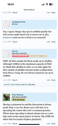

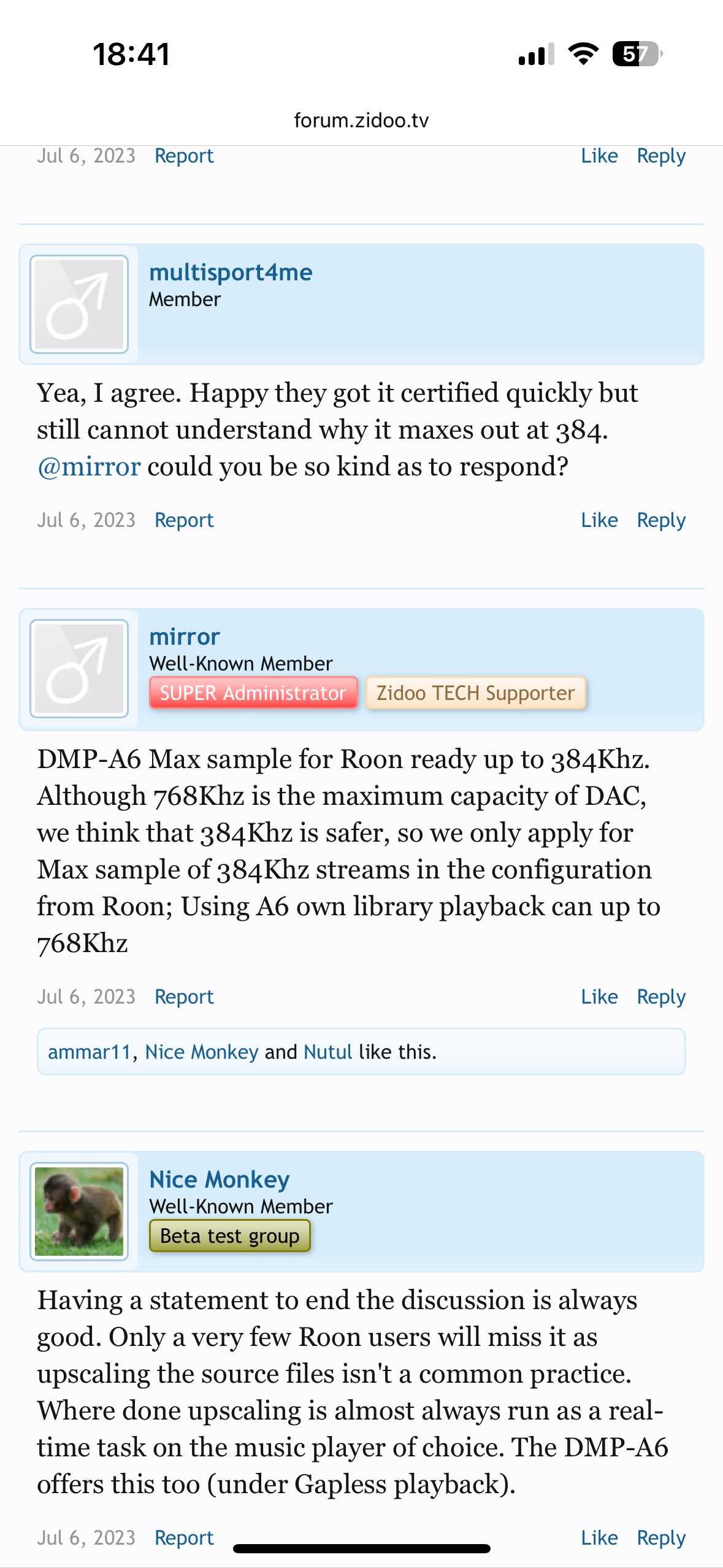

I asked Eversolo to confirm and they say it should support DSD512 using the internal DAC or to external if it supports it. Which is now in contrast to what they said back in 2023 which was an official support post on their forum. So they must have been changed the level of support in a firmware update.
