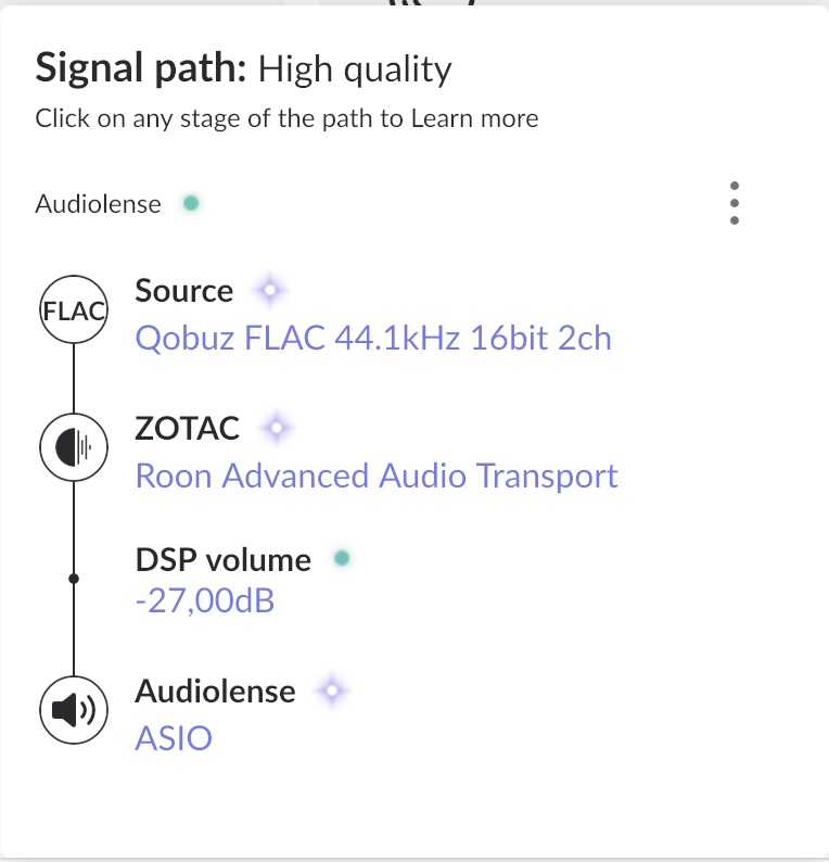

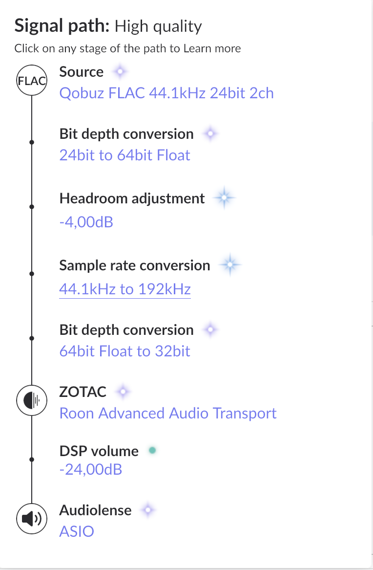

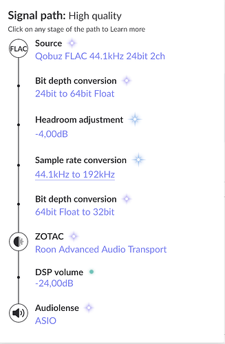

Here is my signal path with and without upsampling
My thought is that DSP volume should be less lossy in 32bit than it is in 24 or 16. But I am absolutely not sure if that is correct. This is why I ask :smiley:
I am not sure if I understand you correctly but I don’t gain but decrease the value. Or is that in this case the same?
It’s the same maths but with opposite signs :wink:
At what bit depth does your end point implement digital volume?
It very likely adapts to its precision of computing internally anyways, then definitely applies it’s own internal dithering algorithm - nothing you could positively influence with anything you do beforehand.
Sample rate upscaling definitely buys you nothing in terms of volume adjustment.
