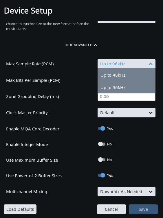

Thanks guys, but I’m getting no such options in that window. Is there some other setting I should shift to enable those options?
Don’t understand. Can you post a screen shot of Device Setup?
Sure, here is what I see, with no options for DSD upsampling from PCM.

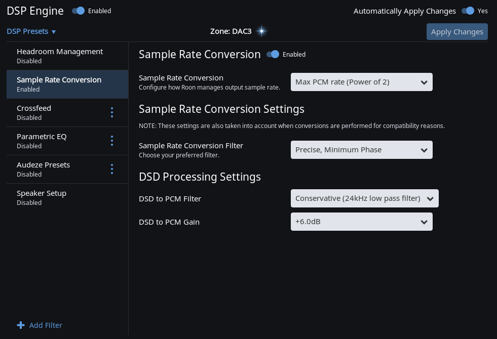

And under DSP engine, no such options either:

@Joe_Bandy, looks like you have the DAC3 in USB Audio 1.1 mode, which only supports up to 24/96 (not high enough to do DSD64 over DoP). You should be able to switch it into USB Audio 2.0 mode by holding down both of the input switching buttons for a few seconds. It may show up as a different device in Roon at this point, but you should be able to support higher sample rates once you’ve switched it over.

Excellent, that did the trick! I didn’t realize there were two different modes. Thank you.
