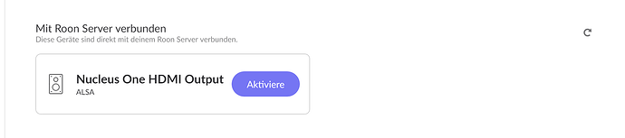

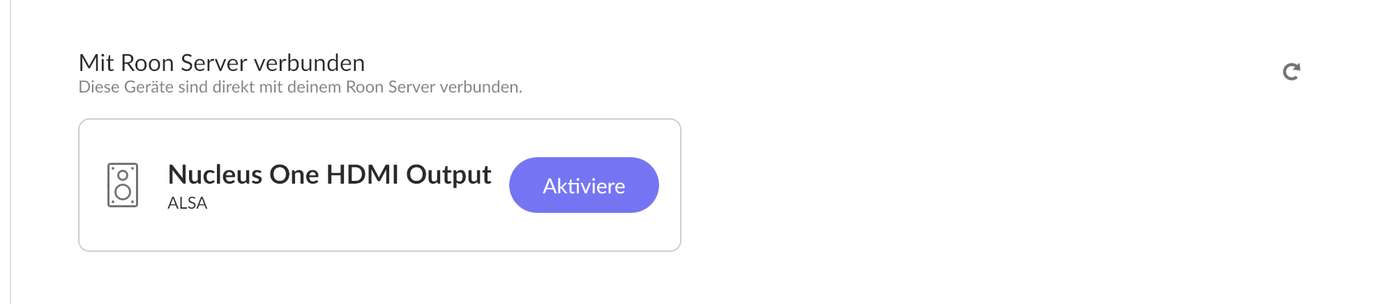

Hello, I would like to connect my Nucleus One to my streamer via USB. The cable is plugged in, and the streamer supports USB input. However, in the app, only the Nucleus’ HDMI output is displayed under Audio. Is a USB output even possible? Best regards

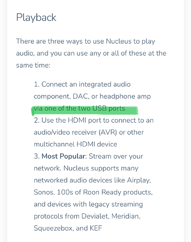

Yes it should be, from https://help.roonlabs.com/portal/en/kb/articles/nucleus-manual
No USB.

Shouldn’t the USB output be displayed regardless of the connection? There is no cable connected to the HDMI output, but it is still displayed.
Why would you want to connect an already Roon Ready network streamer by USB too? This just sounds silly to me. And no, USB outputs don’t just show regardless of connection (because they are multi purpose interconnects). Only if an USB audio device is connect, turned on and recognized (may require you to select tthe appropriate input on the device) it will show in Roon.

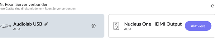

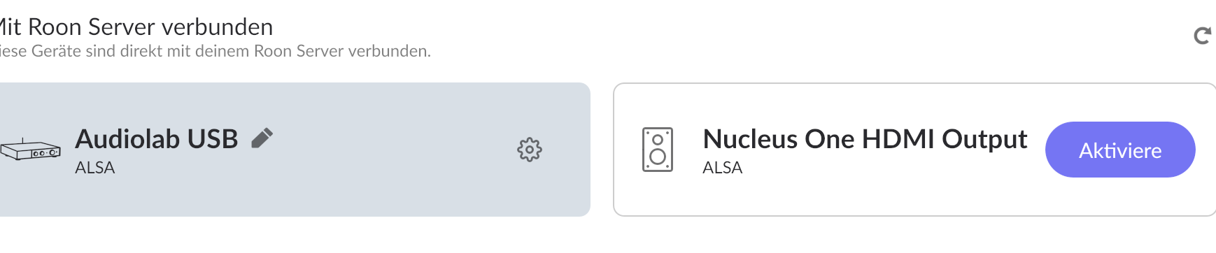

Just to confirm. Only one USB port on the Nucleus One can be used to connect a USB DAC.
As @BlackJack mentions, and I don’t recall differently, USB output on the Nuclues One will only show when the 9000n is connected to the USB-B port and the input on it set to USB.
YMMV
Works. Double rebooting helped.
