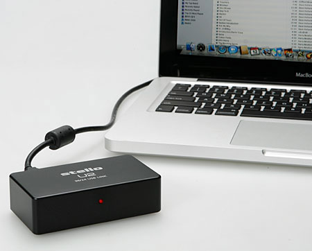

Not purely USB but USB to S/PDIF, examine these published eye patterns:
Now, setting aside any potential jitter – not relevant to asynchronous USB nor Ethernet – which eye pattern indicates superior demodulated signal recovery?
