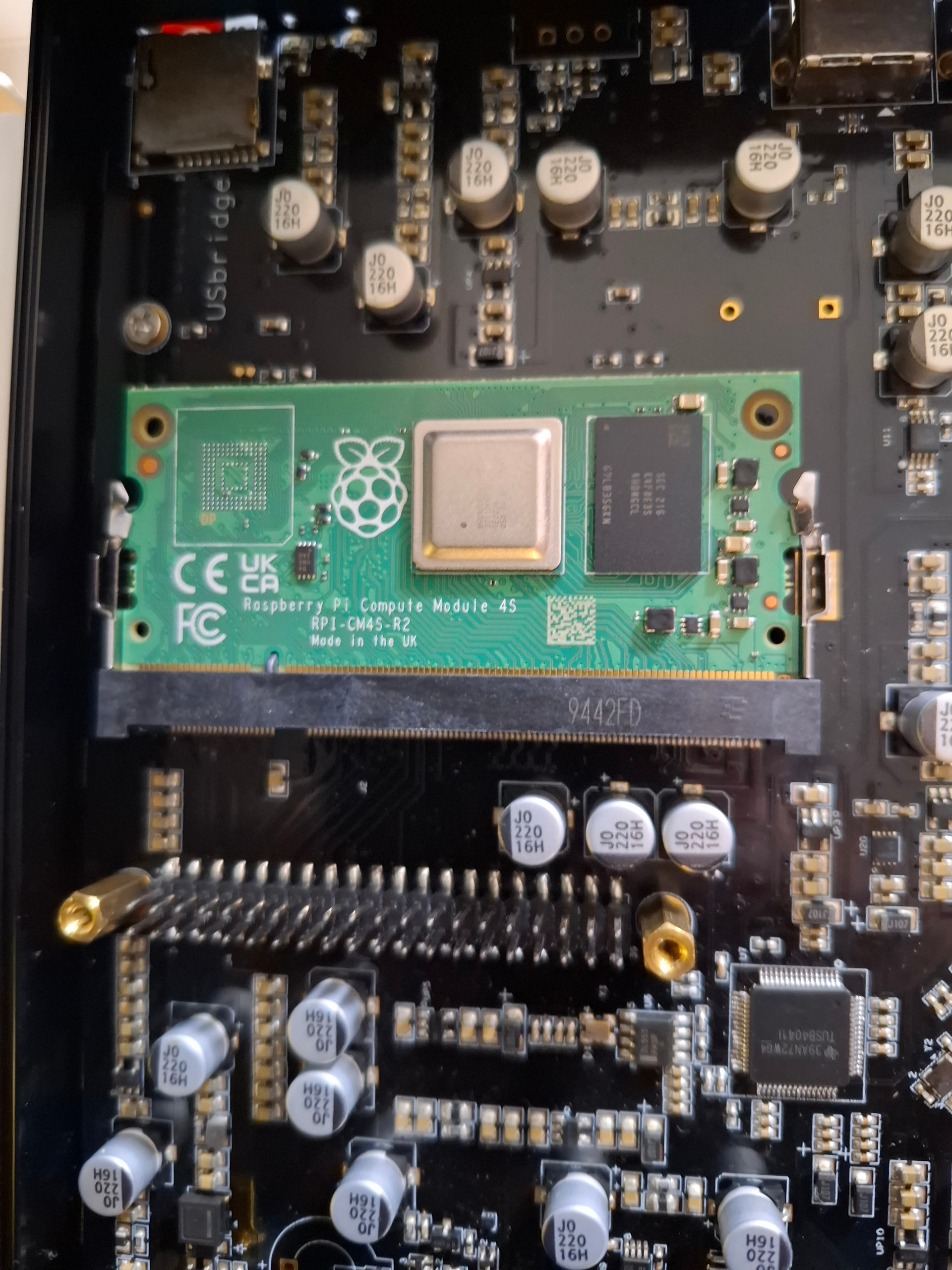

I realise this is very much an edge case but I am trying to run a Pi Compute Module 4 Lite through a CM4 - CM3 adapter in place of the CM3 on my USBridge Signature.
The hardware appears to be working fine and Ropieee actually boots up and runs through the first four configuration stages but then fails to find the network interface (just after to warning about making sure the system is connected to the internet). From reading around it seems that the CM4 grabs the eth0 interface which (presumably) is what Ropieee is looking for.
Is there anything I can do to sort this? It appears to be possible because at least one other system does find the network but I’d much prefer to use Ropieee.
Thanks
Alan

I could replaced with this module, not adapter, not soldering just plug and play. Running piCorePlayer and LMS without drama.
