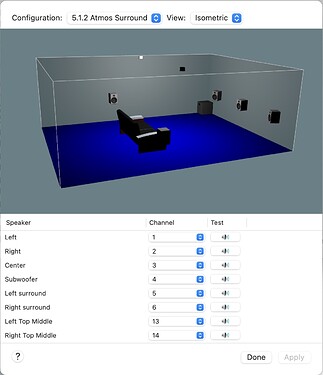

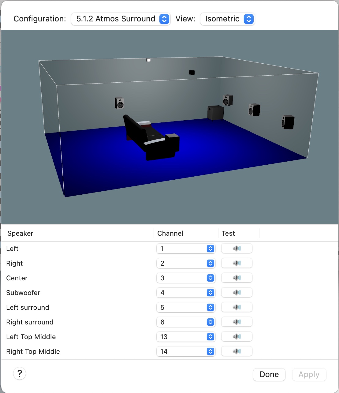

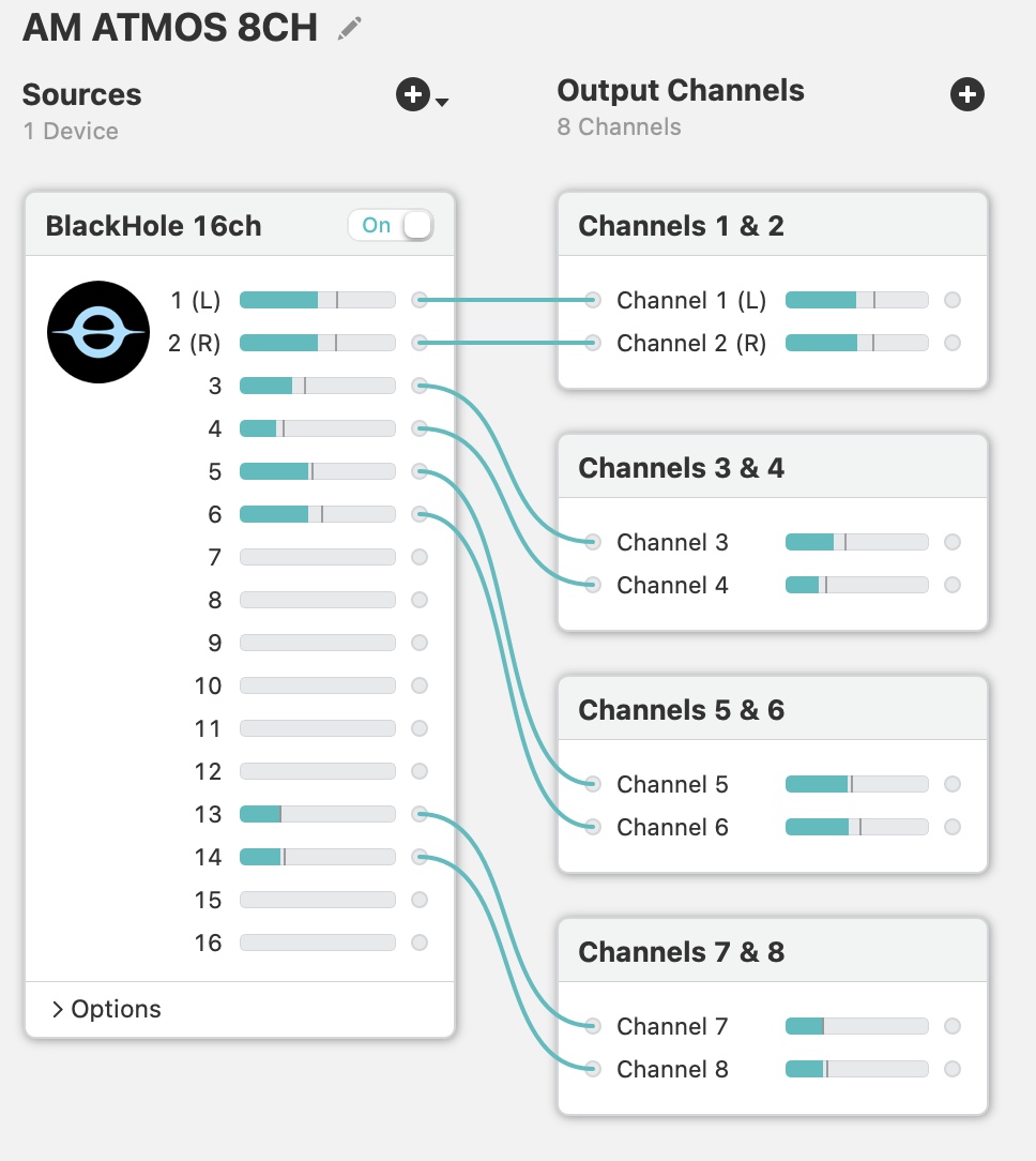

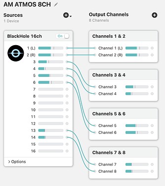

My 0.02… When using multichannel sources, on macOS you can combine BlackHole and Loopback to do the channel mapping. That will make life easier. (Don’t forget to change the input device name in hqplayerd.xml.)
For example, ATMOS 5.1.2 will map the 0.0.2 to ch13 and 14 by default (ch7~ch12 are reserved for ATMOS 7.1.4 by default). In Loopback you can patch ch13 and ch14 to ch7 and ch8, then using NAA send to Embedded server as 8 channels input.

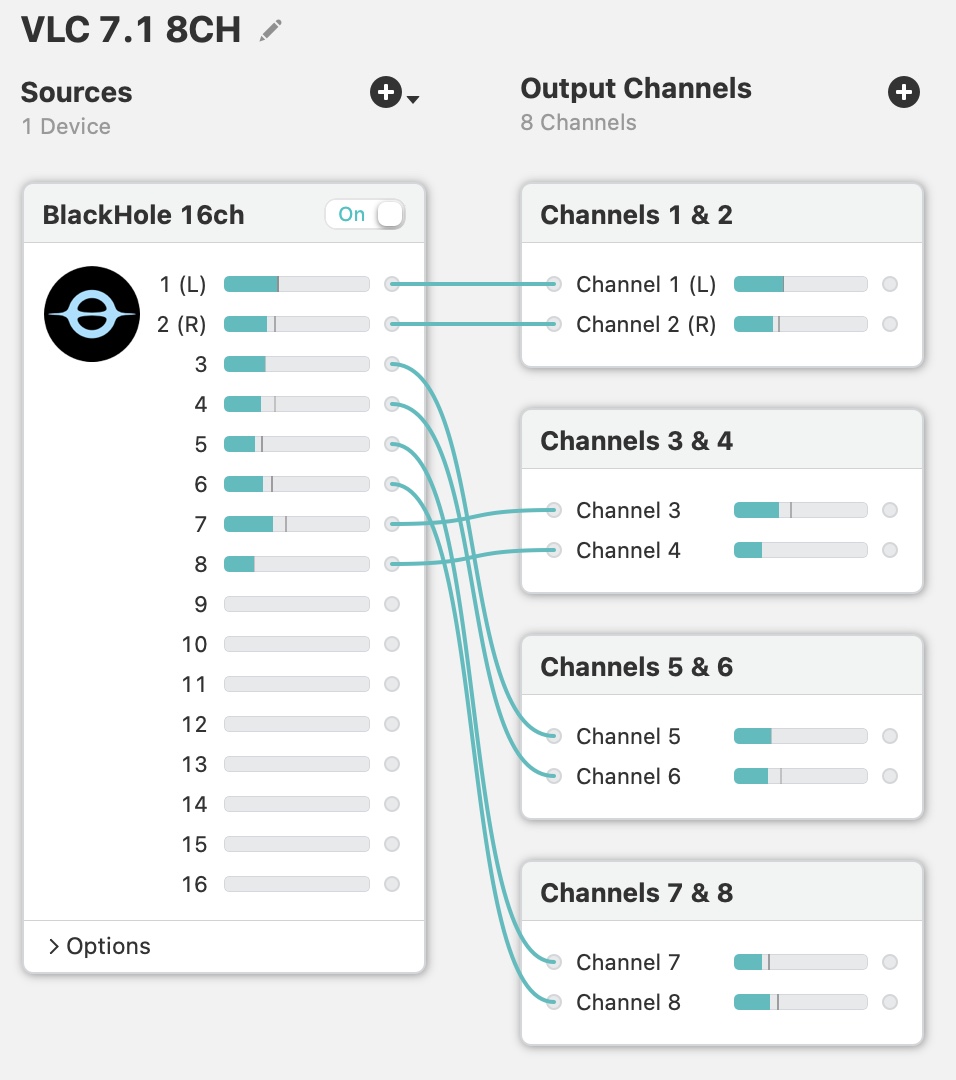

VLC’s C and LFE sometimes will map to ch7 and ch8 so you can use Loopback to re-patch to correct channel.

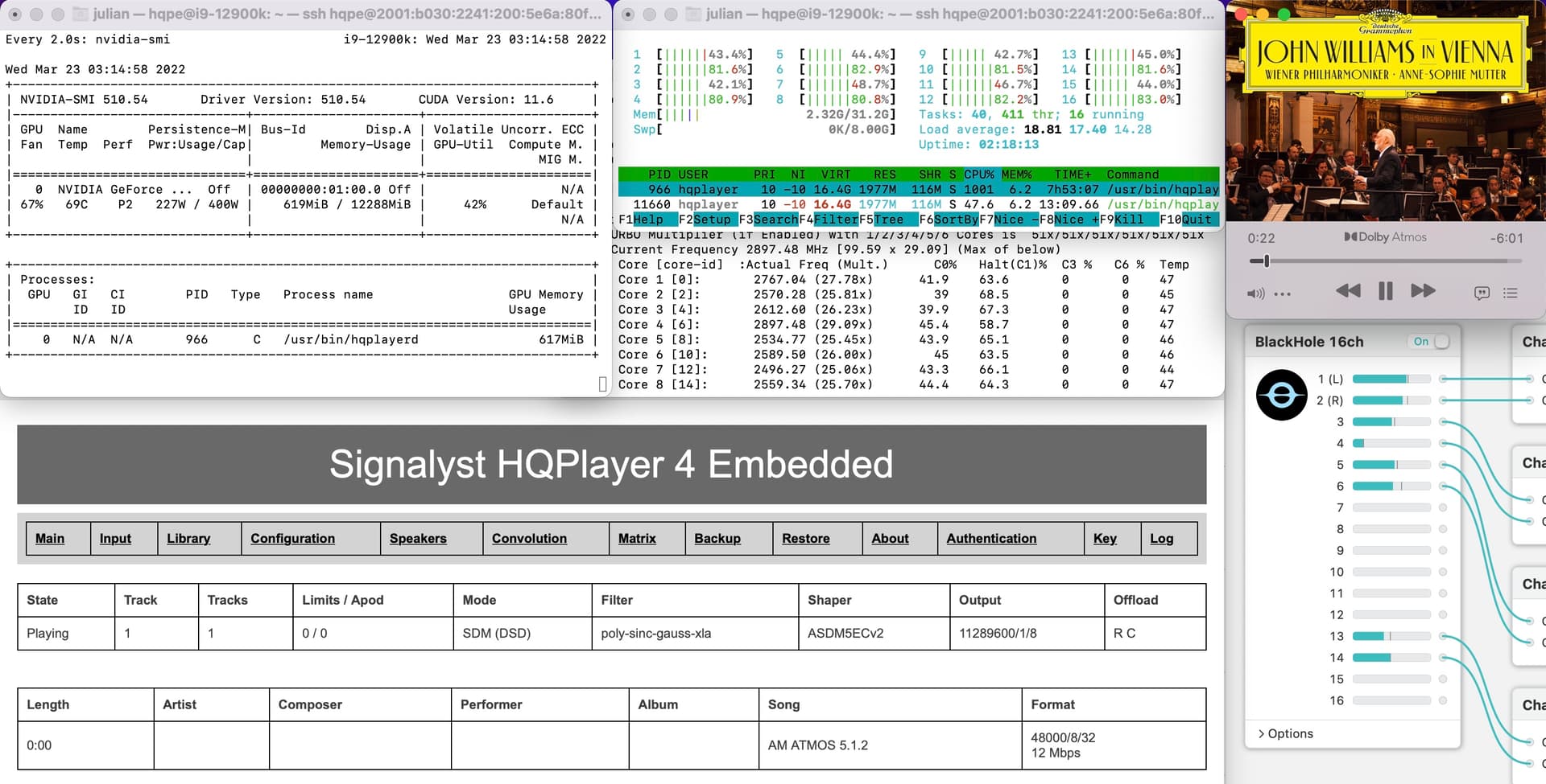

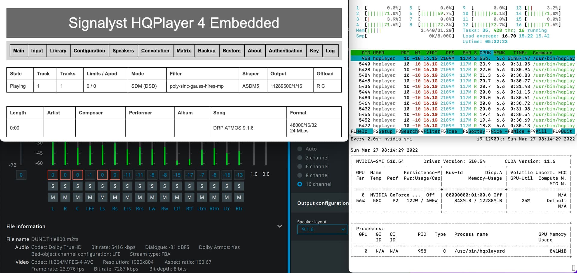

Since CA already posted the ATMOS-TrueHD project, I would like to share some tech info here:
  1. 12th Gen i9 12900K could do sixteen channels room correction and DSD256 upsampling with medium-load filters and non-EC modulators. Task/CPU distribution is a bit different than 8ch.
  2. ATMOS 5.1.2 eight channels doing room correction and DSD256 upsampling with heavy-load filters and 5ECv2 (for ESS chip), 12900K+3080ti works great. The CPU frequency is around 2.8GHz and temperature is around 70 deg C in average (I use fluid cooling system).
  3. DRP is just a QC tool not for playback. No full screen, no audio delay adjustment. On my system the audio delay is more than 1.5s… Not suitable for movies, sorry :frowning: But for music, DRP performs great! You can even change the speaker layout on-the-fly!
  4. The quality of Apple Music’s DD+ ATMOS is quite good. I couldn’t compare ATOMS-TrueHD vs DD+ ATMOS of the same album after HQPlayer’s extraordinary signal reconstruction for both format (I also use IR filters generated by Audiolense XO).
