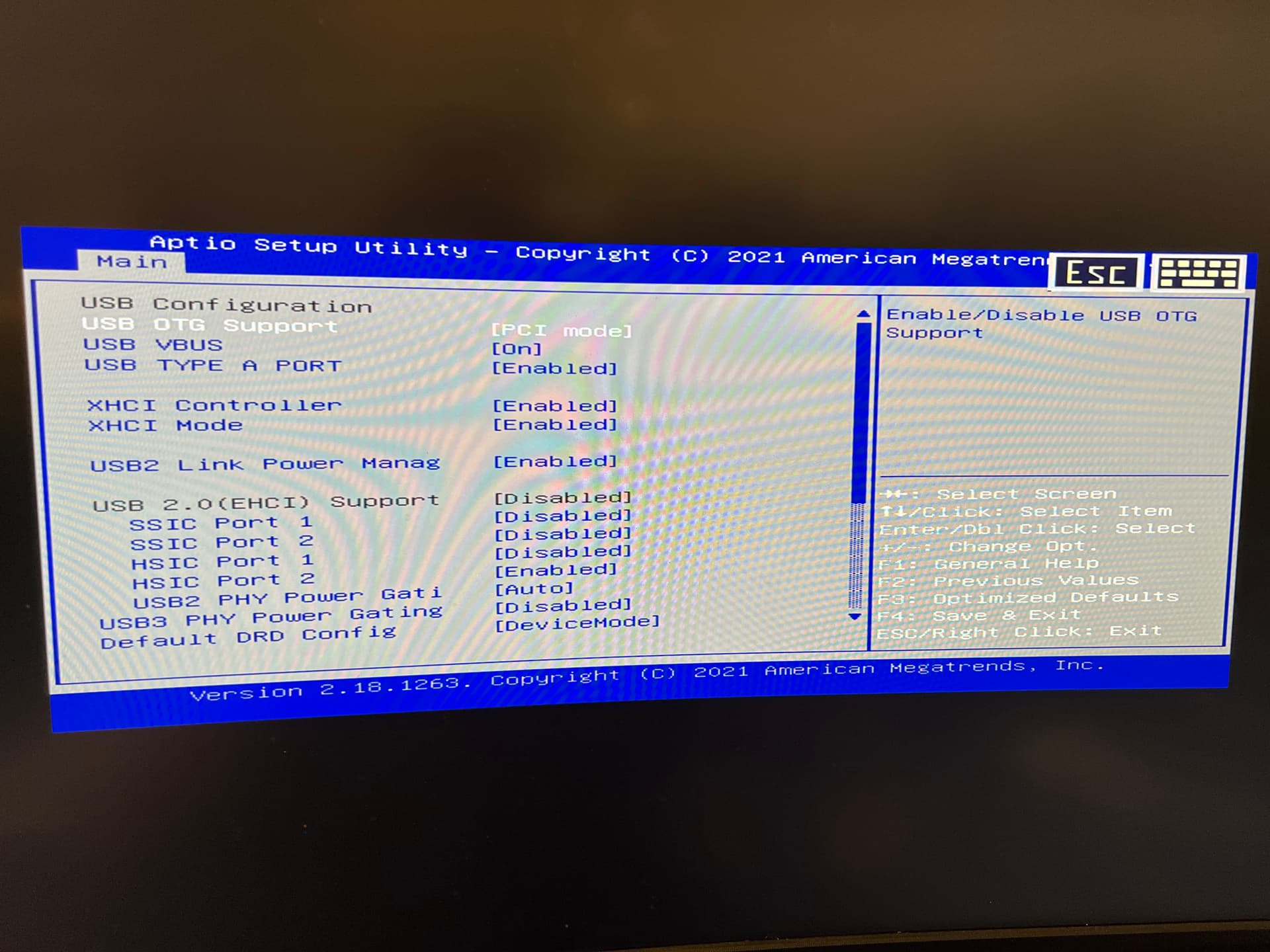

  1. USB port set to device mode in BIOS
  2. Playback from UAC2 started in HQPlayer
This should be enough for the device to appear at the host side.

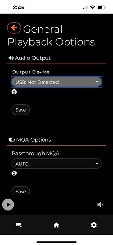

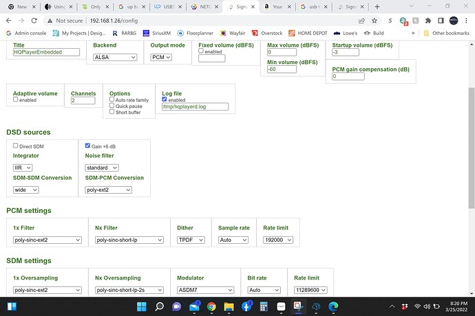

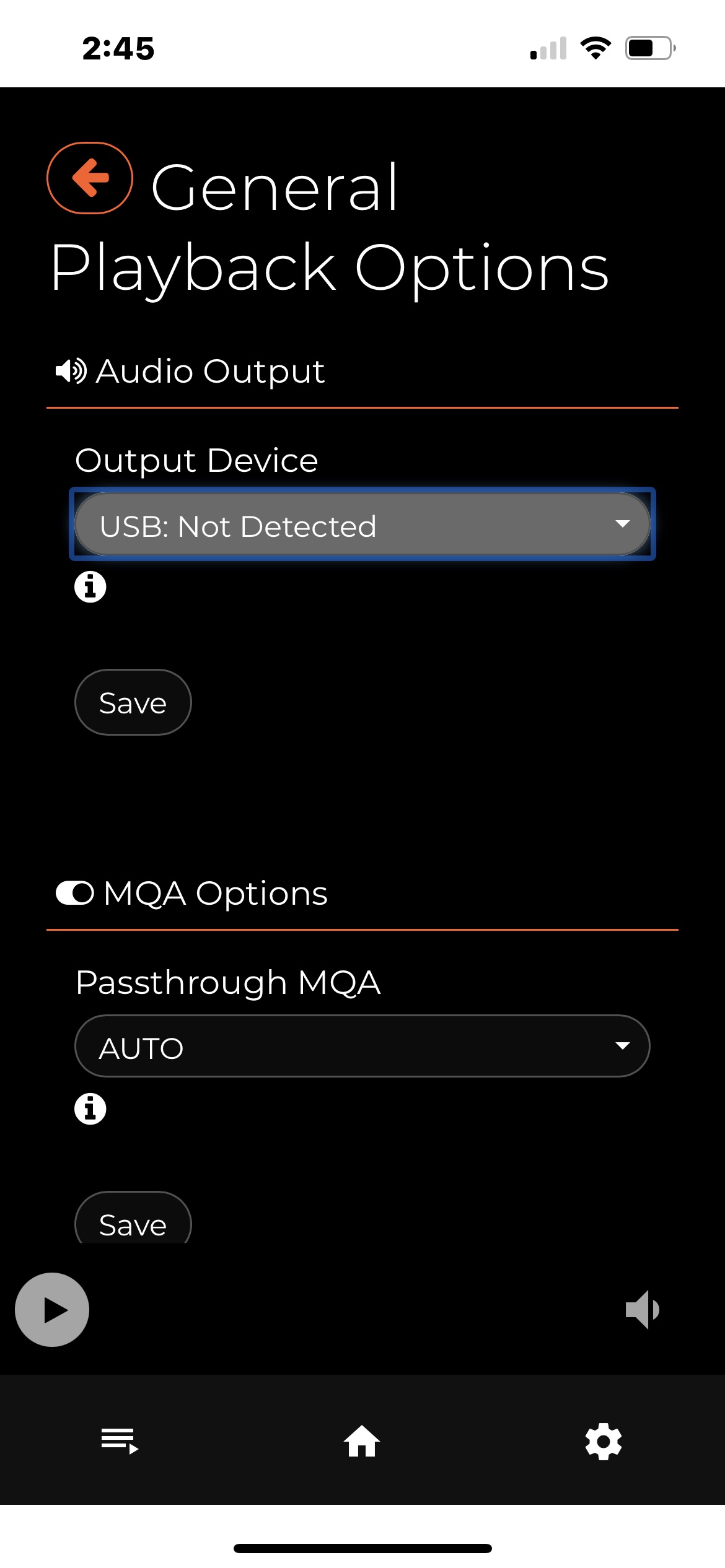

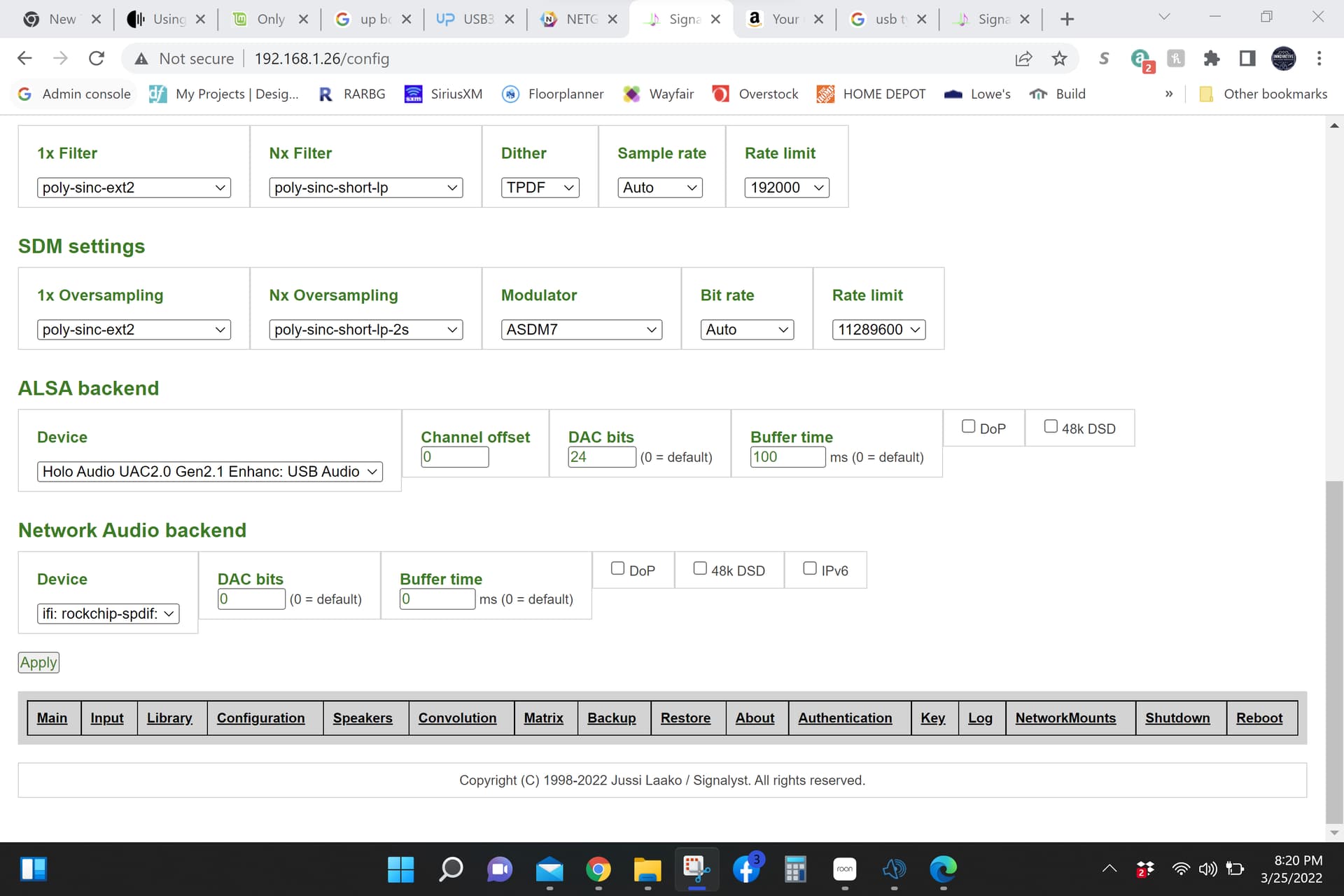

@jussi_laako i was able to change to device mode in bios but now the web ui is stuck on the “generic” page , i cant open the input , library , speaker , convolution etc , ideas>?
If it throws you on the /config page always, it is hint that your configuration is broken and needs fixing. Usual reason for this is that the output device is not accessible.
Screenshots of everything on your Config page will help.
And what DAC?

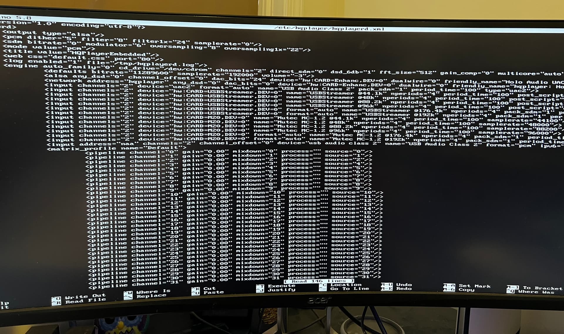

And in the case of using UAC2 input , screenshots of your confing .XML file to check coding
If we can see what you see, makes it much faster to spot issues .
@dabassgoesboomboom holo may dac , how does one access the config.xml file?

nano /etc/hqplayer/hqplayerd.xml
Then
Add this line:

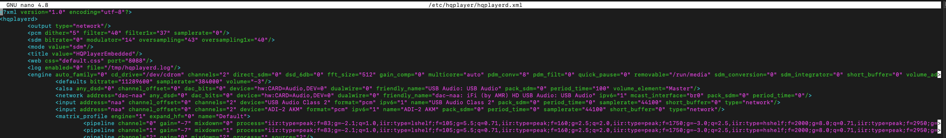

<input address="naa" channels="2" channel_offset="0" device="USB Audio Class 2" name="USB Audio Class 2" format="pcm" ipv6="1" pack_sdm="0" period_time="0" samplerate="44100" short_buffer="0" type="network"/>
Make sure you save the .xml file before you exit it. After you close it, open it again to double check this line is saved.
Then
systemctl restart hqplayerd
You need to get the syntax precise or it won’t work. If it doesn’t work, go back and re-check you got everything exact.

See mine below. Pay attention to the colours. They can give you a clue if you type something wrong , as Michael Grant recently found out.

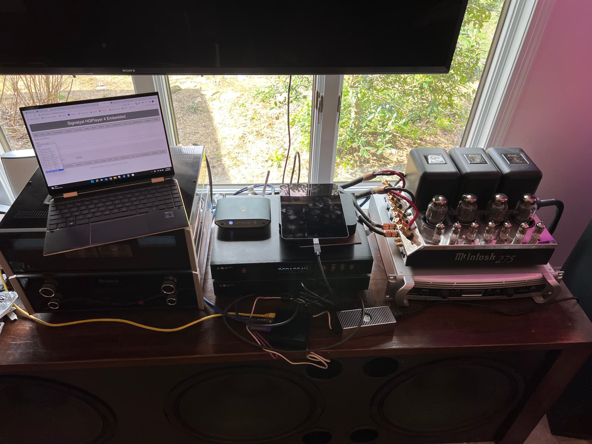

i just want to be clear all im looking to do is airplay apple music from my iphone/ipad to my streamer OR ipad direct USBc > USB 3.0 otg microb > HQPeOS upboard gateway > run convolution/pcm upsample done on the HQPeOS upboard > USB 2.0 out to Holo May dac.

I was able to edit the xml file
I now have an additional UAC2 input listed

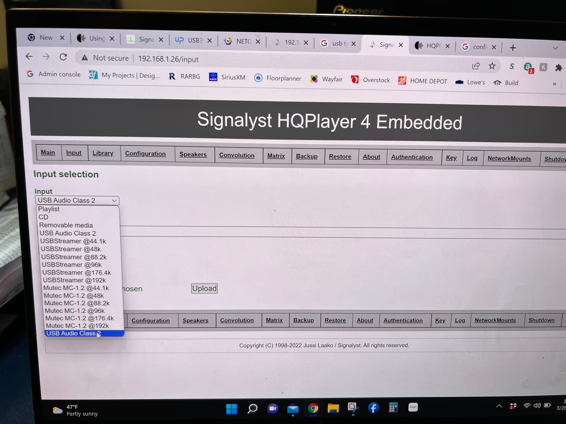

But i cannot get sound into the upboard either via ifi stream , BS node , or usb direct from ipad
When you select either of the UAC2 inputs nothing happens and if you leave the page it reverts back to playlist
I dont think the upboard is reading the usb 3 port correct
If you are running HQPlayer OS image and want to locally use the USB input on same device, you don’t need to edit the configuration file at all. It is already there predefined (you can see it in your screenshot, fourth line on the drop list).

i think, its working now i had to change in upboard bios
Default drd config to - device mode
And
Usb vbus to - off

I didn’t know you were actually running full blown HQP on the Upboard itself
But if you get a powerful HQP machine, you can use the Upboard just as a USB input over the network
And those are the steps I shared above (how I use it).
So in my case the little Intel Atom processor in the Upboard isn’t a factor. It just takes my iOS/macOS stream and hands off to my i9-11900K which does upsampling to DSD and other DSP
A lot of people are feeding their Holo DACs with DSD256 / PCM1.5MHz
So if you have a powerful machine that can do that, just follow the steps I shared
In case my Upboard is inside my listening room but my 11900K is on the other side of the house.
So music goes from iOS to UpBoard then over Cat 6 to other side of house then back to listening room to DAC
