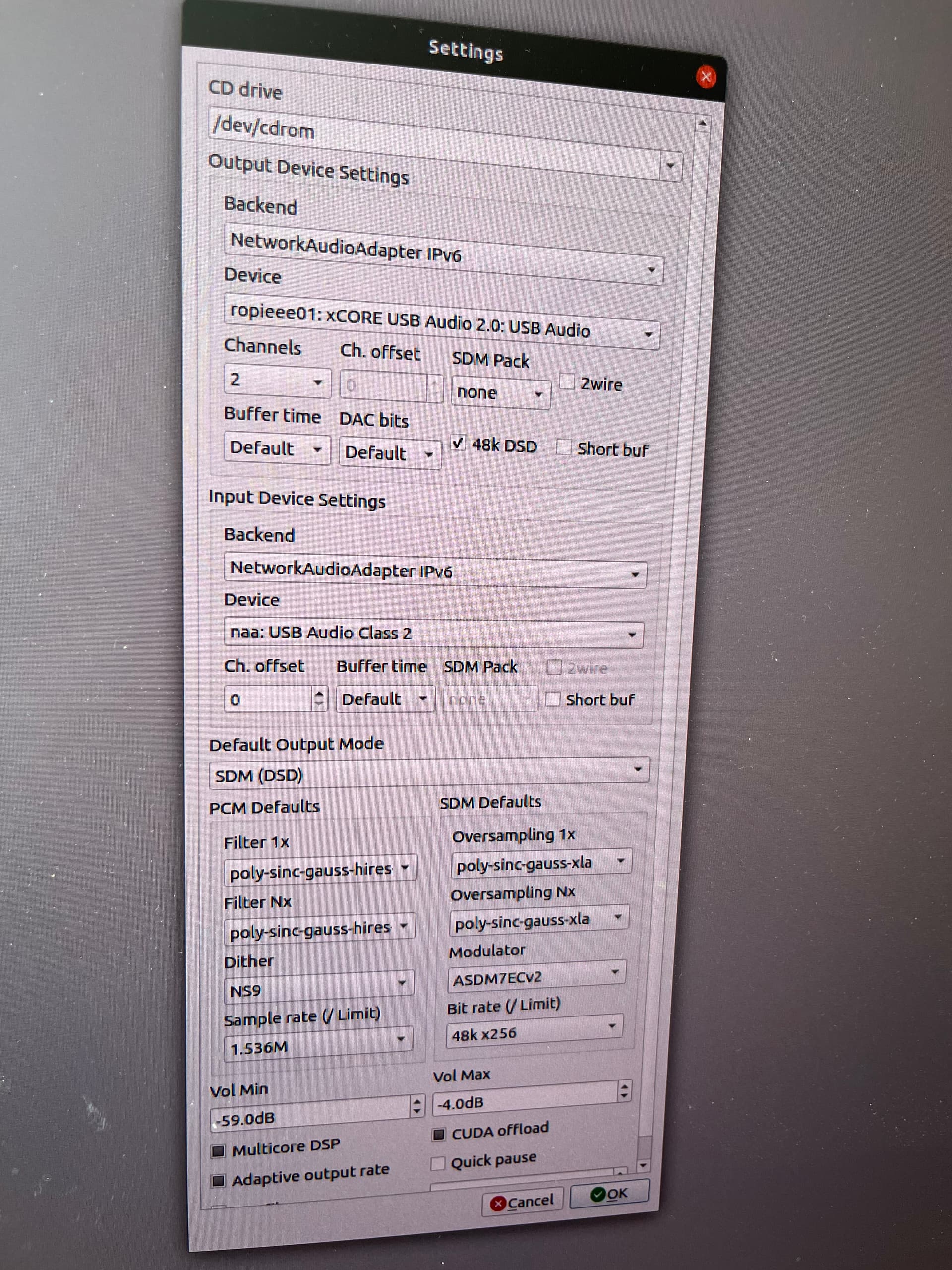

Here you see it all already. Audio Input chosen 44.1 and HQP Desktop detects 96. So, You have all that input options offered up to 192. But stay with 44.1 please. There it is switching.
Here you go:
Not this one. The one that shows what input you need to select to get it to work.
This is the one.
I don’t know if deleting the line you mentioned would make a difference.
The line you deleted from config xml is for a machine running HQPlayer to be able to directly take UAC2 input. For example if you load HQPlayer directly on the RPi4, you would need to use the line you deleted.
By selecting the naa input like you are doing, it’s using the same line that’s on NAA OS locally. Which is how it appears in desktop “input” section.
Still, it’s interesting you have it working but myself and Chunhao couldn’t get auto sample rate switching to work reliably.
I can’t recall if it sometimes worked and sometimes broke but maybe next weekend I’ll try it again.
hihi, just did not find hqplayerd.xml at naa os for pi. so just gave it a go without the line :rofl:

Yes you won’t find hqplayerd.xml on NAA OS.
But you will find it on HQP OS for RPi4. In that case, you would use that line.
Same like UpBoard can run HQP OS also , not only NAA OS.

Yeah, there’s just the equivalent networkaudiod.xml and by default it has this:
<input name="USB Audio Class 2" channels="2" device="uac2" format="auto" pack_sdm="1" period_time="100" type="uac2"/>
So if the USB stack works on NAA OS, then the UAC2 input should be visible at HQPlayer side, when configured there.
Note that also DSD should work over DoP.
There are also example lines for RME HDSPe AIO and RME ADI-2 Pro, but those need some manual editing because RME has the serial encoded in the device id.

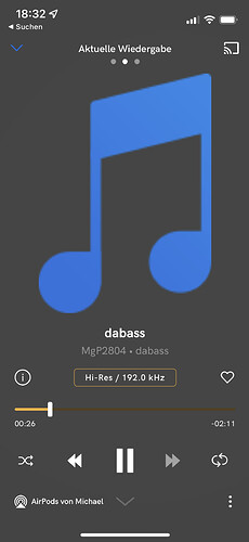

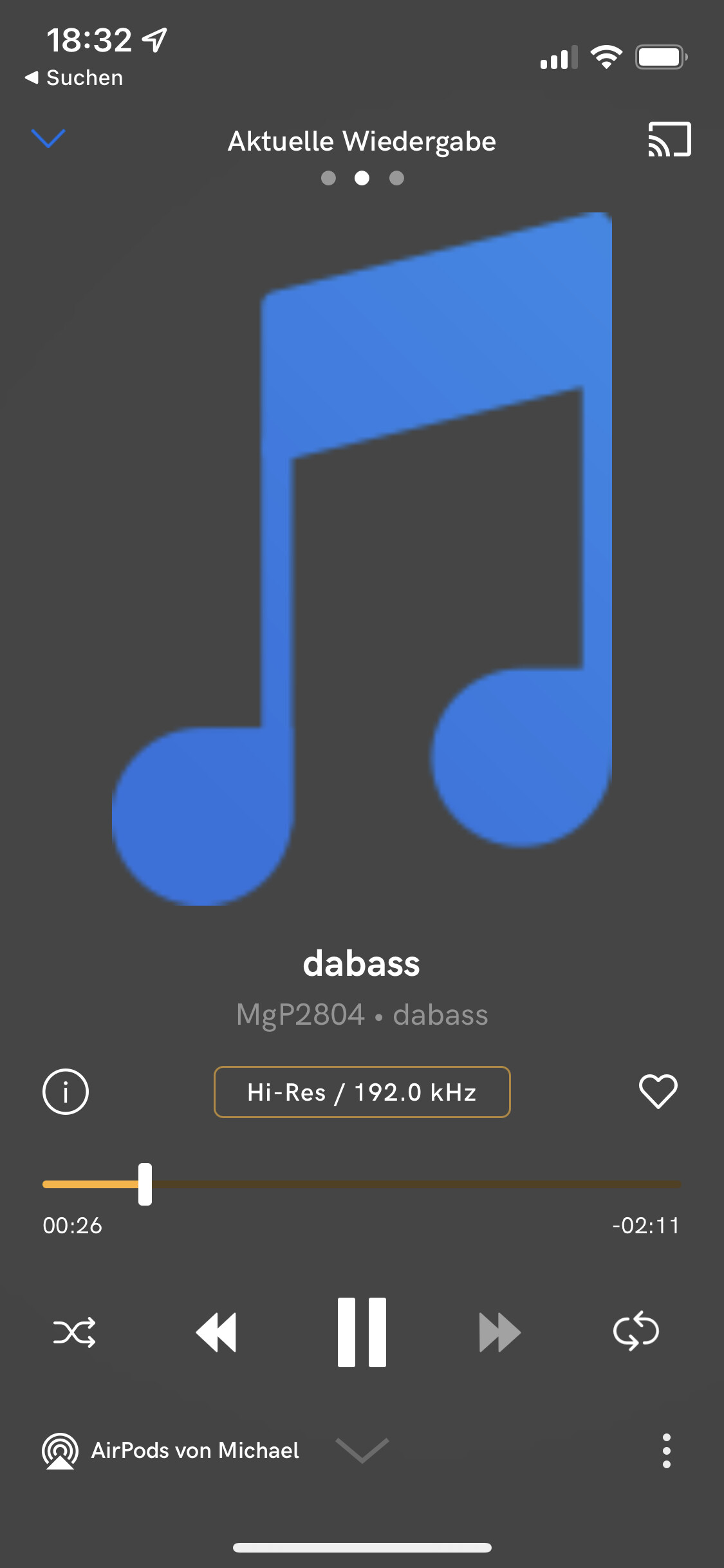

Uploaded to AM in 192. Stay tuned :slight_smile:
dabass - YouTube +++ Apple wants me to keep my MgP original name. They are super nice. But MgP has too many conflicts with others… :frowning:
Edit: dabass by MgP2804 on TIDAL ++ others are coming :slight_smile: they are fast with me :slight_smile:
Qobuz is the fastest with releasing in 192. However, if one looks in Audirvana most prob this track will turn out as Fake 192. This should be a 48/24 track only because of the used stuff for that one. :joy: Do not have Audirvana myself anymore.
