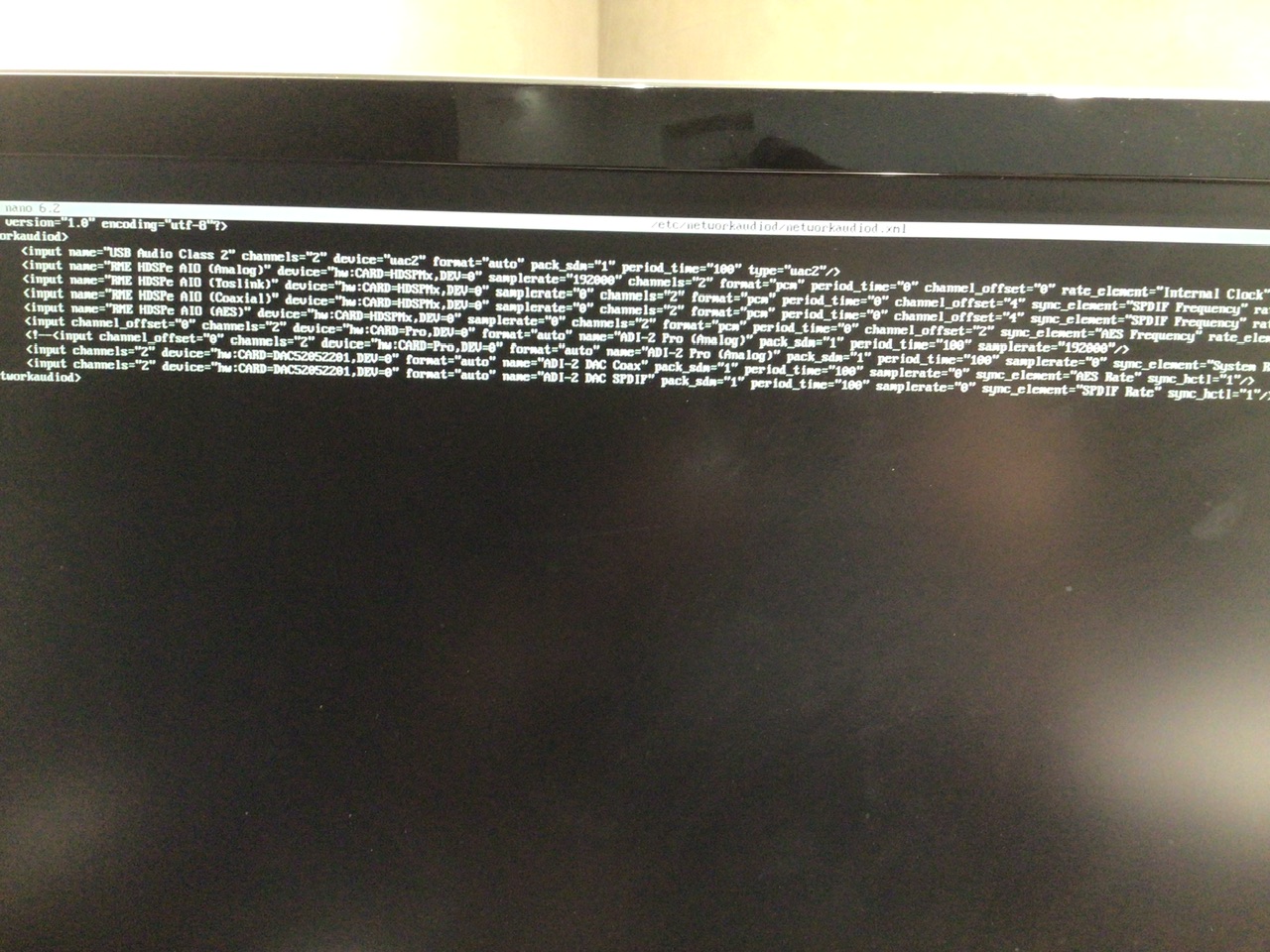

Did you configure your Pi4 specifically with your RME’s unique serial ID number?
Yes I did edit the serial

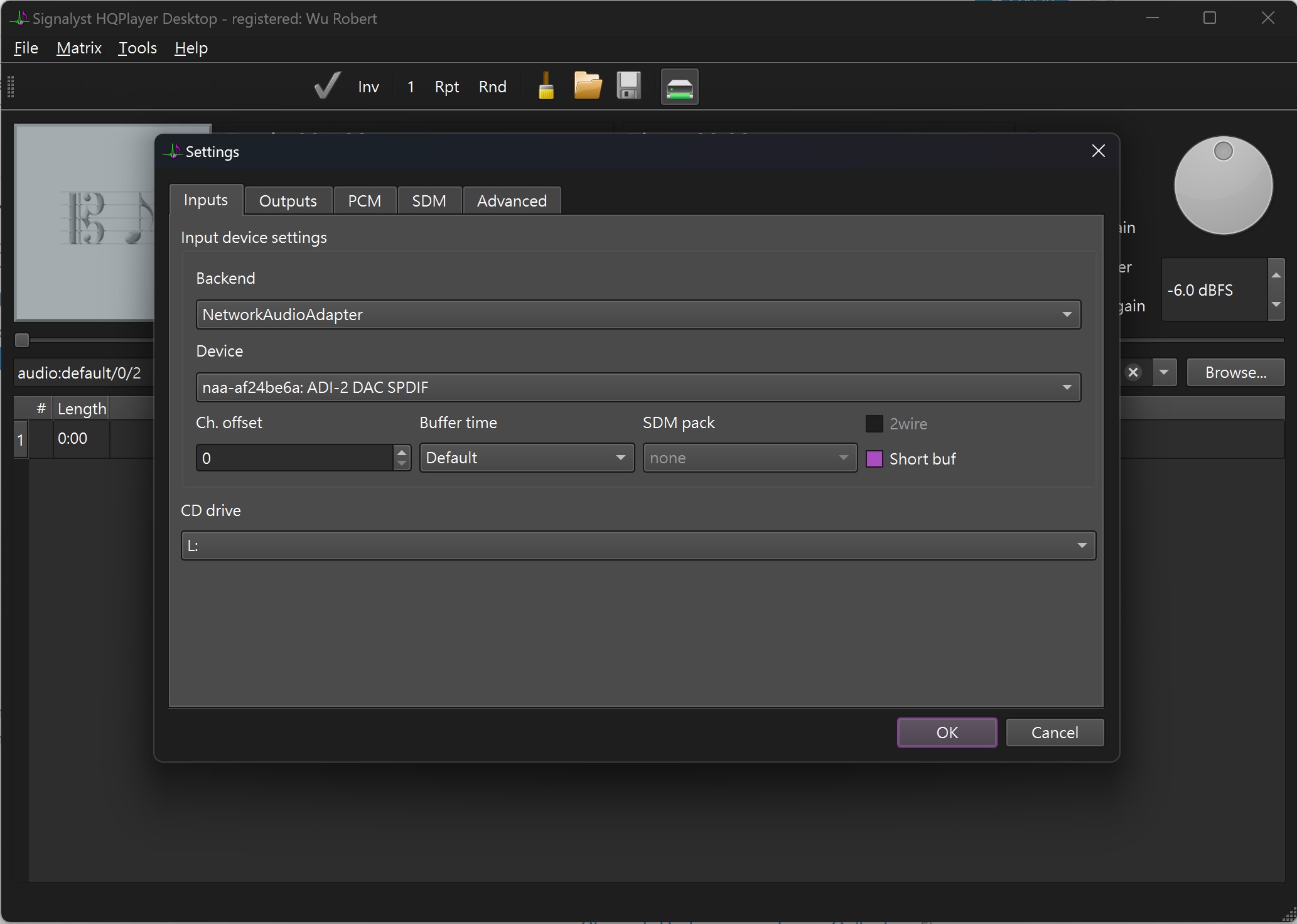

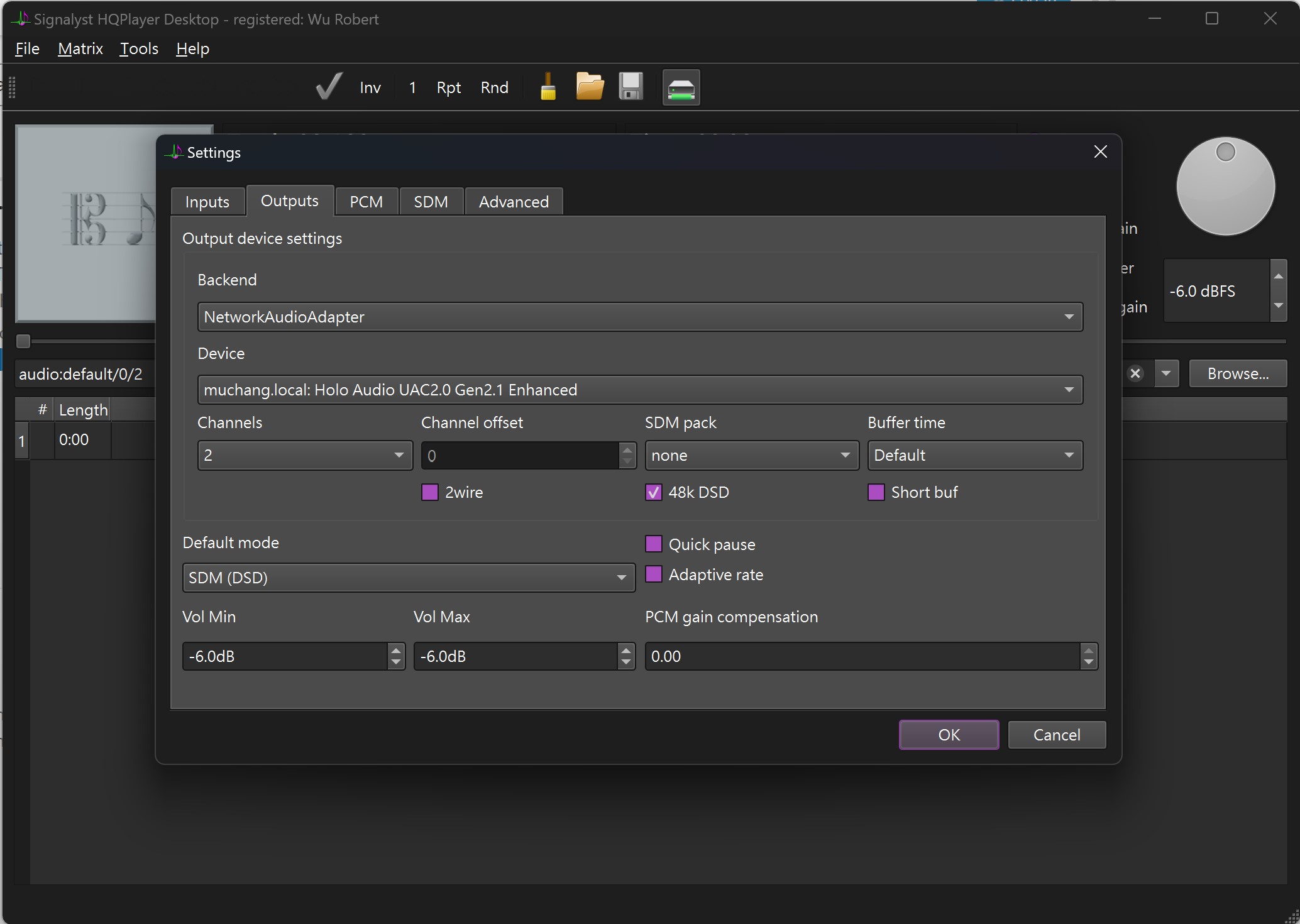

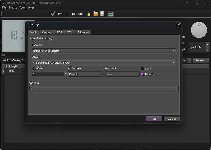

Hi @dabassgoesboomboom, screenshot as below
input:
output: (mac naa 4.31)

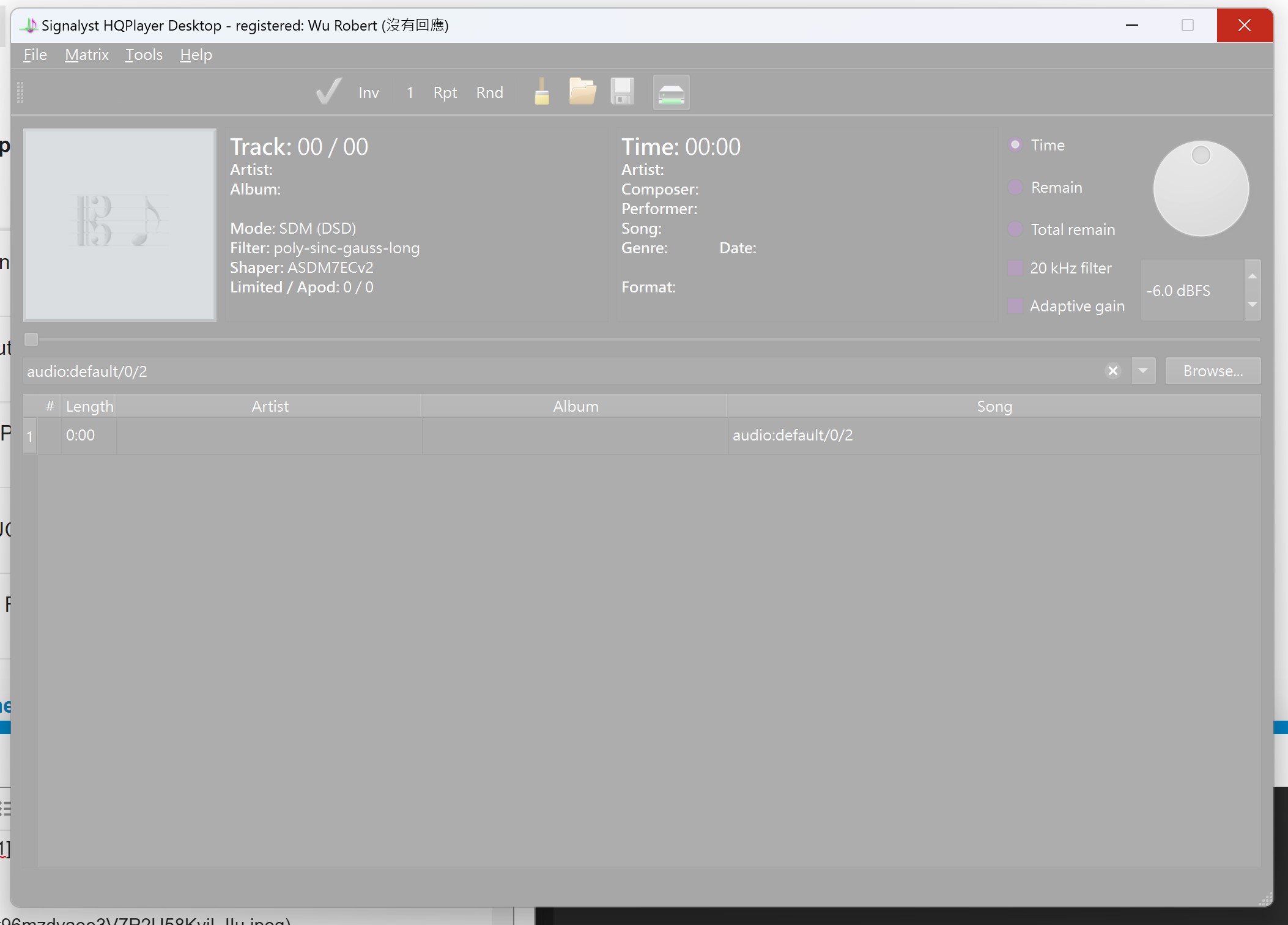

unresponsive after save setting:

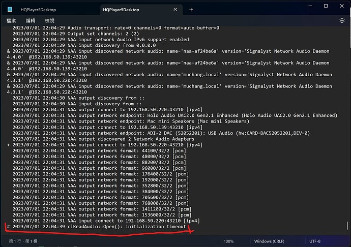

I had tried to wait for an hour and still no luck.

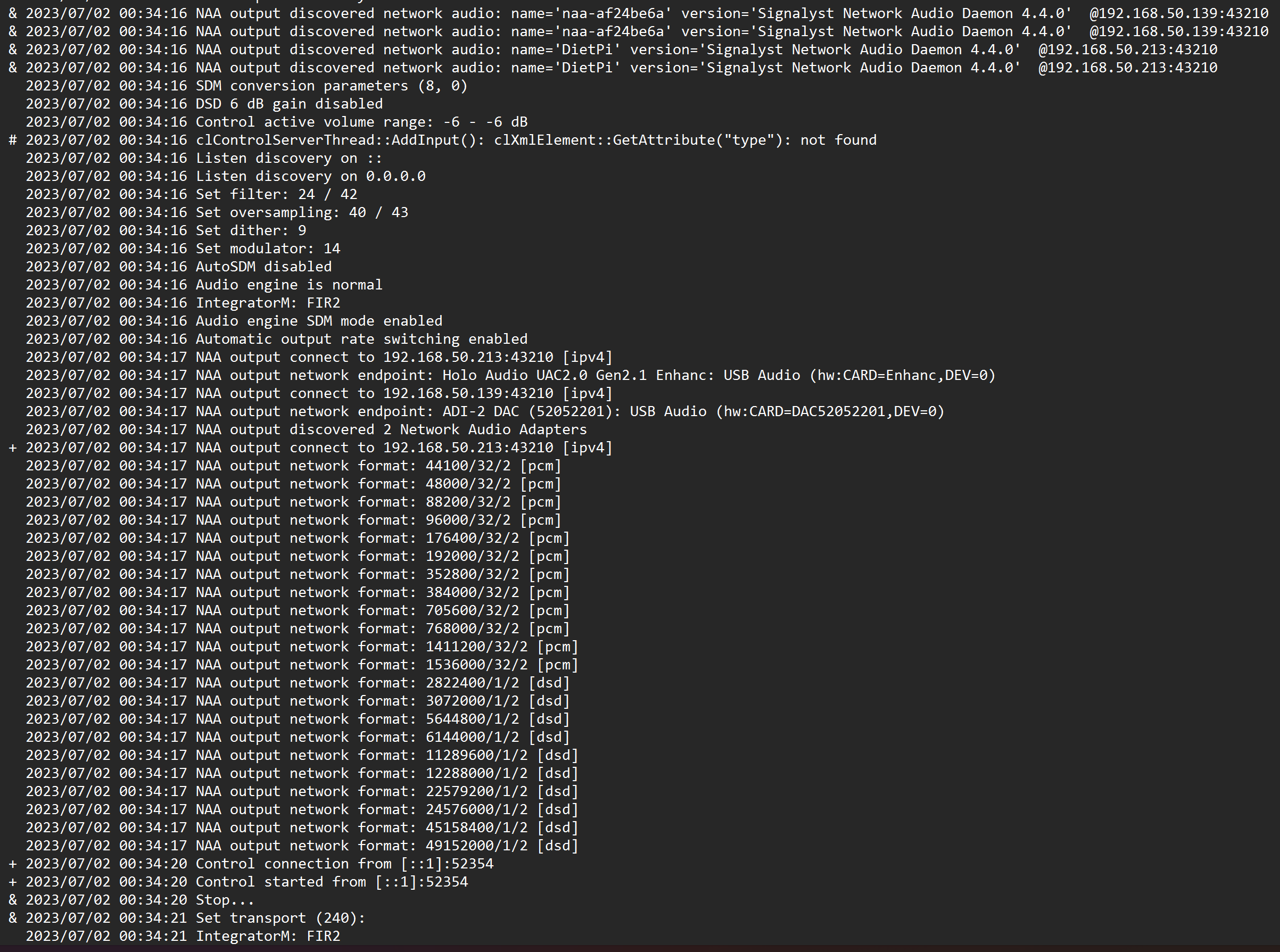

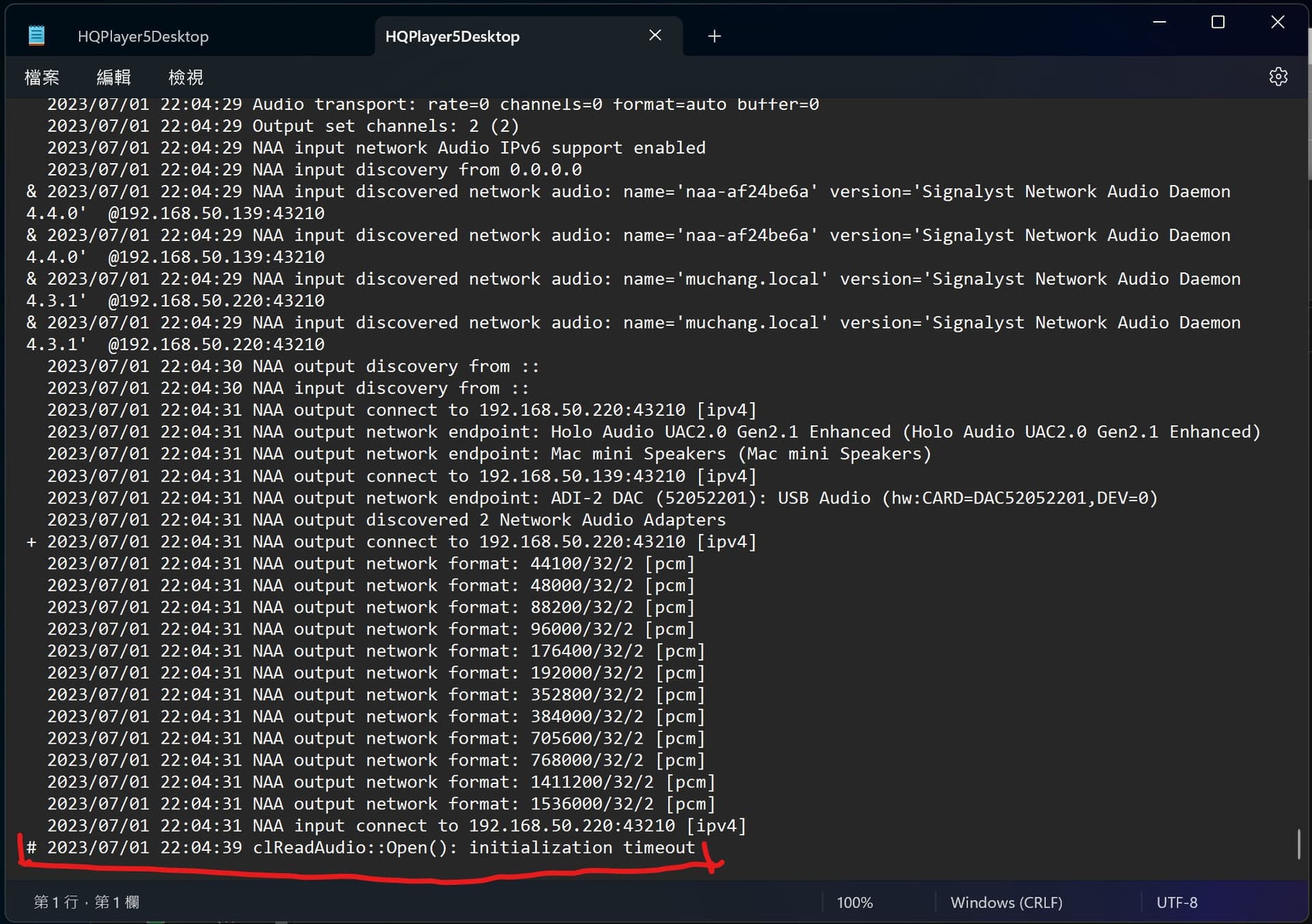

and log file as below
No idea why NAA input is connect to 192.168.50.220 (MAC NAA 4.31 as output to Holo DAC) and shows initialization time out.

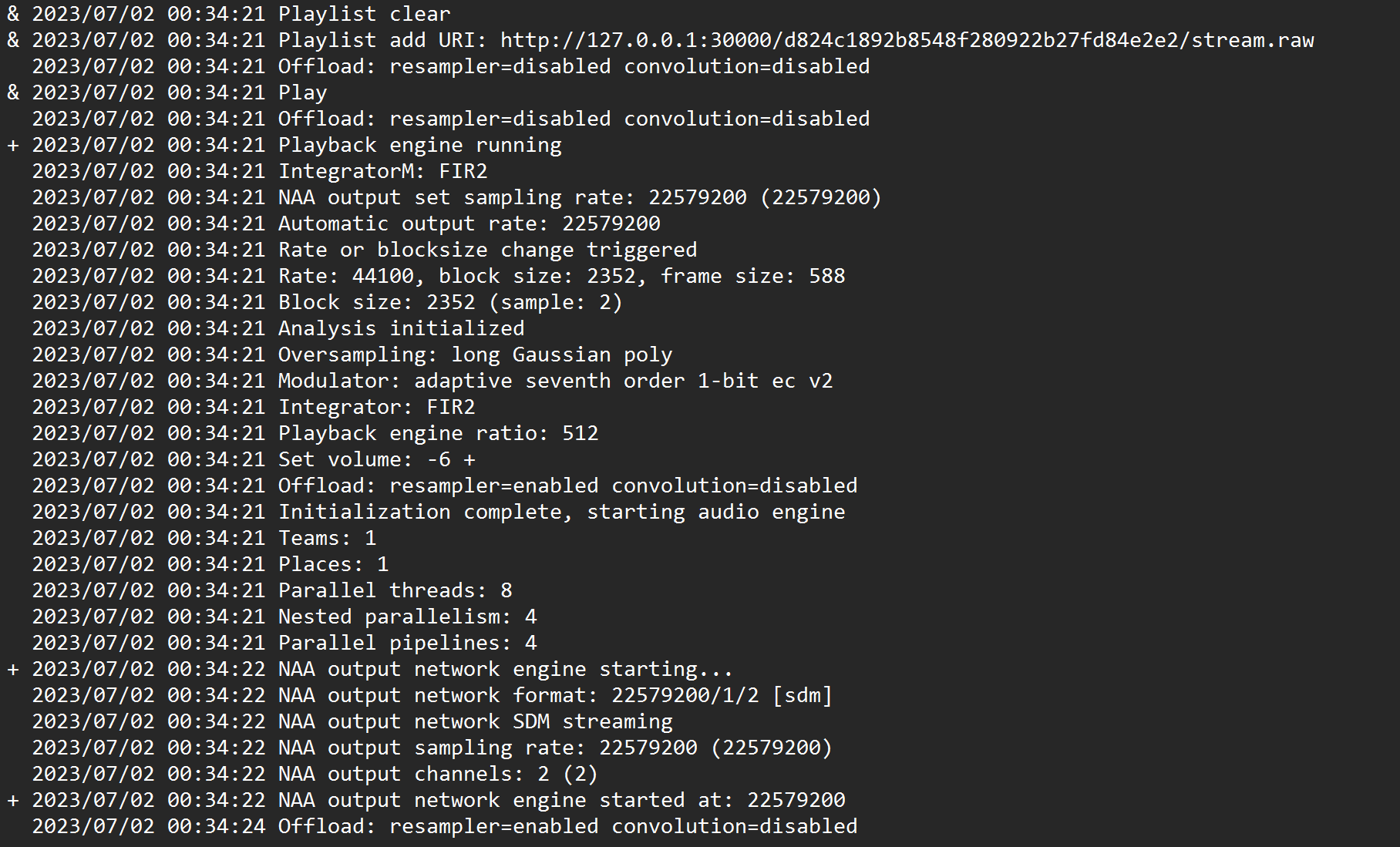

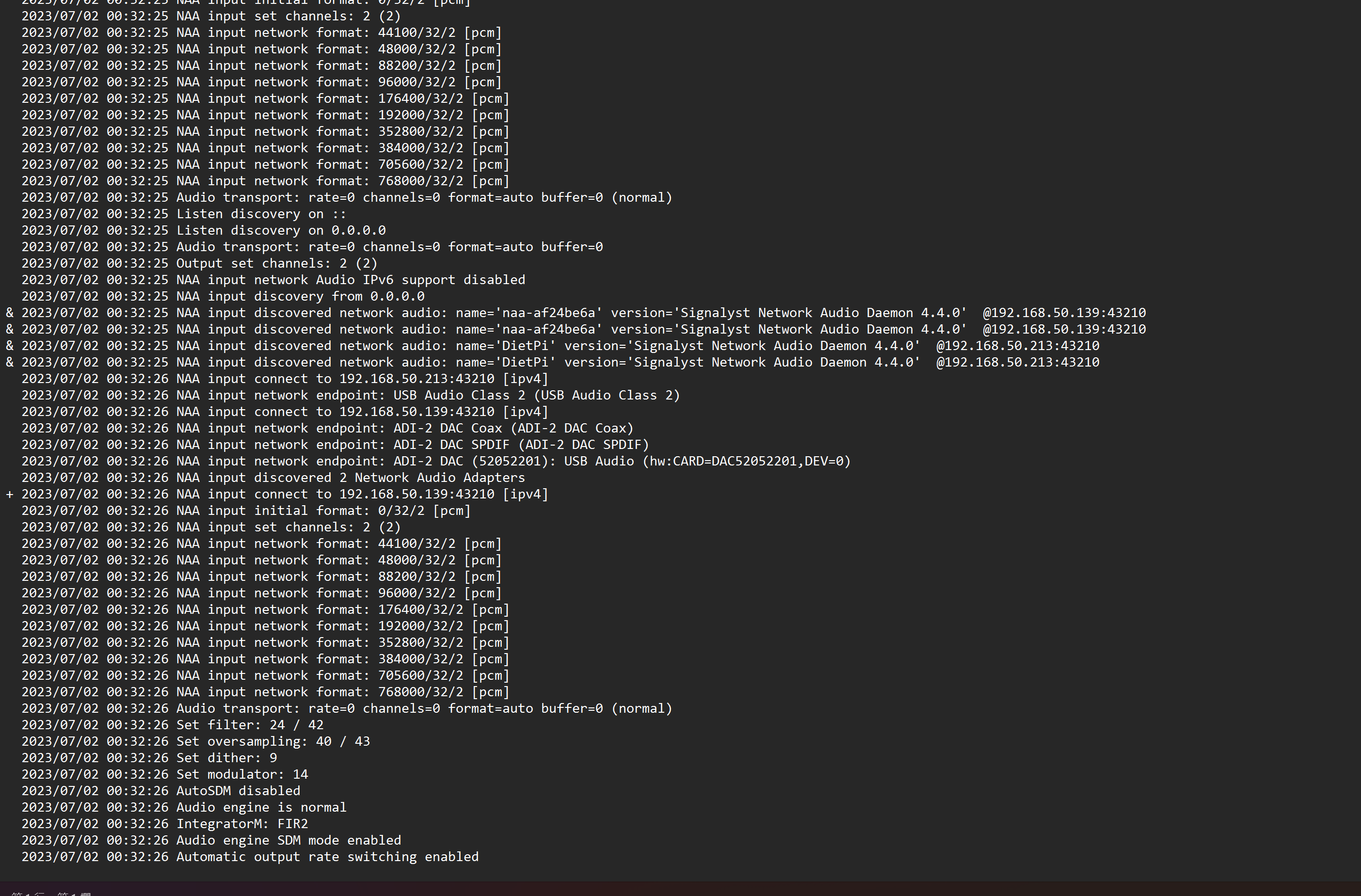

The log for setup input only

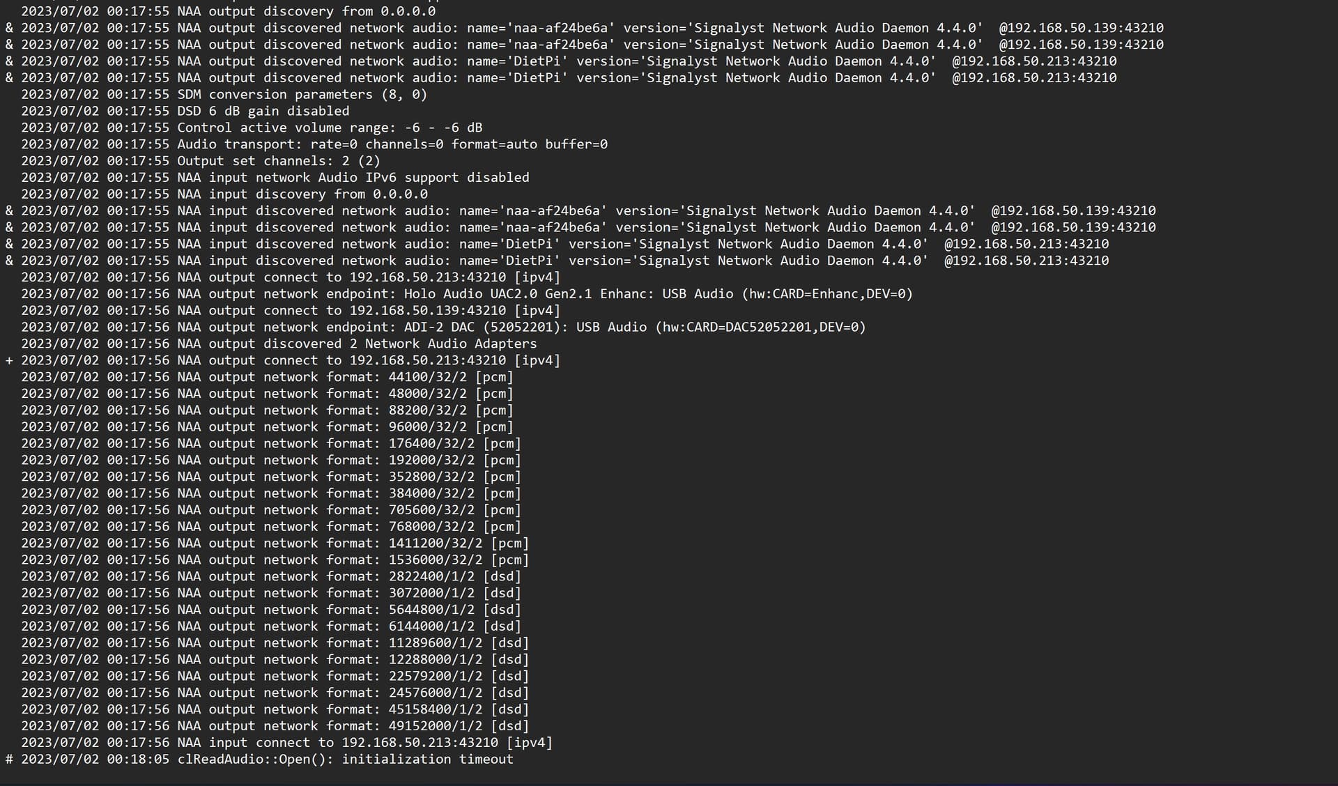

The log for setup output only and play with roon
That is wrong, can you check what has been set in settings.xml? (you can open it with Notepad)
I will check this part of the settings dialog code next week to make sure there is no bug related to this combination.
You may need to flip between the Input/Output Settings tabs, because switching backends for either side will trigger device rediscovery. So please doublecheck that the devices are still correct for both.
