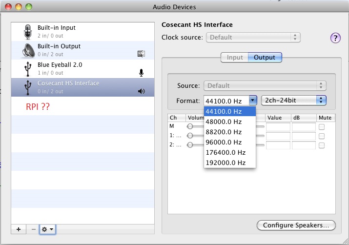

Sorry I meant whether the Mac when the Rpi is connected via USB recognizes the Rpi as an audio output device in the list on the left. In that case I can select the via Blackhole that as output device.
But I think the following route is more obvious:
‘3rd party software’ > Blackhole > HQPlayer > Ethernet > NAA endpoint.
I just hope HQP will be recognized as output device, because normally a dac is selected as output device… From what I understand, you can only aggregate a device that is in the Mac list. I wonder if HQPlayer appears in this?
This chain works. You won’t see the RPi NAA showing in Audio MIDI. You will see this NAA showing in HQP output

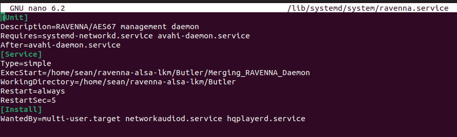

  1. create a service for Ravenna:
sudo nano /lib/systemd/system/ravenna.service
Put these lines to that service. Use your directory to ravenna-alsa-lkm:
[Unit]
Description=RAVENNA/AES67 management daemon
Requires=systemd-networkd.service avahi-daemon.service
After=avahi-daemon.service
[Service]
Type=simple
ExecStart=/your/directory/ravenna-alsa-lkm/Butler/Merging_RAVENNA_Daemon
WorkingDirectory=/your/directory/ravenna-alsa-lkm/Butler
Restart=always
RestartSec=5
[Install]
WantedBy=multi-user.target networkaudiod.service hqplayerd.service
Then
sudo systemctl enable ravenna.service
sudo systemctl start ravenna.service

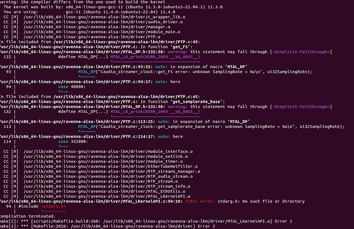

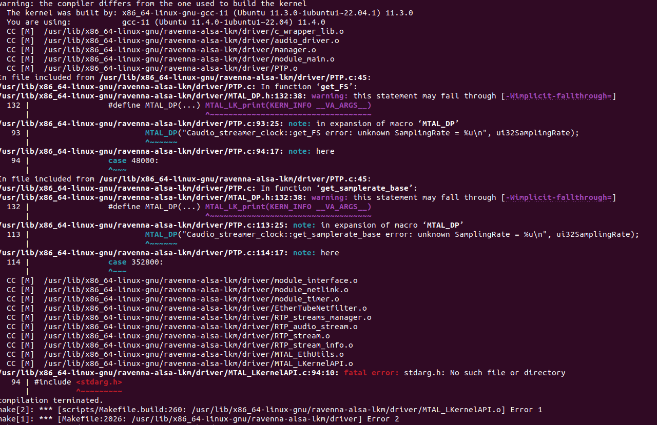

I got this error (red) at this step:
Would you move the ravenna-alsa-lkm folder to your home directory and try again? Under /usr/lib/x86_64-linux-gnu directory might have permission issue. :thinking: And also make sure the ravenna-alsa-lkm is the 7/24 release.
Related to this warning? Or this shouldn’t matter?
warning: the compiler differs from the one used to build the kernel
  The kernel was built by: x86_64-linux-gnu-gcc-11 (Ubuntu 11.3.0-1ubuntu1~22.04.1) 11.3.0
  You are using:           gcc-11 (Ubuntu 11.4.0-1ubuntu1~22.04) 11.4.0

Ah yes I see you mentioned your kernel version. Mine is newer:
6.2.0-1009-lowlatency
Current Merging’s Ravenna driver is for kernel 5.15 or lower. :sweat_smile: So I’d like to suggest to build it on Ubuntu 22.04 standard installation.
I can reboot to kernel 5.15, it is still there. And redo these steps

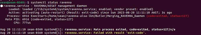

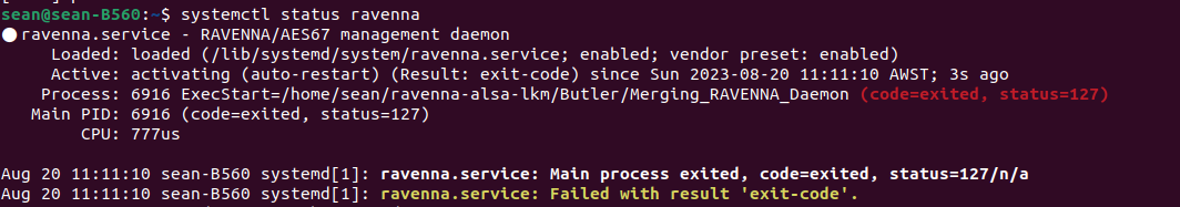

Ravenna daemon not running. Would help me go to ravenna-ALSA-lkm/Butler directory and using terminal to run the daemon? Type
./Merging_RAVENNA_Daemon
And see the result? Before run make sure you change it to excecutable.
sean@sean-B560:~/ravenna-alsa-lkm/Butler$ sudo ./Merging_RAVENNA_Daemon
./Merging_RAVENNA_Daemon: error while loading shared libraries: libcurl.so.4: cannot open shared object file: No such file or directory
this should be 4.8.0 ?
