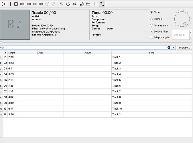

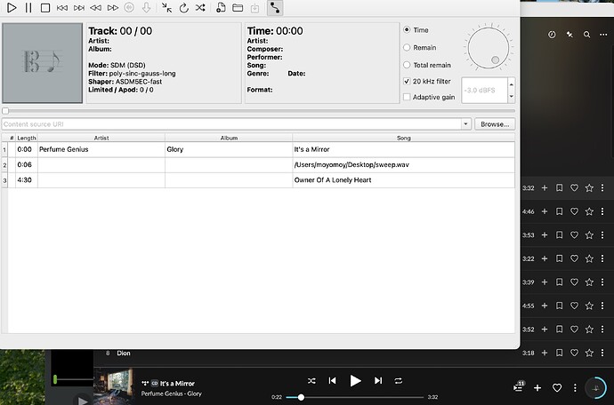

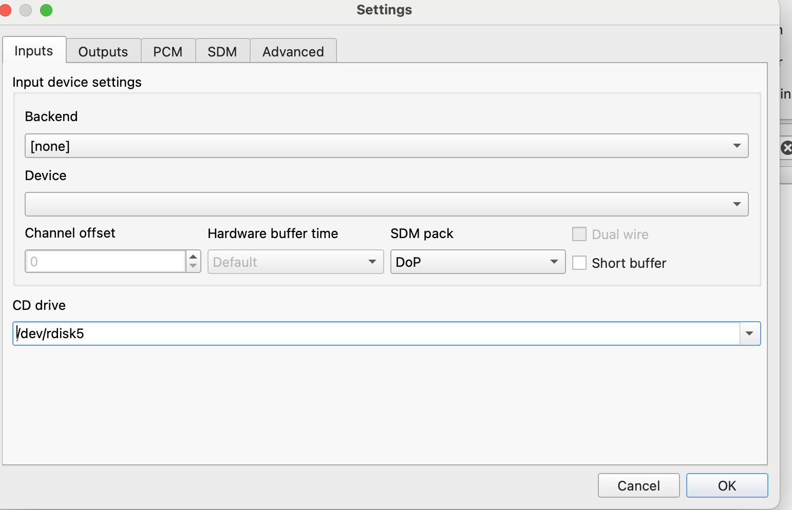

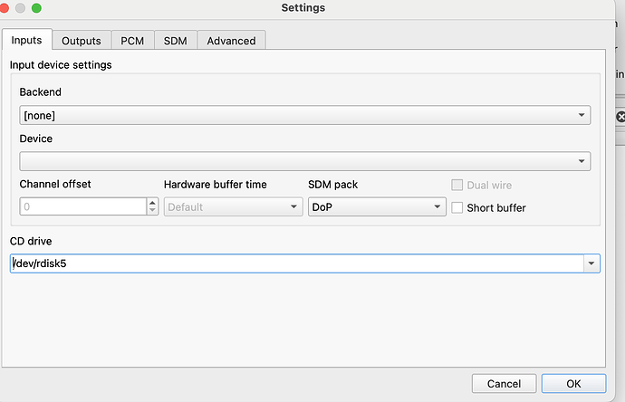

So I just open HQplayer on my Mac and the CD player will be ready available. On source do I need to write any path? I think I tried drag and drop before and it didn’t work.
Will try this:
I tried using the browse for the CD, but HQplayer does not seem to be able to read it, also not able to read AIFF files, If I convert them to FLAC, is able to drop or browse and play.
Not really important as all my CD’s have been ripped

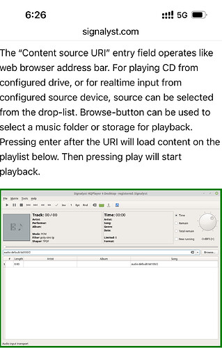

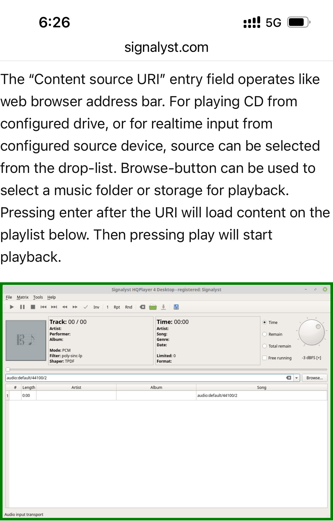

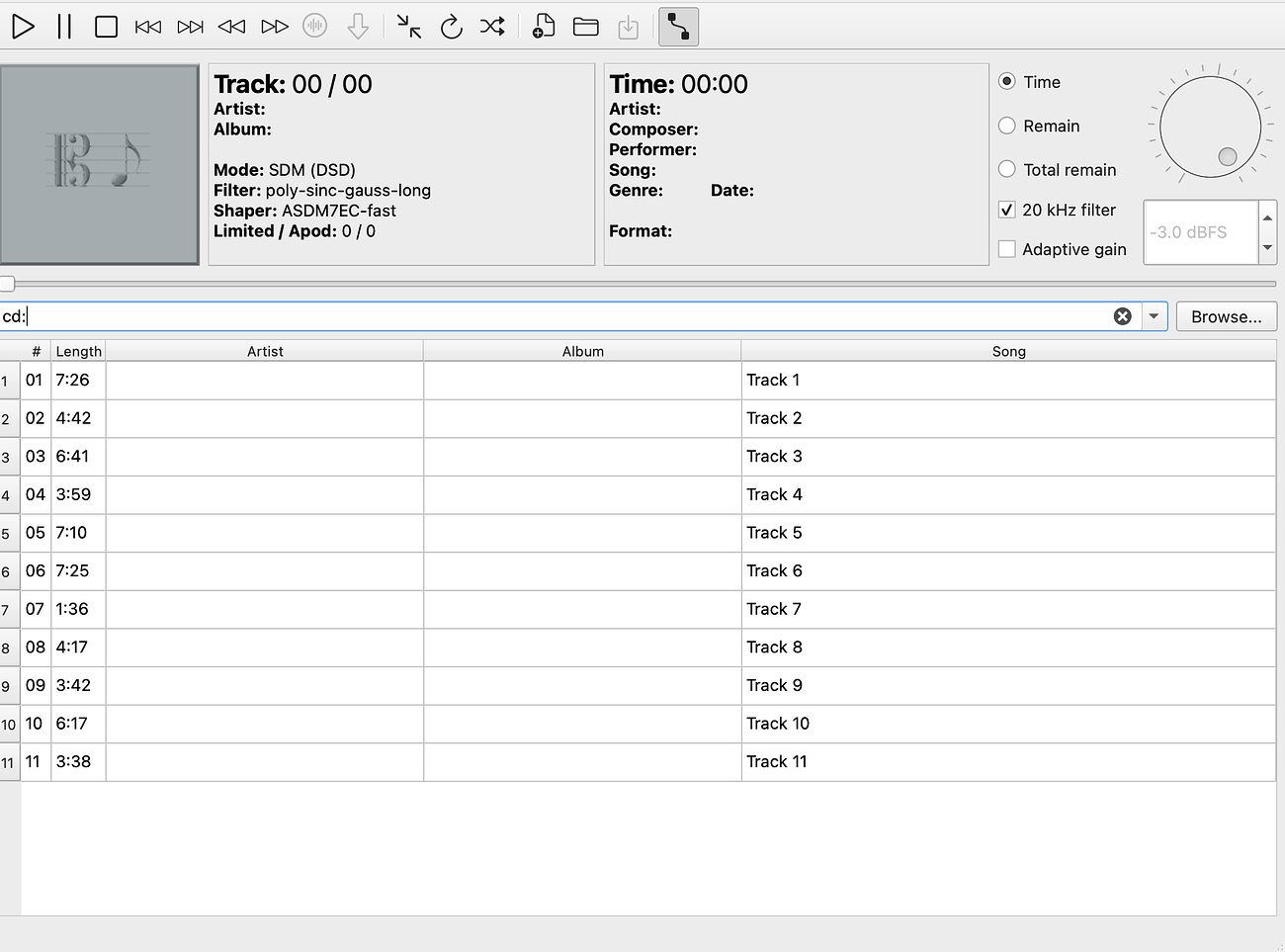

In settings you need to specify the CD drive’s device node, instructions are in the manual.
From source drop list you select “cd:” URI and hit enter to load it on playlist which loads contents of the disc. You can then start playback when the tracks appear.
AIFF files should work fine, at least they do for me. Log file would tell why HQPlayer doesn’t like those. (HQPlayer is pretty pedantic checking correctness of the header data against the actual file)

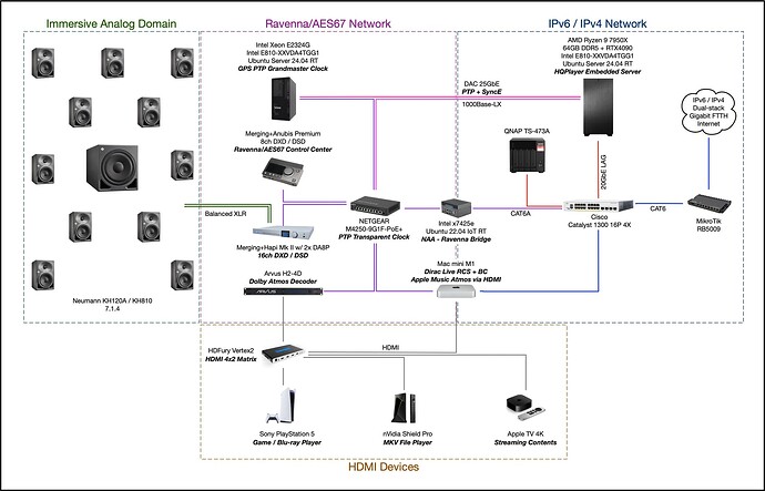

Talking about the online streaming services send to HQPlayer… here’s my solutions:
The main reason I choose HDMI device for streaming media is audio with Dolby Atmos becomes mainstream. But unfortunately those contents are not provided thru web. So the best platform is HDMI devices like Apple TV 4K, nVidia Shield Pro or HTPC.
Core of the idea is 1. using a Dolby Atmos (DD+ and TrueHD) decoder with AES67 output and 2. fully implementing AES67 AoIP.
The Dolby Atmos contents decoded as MCH LPCM then send to HQPlayer via AES67. You can do DRC using FIR or PEQ in HQPlayer, upsampling to DSD, then send to your preferred DACs (you can aggregate several 2ch USB DACs as one multichannel DAC over HQP-NAA structure).
Other option for DRC is send the decoded audio stream to computer-based Dirac Live first via AES67, then output to HQPlayer via AES67 as well. :wink:
