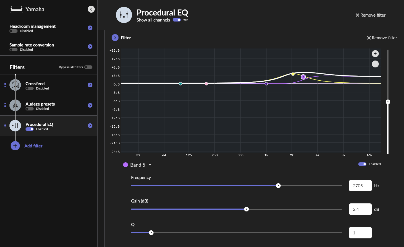

I’m exploring using DSP filters to compensate. Is there a better approach than what I’ve done below with a Procedural EQ filter that bumps volume up by a couple of decibels on the right?

I have a bit of losses in left side, high frequency more so. Do you know if we can EQ left and right independently like fabfilter EQ allows? I’m currently doing the volume just as you explained so well.

I think to eq individual channels you have to enable that option. Hope it answers your question. I do not use roon anymore for this as I moved all dsp to HQP.
Screenshot 2023-01-22 at 03.34.15
sorry as you do not know when mouse is clicking.
