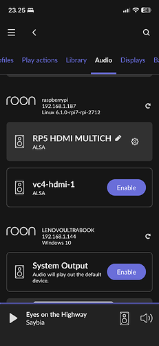

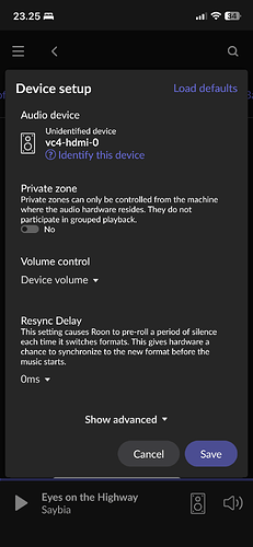

  • In my IOS App under settings=>Audio=>RaspberryPi I can see it’s using ALSA as transport. If I push “settings=>device setup” I get “Unidentified device”. And it does not help pushing “identify device” as my AVR is not Roon Ready / can’t be selected from the list.
    My “device” is listed as “vc4-hdmi-0” which is the HDMI 0 on the Pi5 (it has 2 HDMI outputs)
