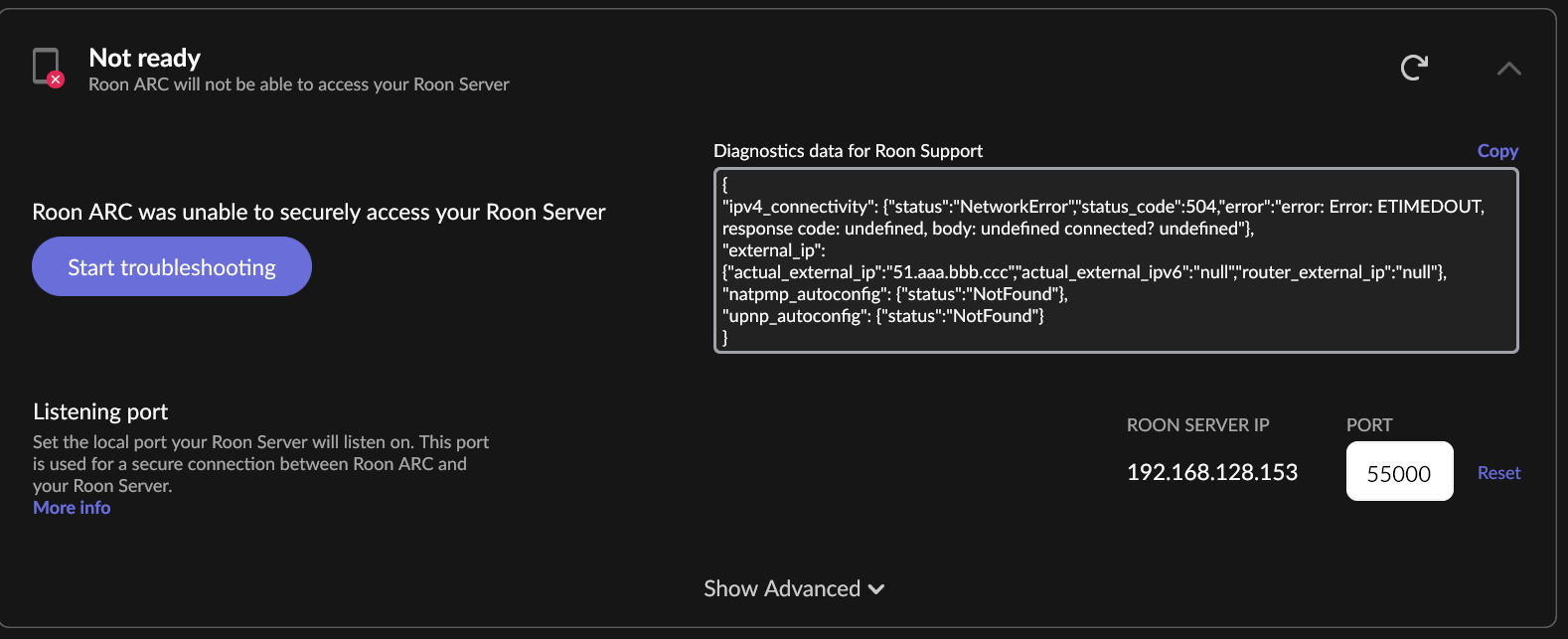

Screenshot of ARC setup:

What is the exact port forwarding error message you see in the Roon Settings → ARC tab?
“ipv4_connectivity”: {“status”:“NetworkError”,“status_code”:504,“error”:“error: Error: ETIMEDOUT, response code: undefined, body: undefined connected? undefined”},
“external_ip”: {“actual_external_ip”:“51.aaa.bbb.ccc”,“actual_external_ipv6”:“null”,“router_external_ip”:“null”},
“upnp_autoconfig”: {“status”:“NotFound”}

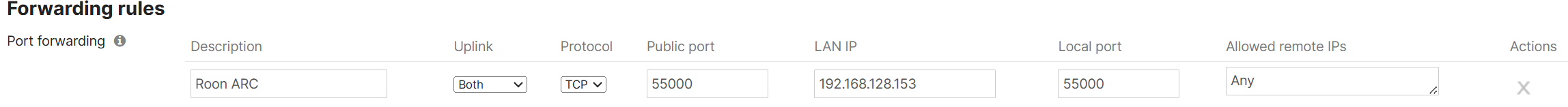

Screen shot on Cisco FW rule:

With your error, the important part is:
The protocols that configure port forwarding automatically are either not available or have failed. UPnP and NATPMP are not functioning in your router as Roon expects.

  • Turn on UPnP on your router and try to run Roon's port forwarding test again.
  • Try to set up manual port forwarding in your router.
    • Make sure the IP/Port matches in any port forwarding rule you create.
