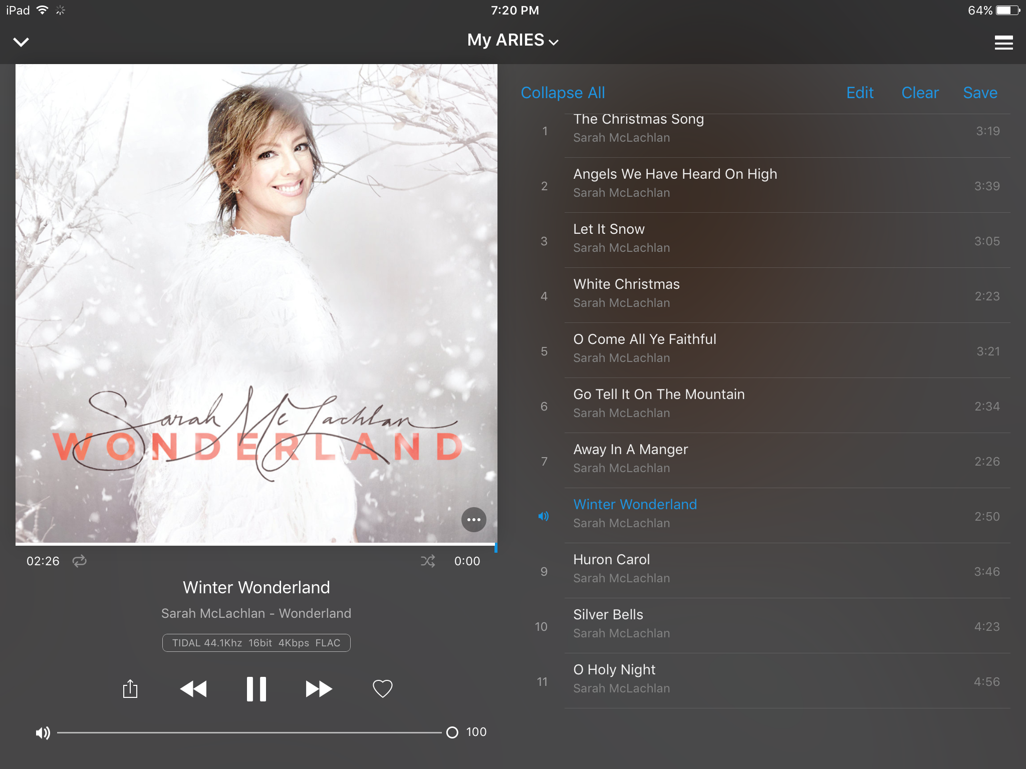

I noticed when the music get softer near to the end of the track, the bit rate suddenly down to below 100kbps, sometimes a few kilobyte! I observed some classical tracks with a few seconds of silence, the bit rate suddenly down to very low. This looks like NOT a classic characteristics of FLAC encoding and decoding. This seems to be some kind of throttling in order to save some bandwidth. If this is so, does this qualified as a ‘lossless’ streaming?

I’ve Auralic Aries lighting DS app shown here. I’ve yet to check Roon, the bit rate is so aggressively throttled down when the music becomes softer especially coming to the end of track. I see most FLAC I ripped from my collections hover around 600+ Kbps to as high 1100kbps, even if levels get softer, it never fall below 600+ Kbps.
I’ve never see FLAC bit rate fall below the 600++ Kbps, the compression ratio to be effective is around 1.7:1 mathematically so how can bit rate fall so low?
That is effective bit rate. Instantaneous bit rate ranges much higher and lower than the average. Some frames will be ~100 kbps, others ~1100 kbps in order to arrive at an effective rate of 600 kbps.
