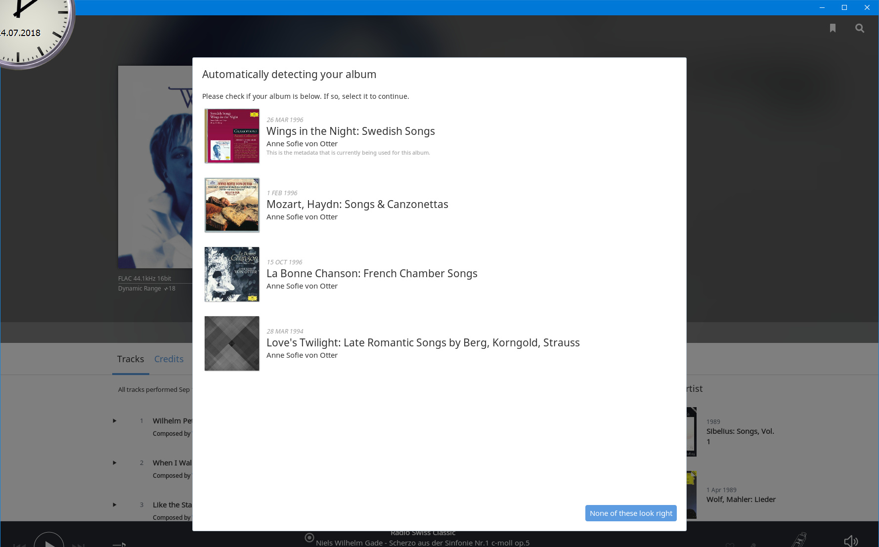

I very recently found an identification for the album (see the first entry below). As I said, for me the English track titles match the back of the CD cover; not so, the composers.
Stranger and stranger. Hopefully roon will be able to fix this. I can only get the correct track titles if I “prefer file”. Otherwise using the same identification as you it is a complete jumble. I double checked with my wife and also some youtube alternative performances in case all my track titles / numbers are messed up as well. But they look ok.
