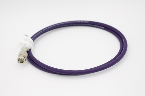

I would expect the $20 Amazon cable to sound no better than the stock one. The stock BNC cables that came with the HMS are terrible though and it doesn’t take a lot of money to beat them. I think you will be shocked by these for example:
And no, the PowerAdd battery doesn’t do as much as what they claim as far as stopping RF.
Seems like getting sidetracked. I have replaced bnc cables with $40 Blue Jeans cables. The point of the ubs cable was I was expecting any kind of difference, but I hear none. The cable was more of a test to see if worth it to buy more expensive ones. And as for as RF from the mscaler, I tried placing the mscaler further apart vs then normal 3 inches below the Dave and also hear no difference whatsoever. So while I’m open accepting differences, I test them myself if just a matter of time or very little money.
