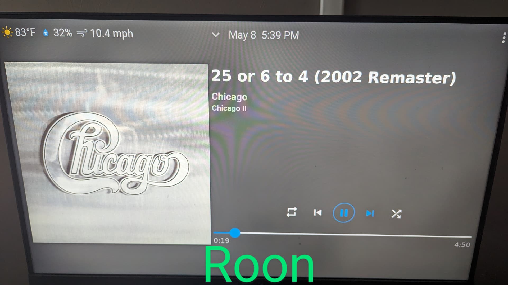

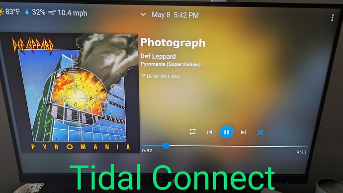

Just wanted to say this is working great, thanks so much for your work here. Being able to see art with both Airplay and Roon is really nice. I’ve only had to authorize once in Roon under Extensions, but that’s a pretty small lift. I’ve rebooted Volumio a few times while I keep setting it up, and it’s still working pretty well. Using a Pi 4 with the official display.

Are there plans to add sample rate and bit depth numbers to the display?
Any update on the sample rate/bit depth/file format ?
