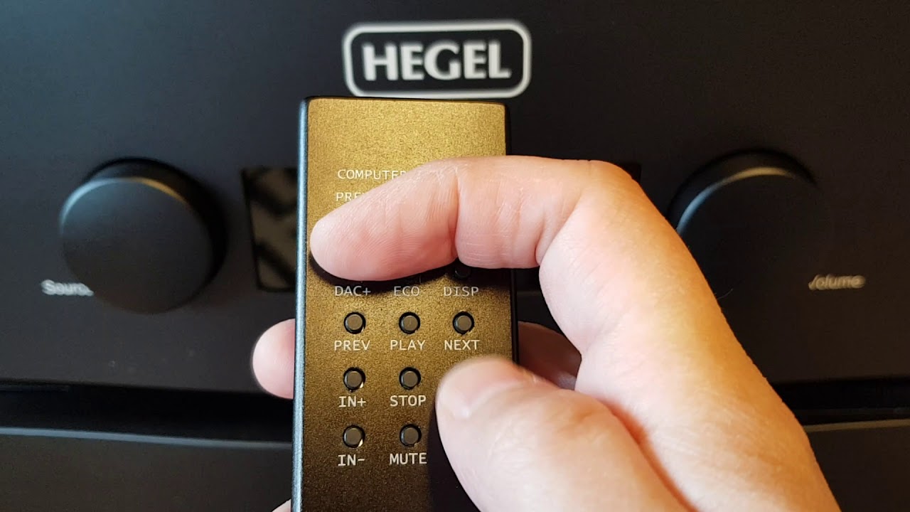

Resetting to default factory settings differs a bit from performing a factory reset - here is one way you can try performing a full factory reset on the Hegal:
Using the Remote Control:
  • Press and hold the DAC+ button
  • While holding DAC+, press the MUTE button
  • The amplifier will reset to its factory settings, clearing all user-defined configurations, including IP settings.
