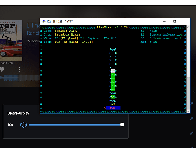

Thanks! It seems that alsamixer is only responding to RoonBridge and not to ShairPort Sync. ShairPort still adjusts the volume, but the changes are not reflected in alsamixer and are limited by the last alsamixer gain setting. So if I use RoonBridge and set the volume at, say -2.0dB, then I switch to ShairPort Sync, the maximum gain available to ShairPort is -2.0dB. (The alsamixer gain number never changes, just the sound output.) I will try uninstalling Roon, ShairPort, and ALSA, then reinstall ShairPort and ALSA to see what happens.
Even after uninstalling uninstalling Roon, ShairPort, and ALSA, then reinstalling ShairPort Sync (and with it ALSA), the problem is the same. The default volume for ALSA seems to be 85, or -0.38dB, so this becomes the absolute limit for ShairPort. Adjusting volume in Roon just sets the output in relation to this maximum and does not change alsamixer. The work-around, obviously is to just go into alsamixer and set it at 100, or about +4dB. However, it would be nice if ShairPort could control alsamixer directly, so DietPi could function as both a RAAT endpoint and an AirPlay device.

@Dan_Knight or anyone that can help. I was having this same issue on an allo boss (very low output with airplay) and attempted these instructions. Now I can seem to get airplay back working (it doesn’t show up in roon). This is what the shairport-sync.conf looks like:
general =
name = “%H”;
interpolation = “soxr”;
metadata =
enabled = “yes”;
include_cover_art = “no”;
pipe_name = “/tmp/shairport-sync-metadata”;
pipe_timeout = 5000;
socket_address = “226.0.0.1”;
socket_port = 5555;
socket_msglength = 65000;
//Disable software mixer
alsa =
mixer_control_name = “PCM”;
