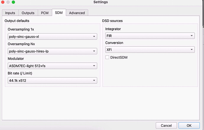

I am new to HQplayer. Bought it this week. I immediately heard an improvement compared to Roon as a player. Mainly regarding spaciousness. I do have a few questions about my settings.

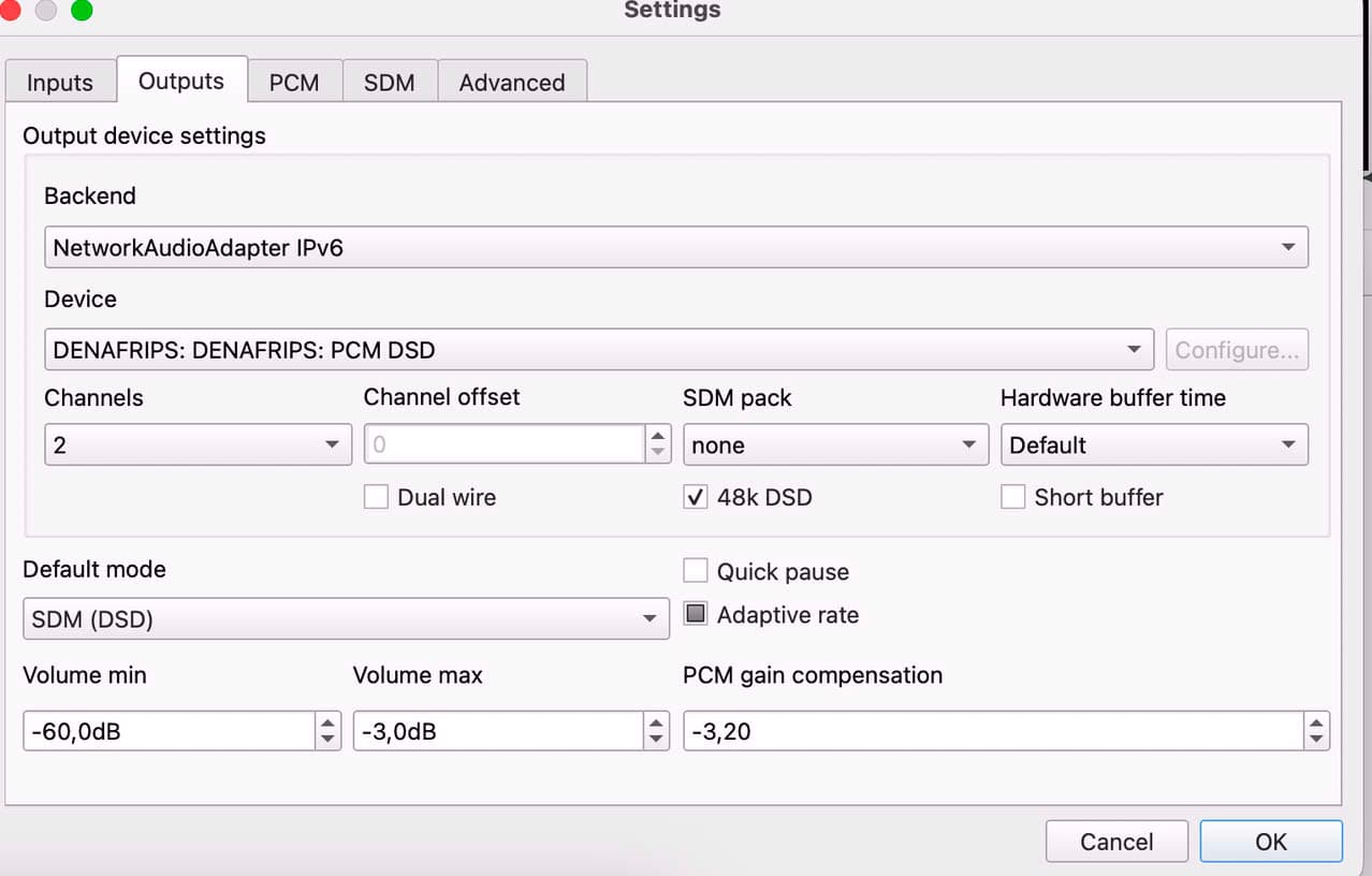

My set up is as follows:
Mac mini M2 → Roon → HQplayer → Denafrips Arce → Denafrips Pontus 15th → active speakers. The Arce is connected through I2s.
The Arce should be able to do DSD 1024, but I can’t seem to get it working. I get hiccups all the time, although the M2 has lots of CPU power left (4 cores are busy…). When I go to DSD512 I have no issues. Is it due to the Mac mini, is this the maximum I can get?

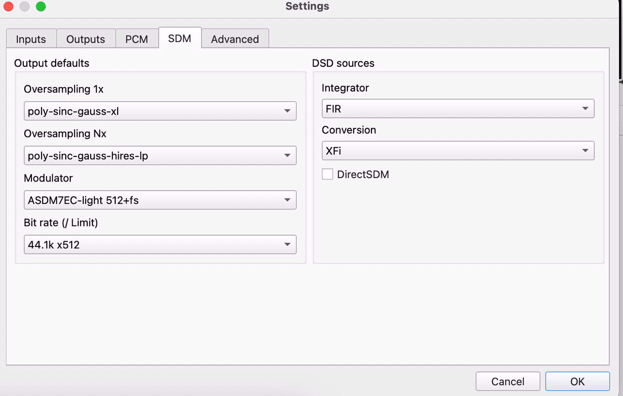

I am using the following filters for now:

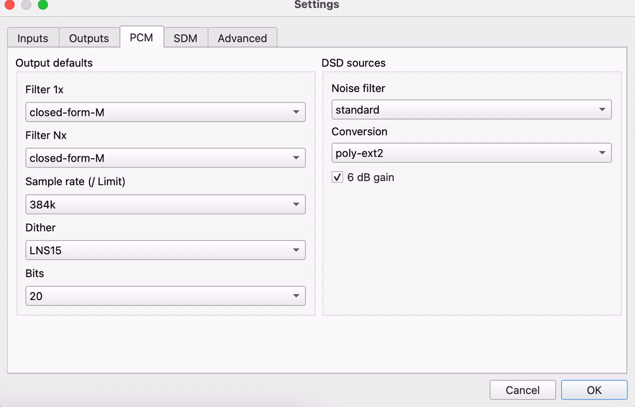

I am also switching to PCM now and then, however, restricted to Sample rate of 384 (due to I2S). Settings for PCM are as follows:
I am wondering if the bit settings (20) are ok for the Denafrips Arce & Pontus. I have tried 24 as well, since the Arce is capable of 24 bits, and the Pontus - according to the manual- true 26 bit. I have no clue…
Would be great to get some advice and pointers.

I don’t think it is easy to get DSD1024 out of Apple M-series CPUs. Your M2 probably has 4 performance cores, thus those ones are most loaded. And modulators are mathematically such, that not all of the processing can be spread to multiple cores. DSD512 with your settings should be already give a very good quality though.
Should be the correct one, based on my measurements of the Ares II.
It is technically impossible to make R2R ladder that is accurate to 24 bits, let alone 26 bits… Setting DAC Bits to 20 and using LNS15, especially at higher output sampling rates provides audio band dynamic range of 24+ bits.
Thank you for your response! It clears things up for me. I will play a bit around with the filters, but I am really enjoying Poly since-gauss xl and hires-lp with ASDM7EC light. If I change filter or modular I seem to be getting hiccups. But I keep it like this for now and enjoy.
