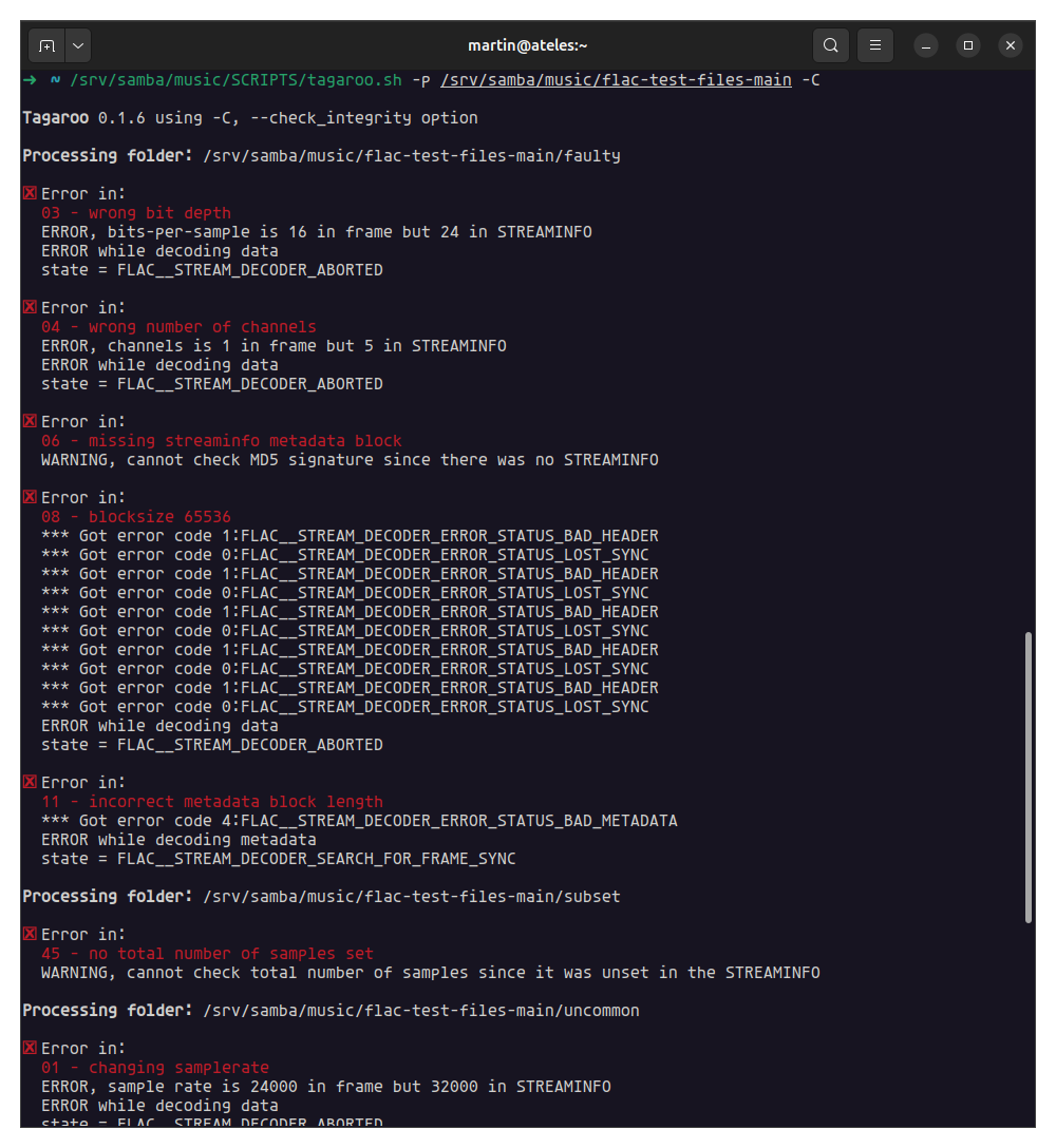

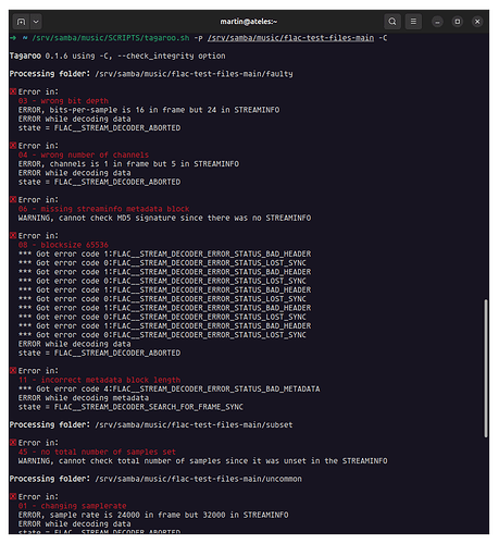

FLAC also has a comprehensive integrity check built into the standard. I have a script that I can run on my collection periodically to check for issues.
Edit: the kind of error checks and reports available for FLAC files.
Sure, but that’s true for any file. Then the hashes must be saved somewhere, and then for mass checking them one needs to write some kind of script, probably. I.e., stuff that is beyond 90% of Roon users.
As this gains nothing over what FLAC does automatically, why add the complication?
