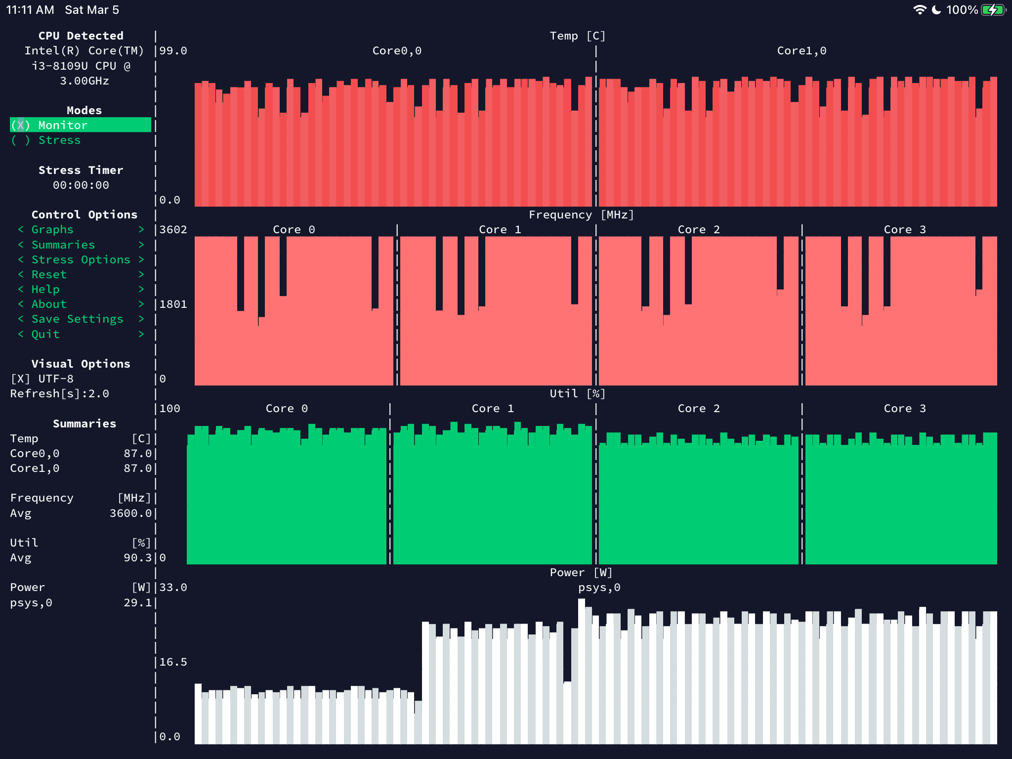

My current settings for a Spring 3. I use hires for the Nx filter. Really pushing my little 8th gen i3 to the limit! Any tips on upgrading the cooling on a NUC? 80C is fine, right? :upside_down_face:
I pity that CPU :slight_smile:
You can get some alternative cases for a NUC. But NUCs are a bit tricky since they are very tightly packed to make them as small as possible. So if you are building a fresh, going a bit larger form factor, such as Mini-ITX or Micro-ATX make cooling much easier.
It will thermal throttle if it gets too hot, so at most you will start getting drop-outs if it happens.
So far I have not heard of anybody who would have burnt a CPU. Although running a big CPU without any cooling attached would be very risky.

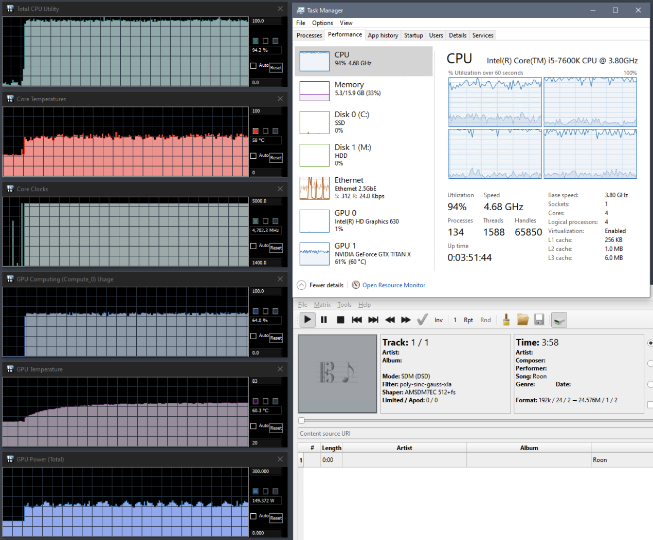

… I decided to re-purpose some parts from a previous hackintosh… Threw it in all together in a box with a 512ssd, a 10tb exos drive for storage, 7th gen i5 7600k with an overclock to 4.7GHz, 16GB ram and an old GTX Titan X on a Striped down version of Win10 (all bloatware and crap removed). I figure I should be future proofed for a bit.
It was a bit slower than the i9 RoonServer on mac when it came to analyzing the library… took ~2 days for ~100000 tracks. It just finished a bit ago and I just gave it a torture test for a bit using a 192k/24 w/poly-sinc-gauss-xla ASDM7ECv2 48kDSD256. That combo really loads up the cpu and the gpu. There weren’t any dropouts but I now kinda wish I had splurged for the i7 7700k back when I bought this processor… I would’ve had a bit more wiggle room. Without cuda this would be a no go with this filter and modulator combo. But with other combos, lately it’s been SincLI and GuassHiRes lp, it’s much less taxing on the gpu and cpu… ususally at or below 60% on cpu and 10-20 on gpu.

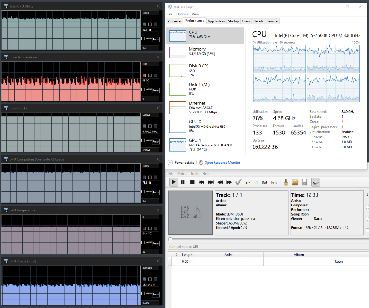

Here’s a few screenshots for temp and usage…
poly-sinc-gauss-xla ASDM7ECv2 48kDSD512 for reference using null output (looks like this would have dropouts! Need a newer gen processor, but temps are very good!)

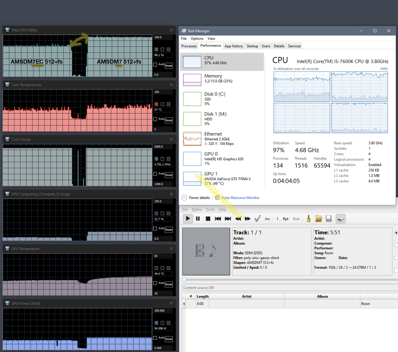

Once again, not sure about dropouts but as far as usage and temps here is a null output pass of the filter you used (left side is AMSDM7EC 512+fs and right side is non EC)
Not sure why, maybe @jussi_laako can explain it, but the non EC seems less efficient?
Null output will just run processing at maximum speed, so it doesn’t tell whether you are going to have drop-outs. At least some cores should stick to 100%.
Not really, it just doesn’t contain pieces that could be sensibly distributed to more than one core per modulator.
