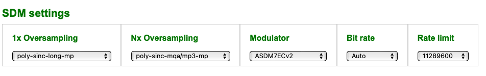

someone mentioned PCM and NS9 being good for more detailed listening and I have to say that this PCM setting with NS9 is about as good as the DSD256 settings I’m using. (using M1 Pro MBP) Interesting because the manual says that NS9 was specifically for 4x rates, but it’s a champ at 16x as far as I can tell. Also, nice that PCM uses 1/10th the processing compared to the DSD256. One very strange thing is when using DSD and waiting for a song to load, about 3 seconds before I can hear some faint intermittent clicks. It doesn’t happen with PCD, just DSD… odd
If anyone has some better DSD256 settings good for very layered electro and alternative/indie rock, then I’m open to suggestions :slight_smile:
When you compare PCM and DSD outputs, always use same filters for both.
If your DAC is Holo Audio, set the PCM gain compensation to -6 dB (now you have it set to 0). To compensate for the 6 dB volume difference. Also remember to set DAC Bits to 20.
You can also set PCM rate limit to 768k to avoid output rate dropping to 384k for hires content.
I’m using 1x=poly-sinc-gauss-long and Nx=poly-sinc-gauss-hires-lp
