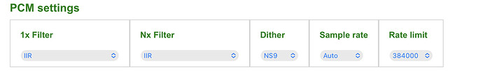

What’s the best HQ filter for DAC dsd256 & meaning of 1 x oversampling & N x sampling?
Current settings SDM
1 x oversampling. Nx sampling
poly-sinc-lp-2 sinc-M

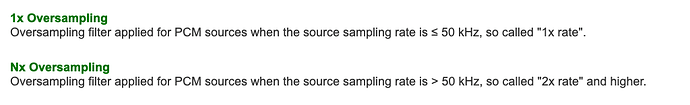

This is in the user manual:

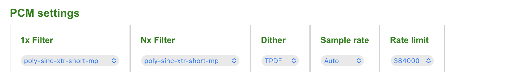

Okay, this is my new fave:
